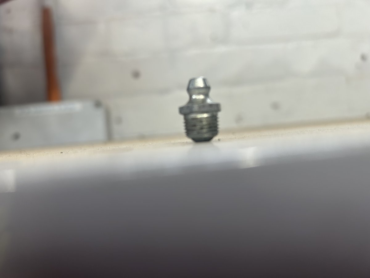

This one look like two cones
Most common is cone outer, spherical inner

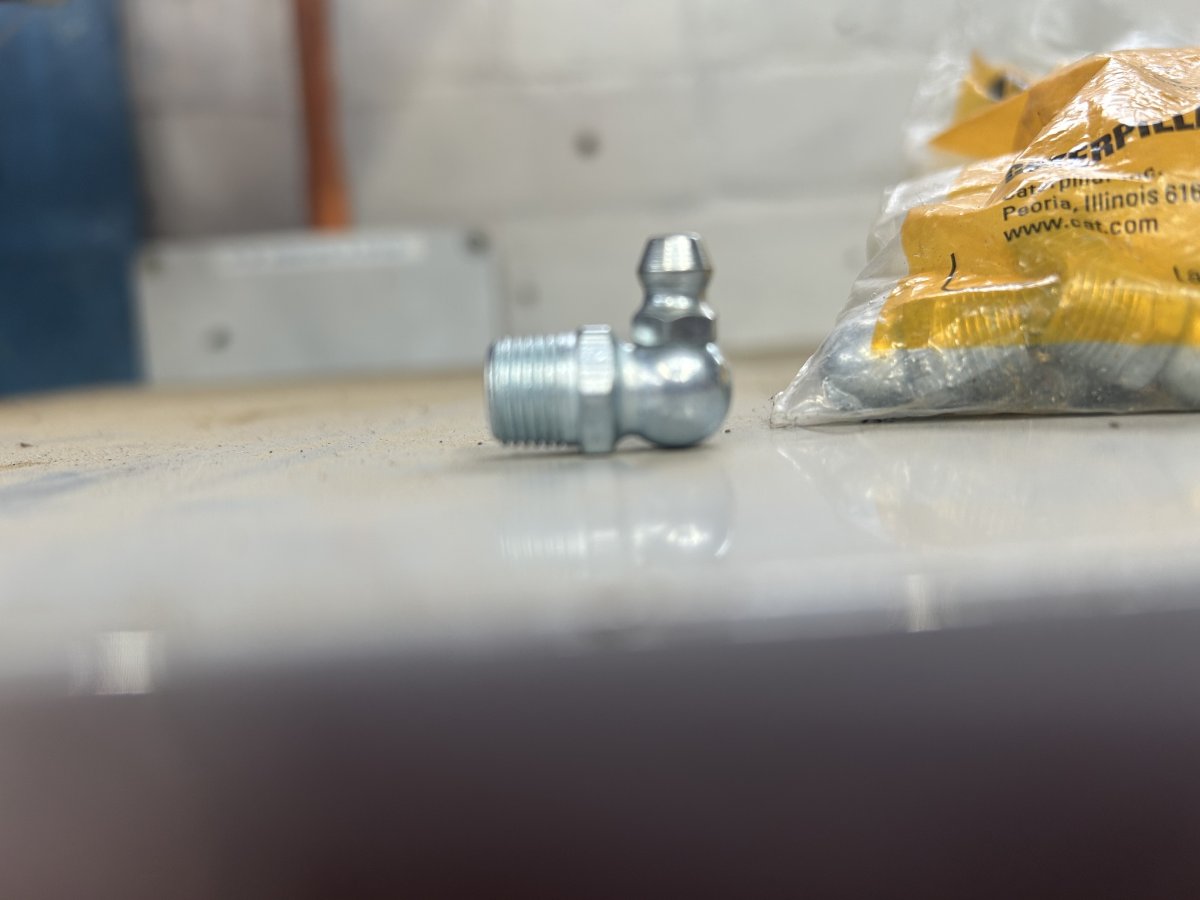

this one from Cat looks more like a barb

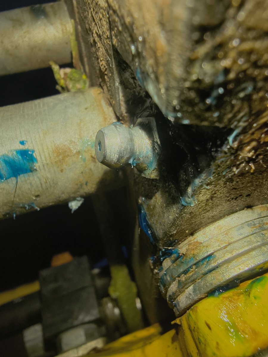

Ah, ok. I hadn't considered that. I'll have a look into that in the morning. I believe the DeWalt coupler is an NPT 1/8" and the grease nipples look similar to your second example but a bit hard to tell in the dark

Can't fault that nipple, looks pristine.

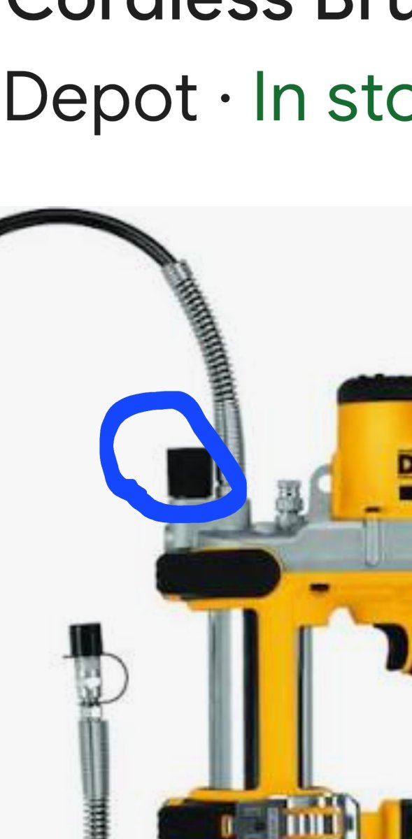

Is coming out the blow off valve? I found some pin and nipples are tight /going great then "fill" or can't keep up with volume and you need to press the trigger 1/2 or sometimes 1/4 of the way, or they'll still take greese just slowly, but that valve is a pain to clean without brake cleaner. The other thing I found with them is never lend it to anyone they'll run it dry and get air into it, there's a nack to changing the cartridges, the moment the plunger touches stop pumping and change it. If air gets in it's a f u#*k of a job to prime, and you'll be wearing a tube of grease
