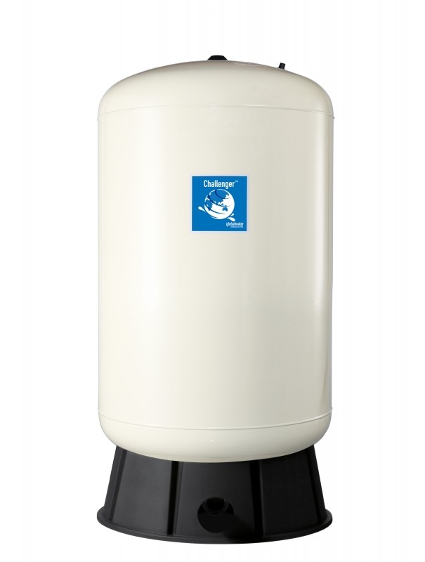

Do any of you plumbers have any experience of pressure/flow boosters? A bloke on site somewhere was talking about a setup with the incoming supply being held in a 700l accumulator tank (I guess pressurised) which then gives a much greater flow at a set pressure (upto 6 or 7 bar istr). I’m considering something along those lines as we struggle to run 2 (or potentially more) decent showers at the same time (no problems with hot water supply etc, the issue is flow). I’d love a pointer to a recommended manufacturer if anyone here has any experience.

If you have good static pressure but poor flow (often the case round here , small pipes over a long distance)…. Then often an accumulator will sort the issue out for you , it just uses a large air filled balloon in a steel case to provide a ‘battery’ for the water pressure to build up when you are not using any, then gives you a reserve to use.
If you have static pressure and low flow rate then you need a store of water and a pump. Lots of ways to skin this cat.
My personal favourite is a PowerTank. They come in all shapes and sizes with variable speed or fixed speed or twin pumps. If it’s going IN the house then get a bunded one . Almost silent in use as they have a submersible pump.
