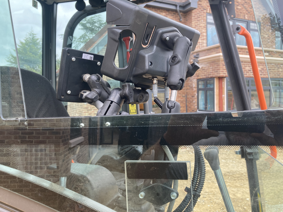

I’m looking to add another mount to stabilise my screen .
This is my new improved position after getting fecked off with the suckers .
It’s much better now but not quite stable enough .
Can you send me info on this Perspex mount and what is between it and the screen that Jerry has so I can do something similar to improve mine ?

I'm not sure how regularly Neil checks in here, you may be better of emailing him, all the bits between the perspex mount and the cradle are RAM mount parts, they have a EBay store if I remember correctly.

Evening all, its a solid piece of polycarbonate with threaded inserts. 3M vhb tape works well, so ling as the correct primer is used, or it peels off the polycarbonate

Evening all, it’s a solid piece of polycarbonate with threaded inserts. 3M vhb tape works well, so ling as the correct primer is used, or it peels off the polycarbonate
Am I right in thinking that the threaded inserts hold the clamp and the vhb tape secures it to the glass ?
Would you recommend this for mine or something else ?
