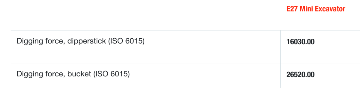

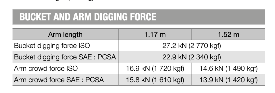

You'd need to look closely at the specs, in particular dig depth and breakout force.
Many of the 'bigger' 2.7 tonnes share the same engine/pump with their bigger brothers- Bobcat E27 and E34 for example. There will be less in it than you think. The Hitatch is 18kw, the same power as an E27. Bugger all difference in bucket breakout- Hitatch 27.2kn, Bobcat 26.5kn. Arm crowd force on Bobcat actually slightly greater than HItatchi. See attached screenshots. You'll gain an extra 284mm of dig depth- do you need this? For me I'd see no reason to incur extra transport costs but I'm not doing your kind of work and rarely dig to full depth with my E27.
If you can do 90% of what you need to do with a 2.7t and move it yourself, I'd get that and hire in a larger machine when needed. Transport on a lorry will soon add up for a larger machine, unless most of your jobs are for long periods of time in one place. If you do small private 1 or 2 day jobs, the lorry transport will make you uncompetetive before you start. I'll often do two days with a 2.7t rather than 1 day with my 9t as lorry transport costs me £300 plus vat for a short round trip locally.
I'd be looking at what size machines your competitors are using. Do they all run larger machines despite the cost of a lorry?
And push Bobcat harder on price. Tell them you can get the Hitatchi for 43k, so what will they do you on the equivalent E34?
Hitatchi are nice machines, and run high hours well. Just a bit basic for me- no option for second aux lines on the left joystick on a 2.7t rules them out for me.
