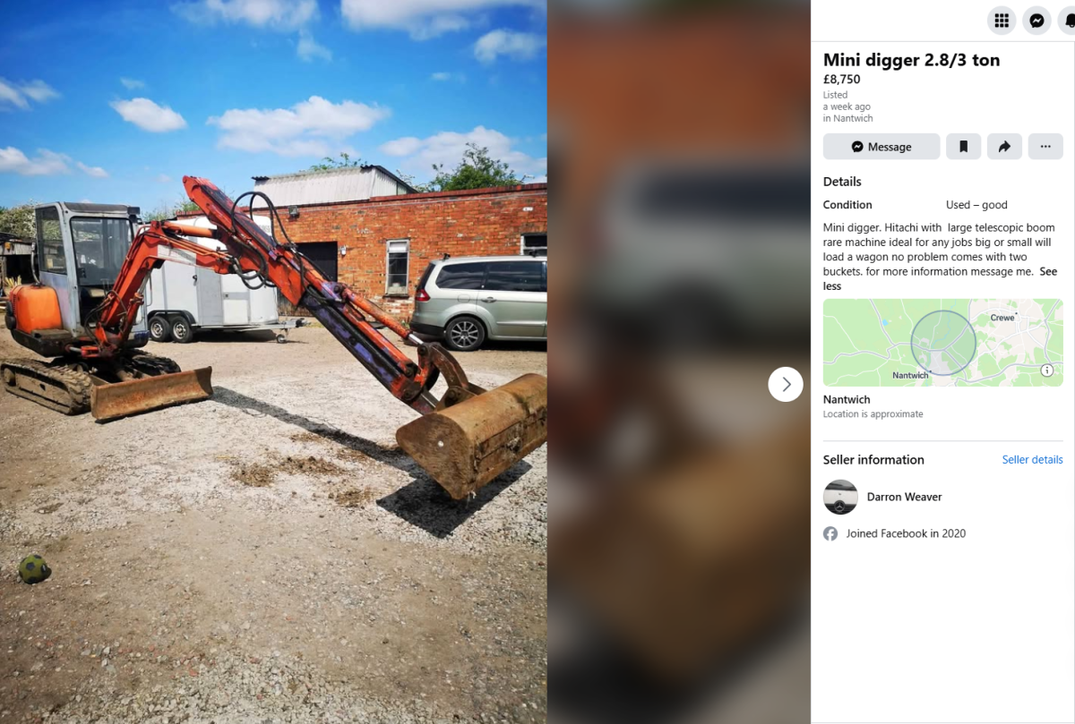

I think you'll find a 1.5 ton to small for what you want to do. For lake maintenance you will be at full reach, and stability will be an issue, especially with a grading bucket full of heavy wet slop.
Definitely be thinking 3 or 4 ton machine.. in fact that machine with the extending dipper would be a great machine for that job.
