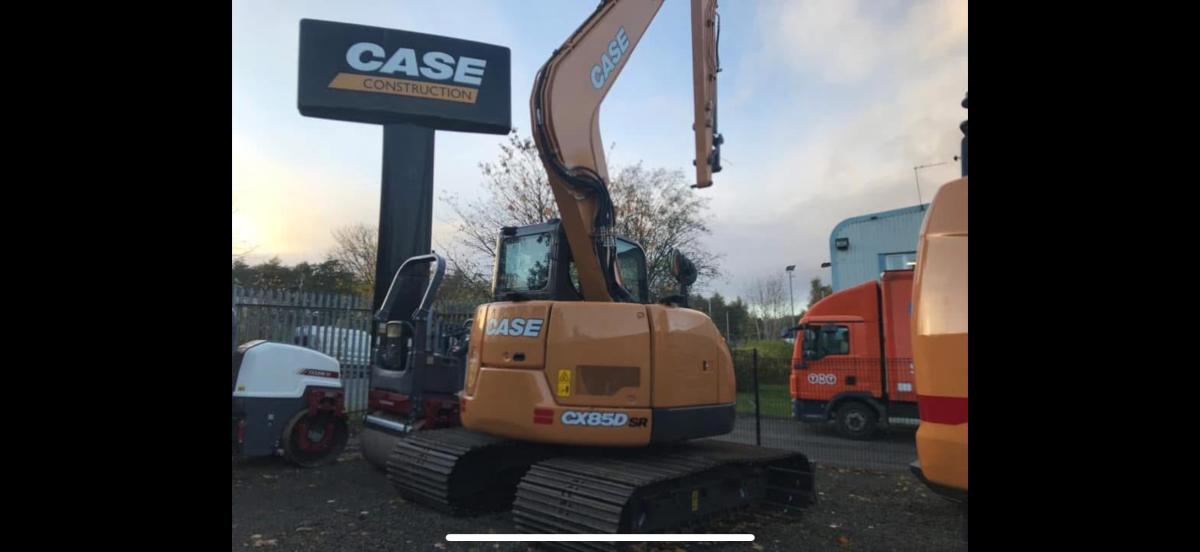

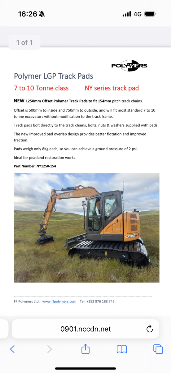

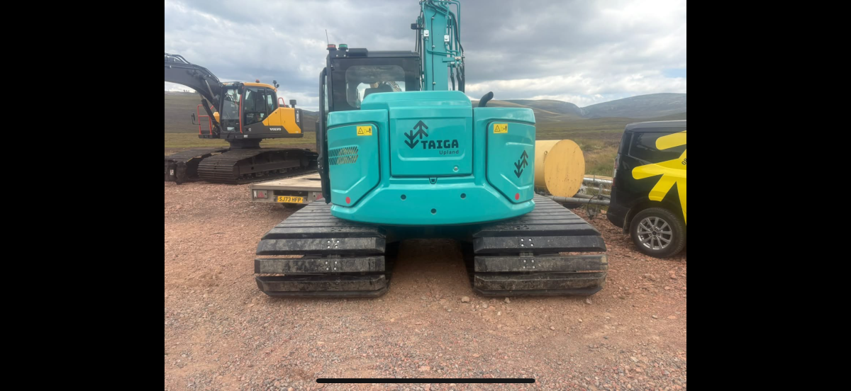

What are people’s experiences/ preferences with track choice? Polymer vs steel for example
900/1m steel offset pads on a 8t
Where as people seem to go up to a 1200mm offset with polymer? They look like they should be better with the rounded edges and all but no experience myself?
Few pics of examples

I know the flaws of Steel tracks, polymer makes sense to the fact it solves them…but never used them? How are the in the real world? Is the extra offset ok? Does it mean you can go nearly anywhere without mats?
