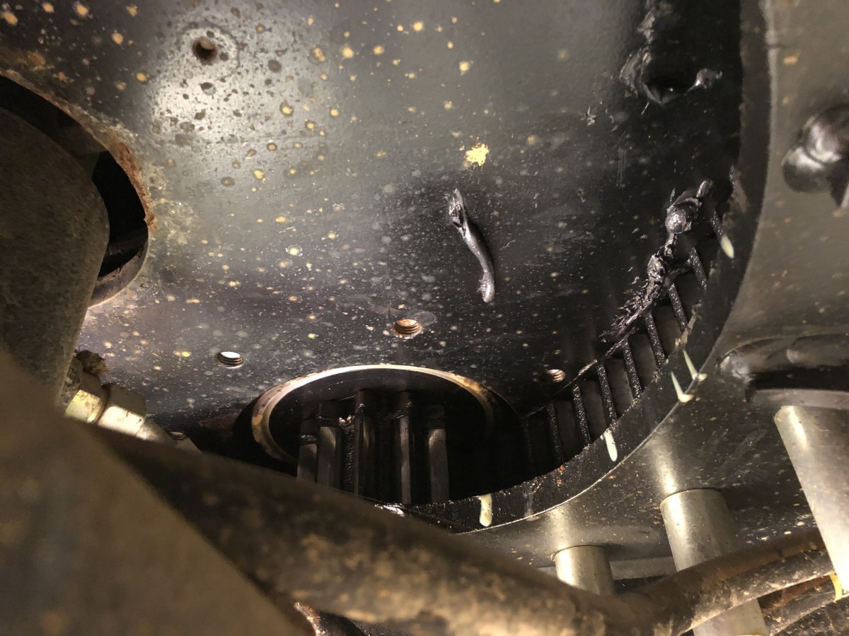

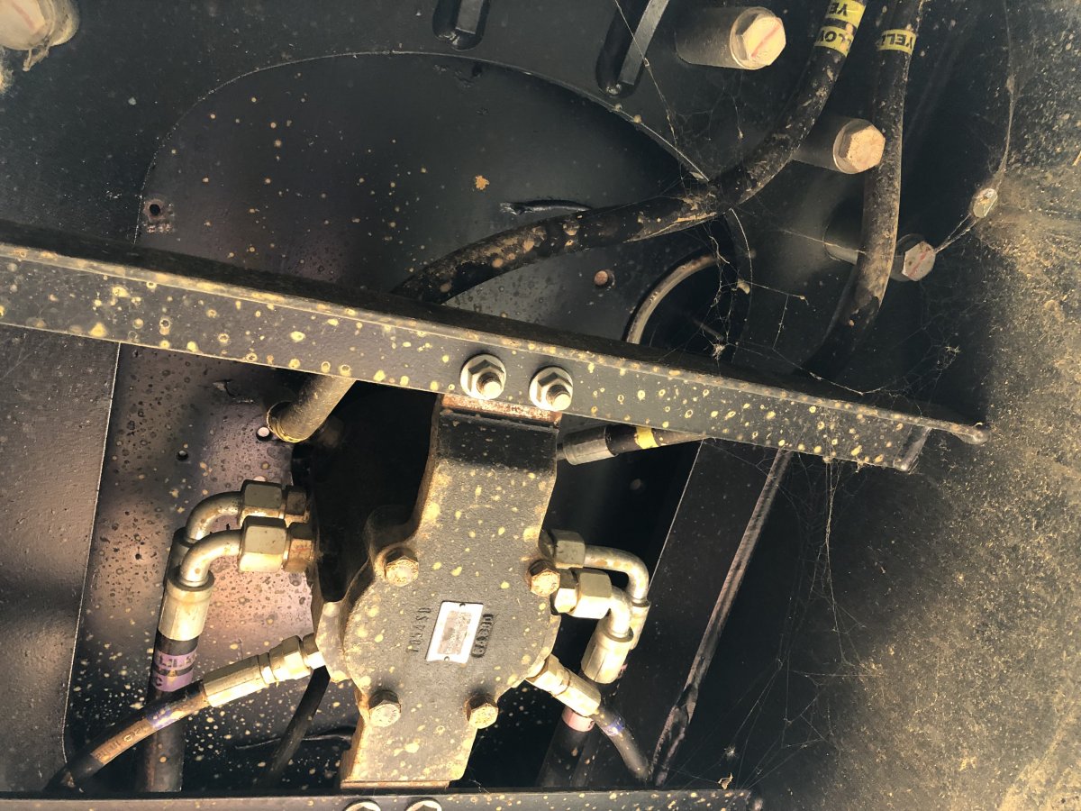

Hi. I need help with an old jcb 801.4.

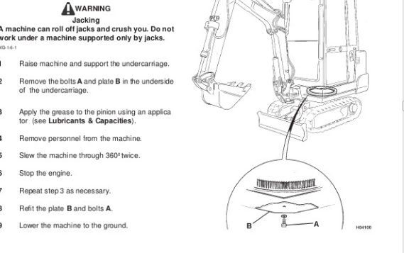

As you can see in the attached file, I tried to remove the lower cover, from the ground without lifting on the lift, but I didn't find any attachment to grease. Who helps me?
Thanks

There is no grease nipple, the grease is to be applied directly to the pinion and slew gear teeth by using a spatula tool or your hand. It’s a messy job which people tend to overlook for this reason.
Put the machine on suitable blocks to make access easier, you will need to get your arm inside the frame and be able to see what you are doing, so you need to get the machine off the ground, potentially higher one end will help.
I’m doing this job myself today, but on a bigger machine.
Good luck and stay safe.

Thanks Shovelhands. I think I will do the awkward work from below, I cannot guarantee my safety by raising the car roughly. I will use mirrors and a lot of patience. Thanks you were very fast and accurate.

Thanks you are very kind, precise and fast, I was sure that this forum was perfect for my needs. The images correspond to my situation. The small 801.4 has very small dimensions and little intervention space. But yesterday I managed to insert healthy fat.
