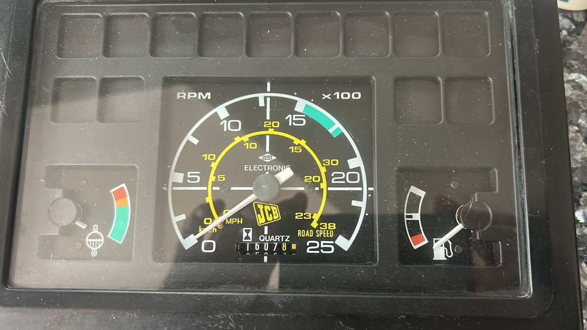

Hi 👋
I’m currently restoring a H redg Gray cab turbo+ JCB 3cx. I’m wondering if anyone would know who made the dashboard as I need to replace the Fule and temperature gauges. I’m guessing it would be Smith’s??
Any help with locating dials or second hand bits would be greatly appreciated.

would be a complete dash I'd've thought ...
H reg as in '90/'91 YOM ??

you could try vicary plant spares not sure if you could get new i suspect it would be the whole unit not separate bits of it, or there is francis charles in ireland. way back in 1991/2 i drove a p7 turbo plus a really great machine for that era. julian carder restored the same model not long ago he may know a source for parts the dashboard was the same on all p7 machines i think.

Stupid question do the gauges not work ? It could just be the tank sender that needs replacing and the thermostat or temp sensor, from my experience on project 6, 7 and project 8 it has usually been the problem. If it is't maybe you can carefully get the gauge binnacle apart its likely to be a pcb dry joint or capacitor on the board.
