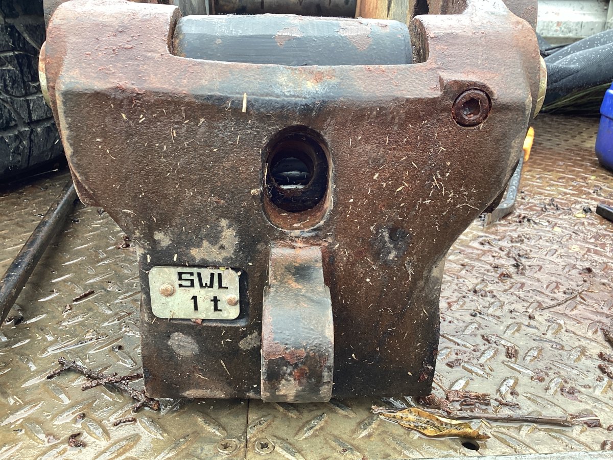

Hi guys,i am located in the West Midlands and looking for a company that repairs or refurbs worn manual quick hitches as mine has excessive wear in the jaws and locking plate pivot points ,any suggestions ? Thanks in advance (Dave)
Hi Dave, not sure about your area, but a good machine shop would be worth asking as they likely could. One point to make is you may pick up a manual hitch as cheap as a repair would cost!

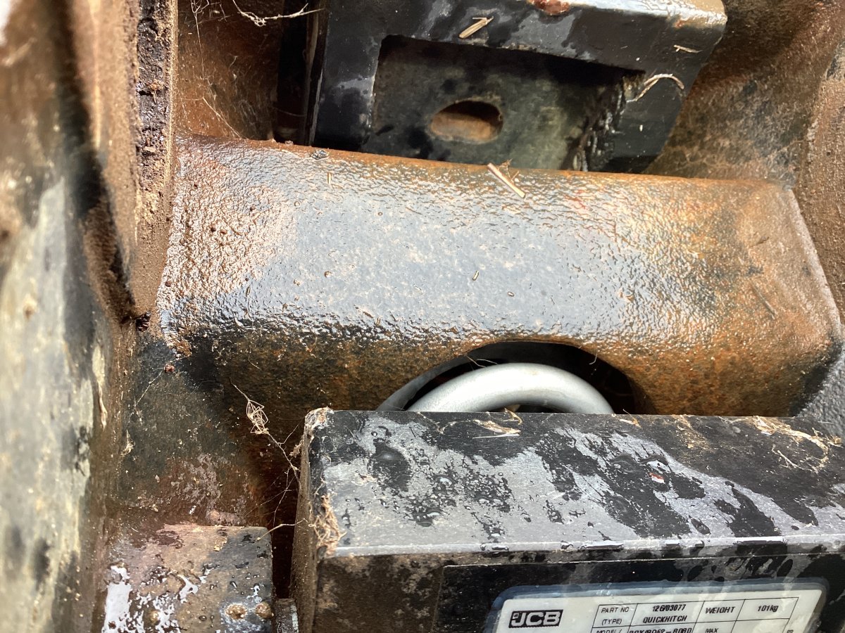

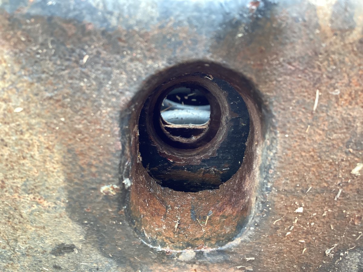

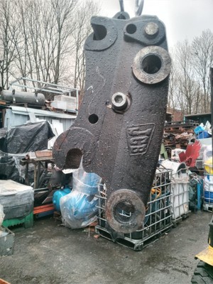

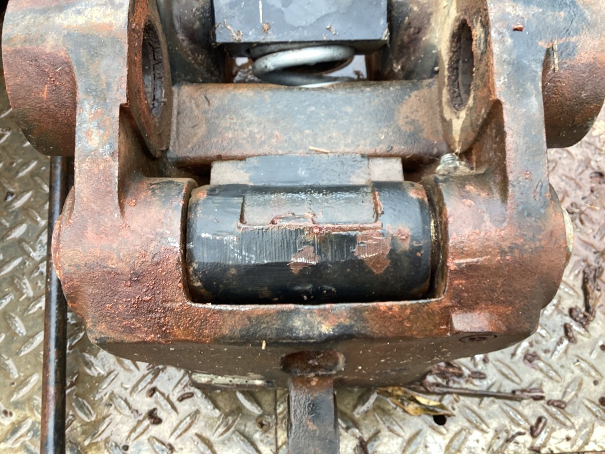

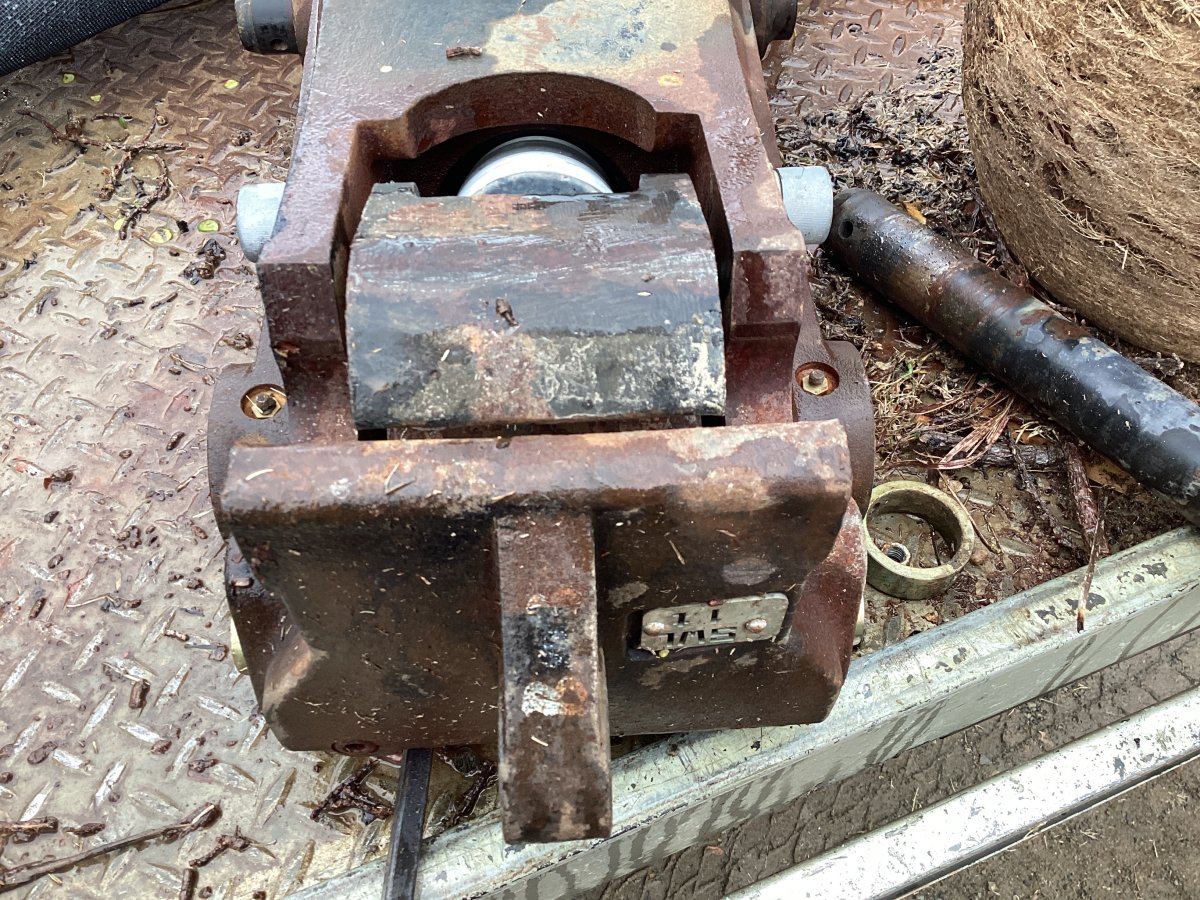

Is it as bad as this one ive been on.
Might struggle reworking it, if its a genuine 3cx hitch, as they where cast iirc :unsure:
cast steel though Craig .... very weld-able :giggle:

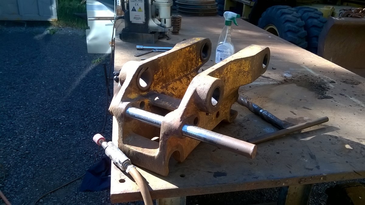

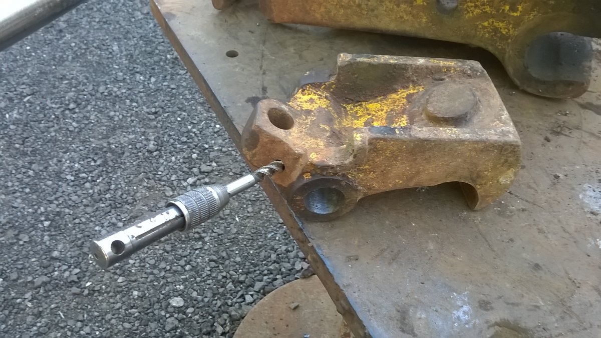

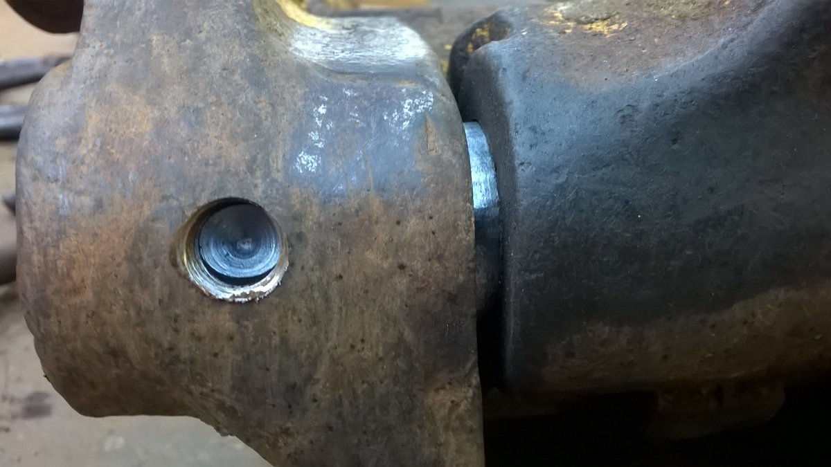

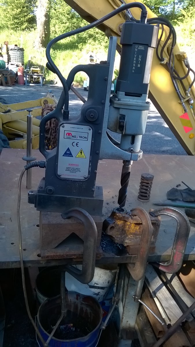

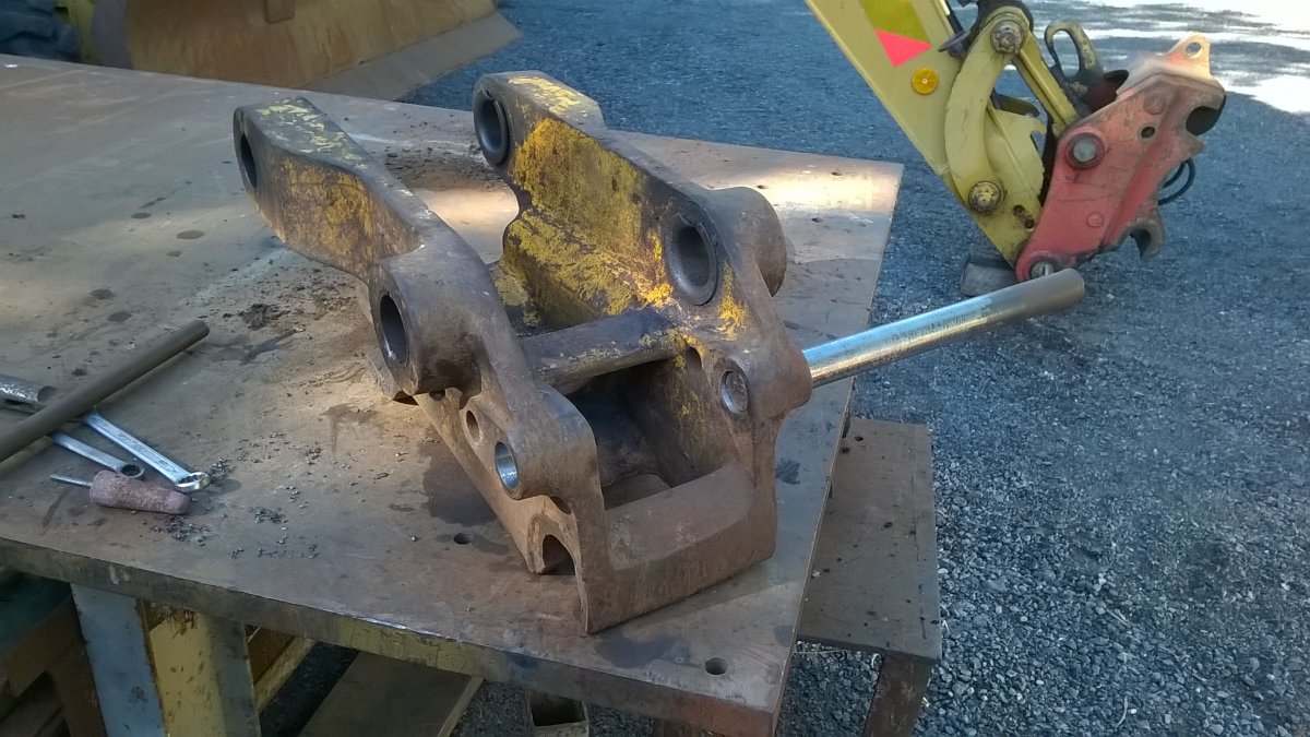

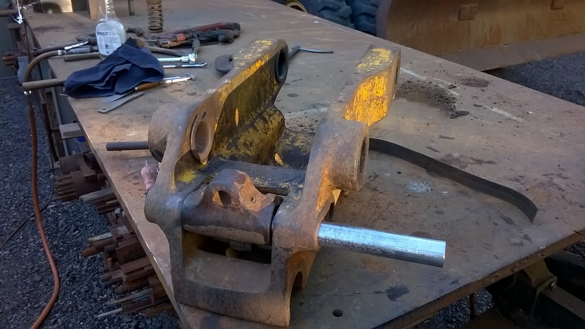

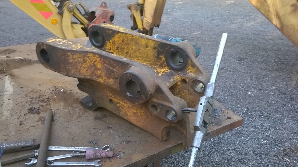

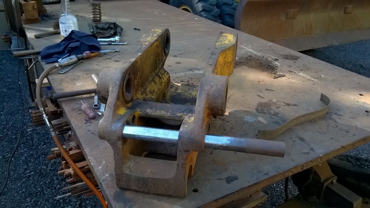

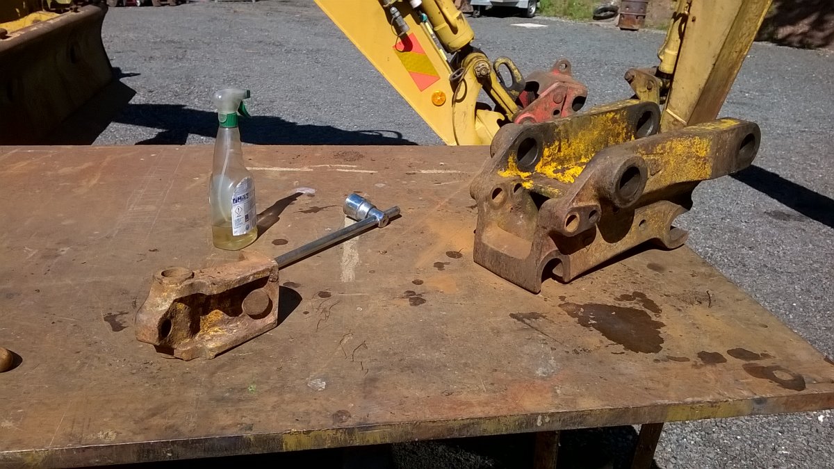

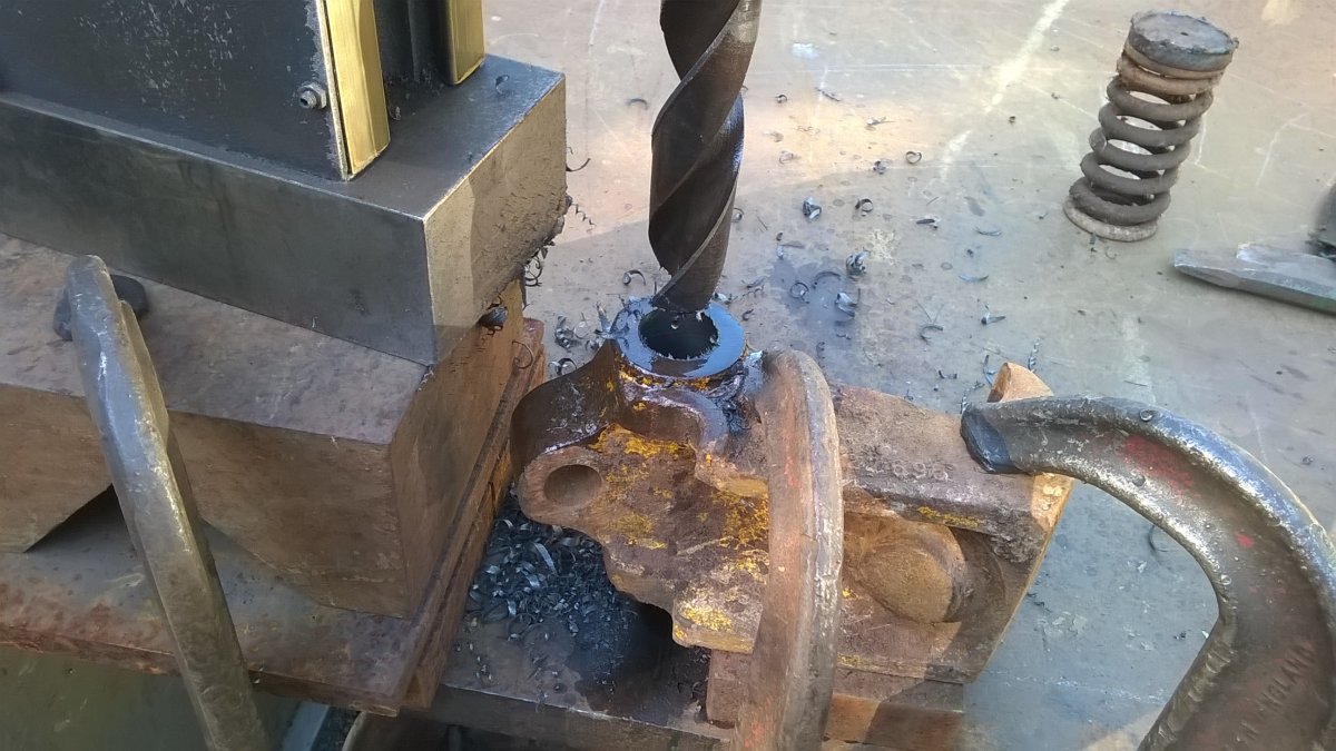

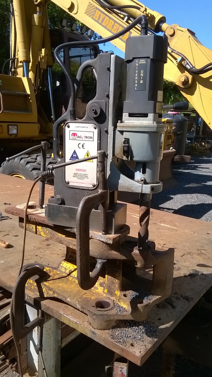

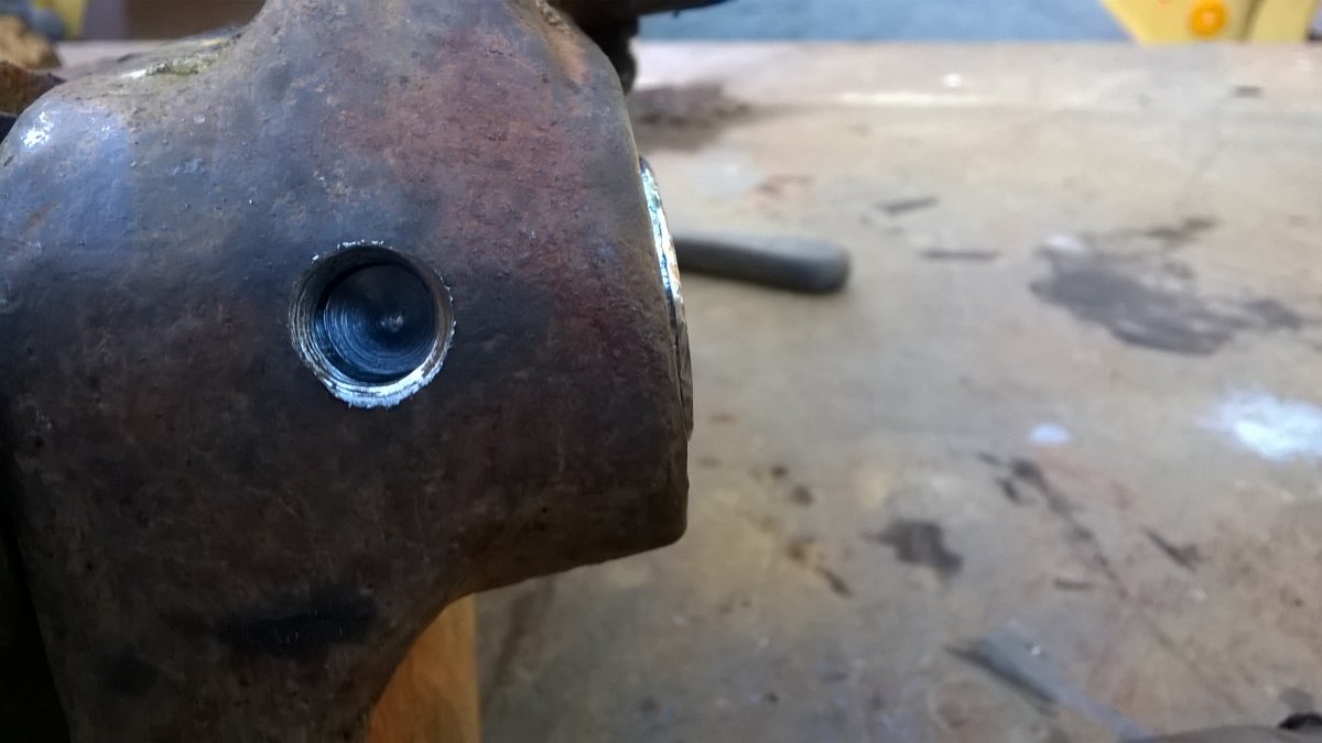

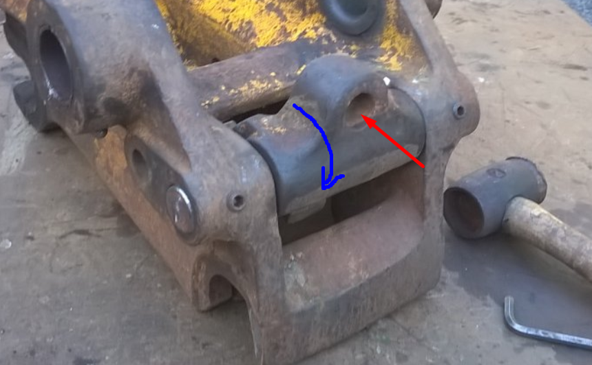

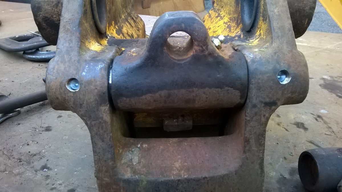

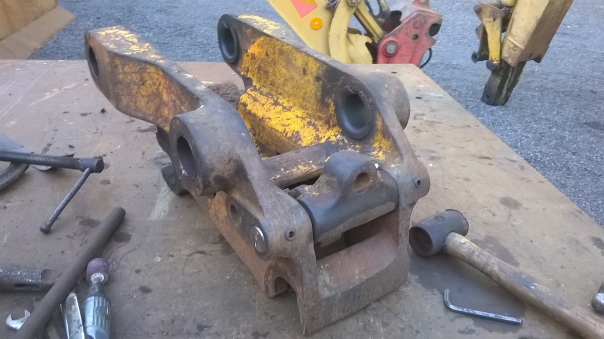

I took a a massive amount of slop out of the one on JakieB 'fore I sold it ..
pivot bored out to a more sensible 32mm and fresh pin fitted, grub screwed and grease nipple fitted, together with a packer behind the spring to take all the play out ... gripped like a lobster afterwards ... had I been keeping it I'd have given the hook jaw some attention with the hot stick/MIG too, to lose the wear in that ;) plus it got a new set of spring bushes and pins (y) ... made a massive difference to the bucket's stability
WP_20210615_15_55_51_Pro.jpgWP_20210615_16_31_30_Pro.jpgWP_20210615_17_40_30_Pro.jpgWP_20210615_18_05_04_Pro.jpgWP_20210615_18_05_08_Pro.jpgWP_20210615_18_05_15_Pro.jpgWP_20210615_18_05_38_Pro.jpgWP_20210615_18_54_13_Pro.jpgWP_20210615_19_05_01_Pro.jpgWP_20210615_19_23_43_Pro.jpgWP_20210615_19_49_59_Pro.jpgWP_20210615_19_50_10_Pro.jpgWP_20210615_19_50_15_Pro.jpg
took a 3 ft bar to get it to let go afterwards and a bloody good flick to latch it
