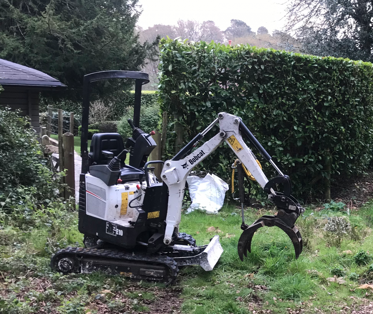

If you're considering it for a micro then a grapple is the best option. Much less weight and just as importantly, less stack height. I have a hydraulic back brace on mine which makes it very versatile. Not quite as versatile as a hydraulic grab, but then I have a real one of those too, with a rotator :ROFLMAO:
Although I can run my grab with rotator on the E19, I only tend to do so for scrub clearance. For wrestling heavy s**t about a hydraulic backstay on a grapple takes some beating. It lets you bring the centre of the load right back under the boom, and also load into higher vehicles than you could with a grab.
It's also much more solid carrying a heavy load, as it's braced (literally) against the boom. Can you imagine the pressure on @Storrsy 's tip links with the grab holding the rock like that and tracking??

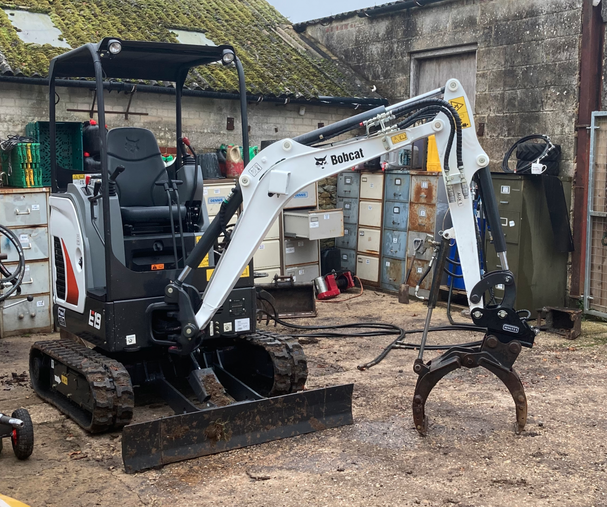

Did you add the ram yourself?
had a hydraulic thumb on 5 ton but took it off annoyed me on tight trenching and was adding 300kg on end etc
Yeah, you'll have to add the ram yourself. Attachment points both ends (grapple and boom) are pretty critical, be prepared to modify. But so worth it, even if it takes you a day in the workshop.
The other thing I added for the 1.9t is a pressure relief valve so that the ram can't overcome the bucket cyclinder. With the micro the stay cylinder is small enough that this isn't an issue (I have a ram for each machine)

Yeah I think the fixed grabs will hold up to abuse better for sure- the articulation and associated leverage applied by the hydraulic grab probably does stress the machine in ways it’s not designed to take, like my rock picture. But then using a bucket to lever out stumps and rocks would exceed those stresses I’d have thought.
The hydraulic ram on yours is quite a neat addition, but then by the time you’ve bought the grab, ram,hoses and a day mucking around in the workshop modifying it your probably not far off the price of a hydraulic grab which personally I find superior- even if perhaps it won’t last as long, time will tell i guess. I’ve already managed to wear the hardox plates down pretty rapidly 🤔 but that’s 4 weeks constant use handling granite boulders and using the plates to scrape out the footings for the wall I’m doing- off bedrock.
