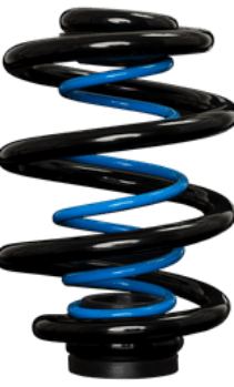

The air assist springs are really good on vans so should be good on pickups
That way you don't have to have a rock solid ride when empty
