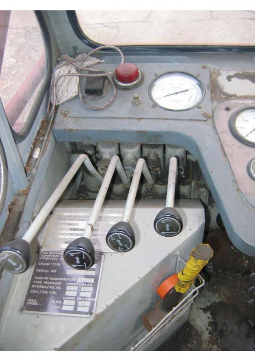

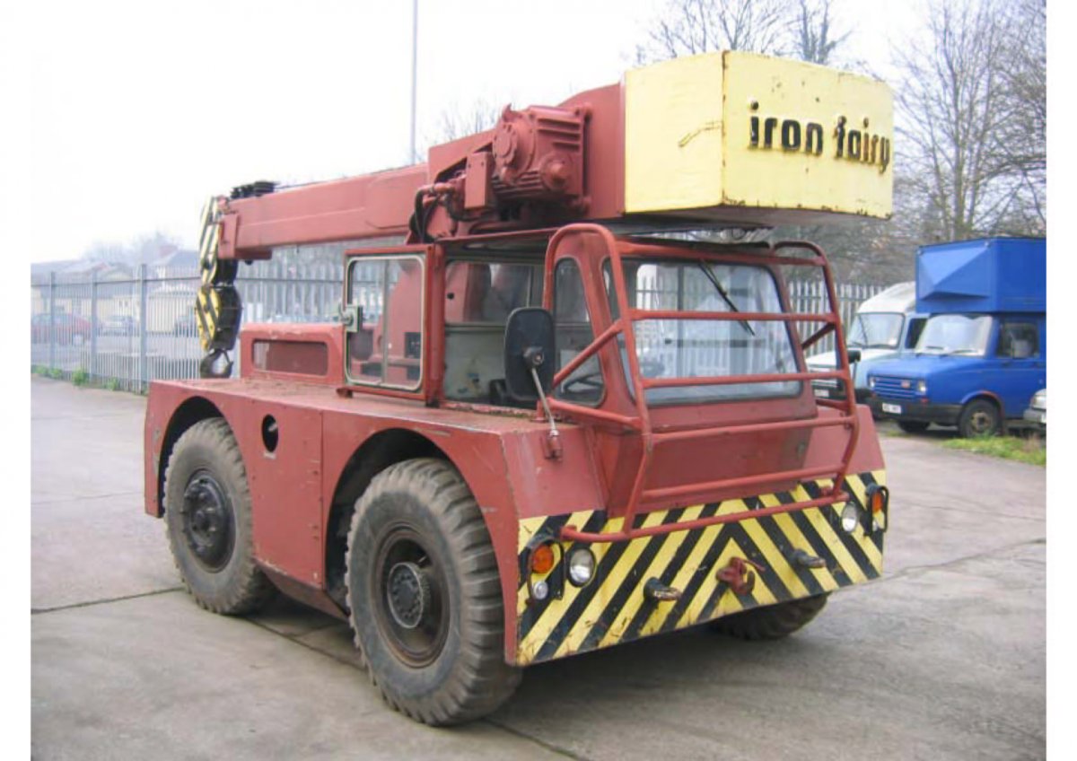

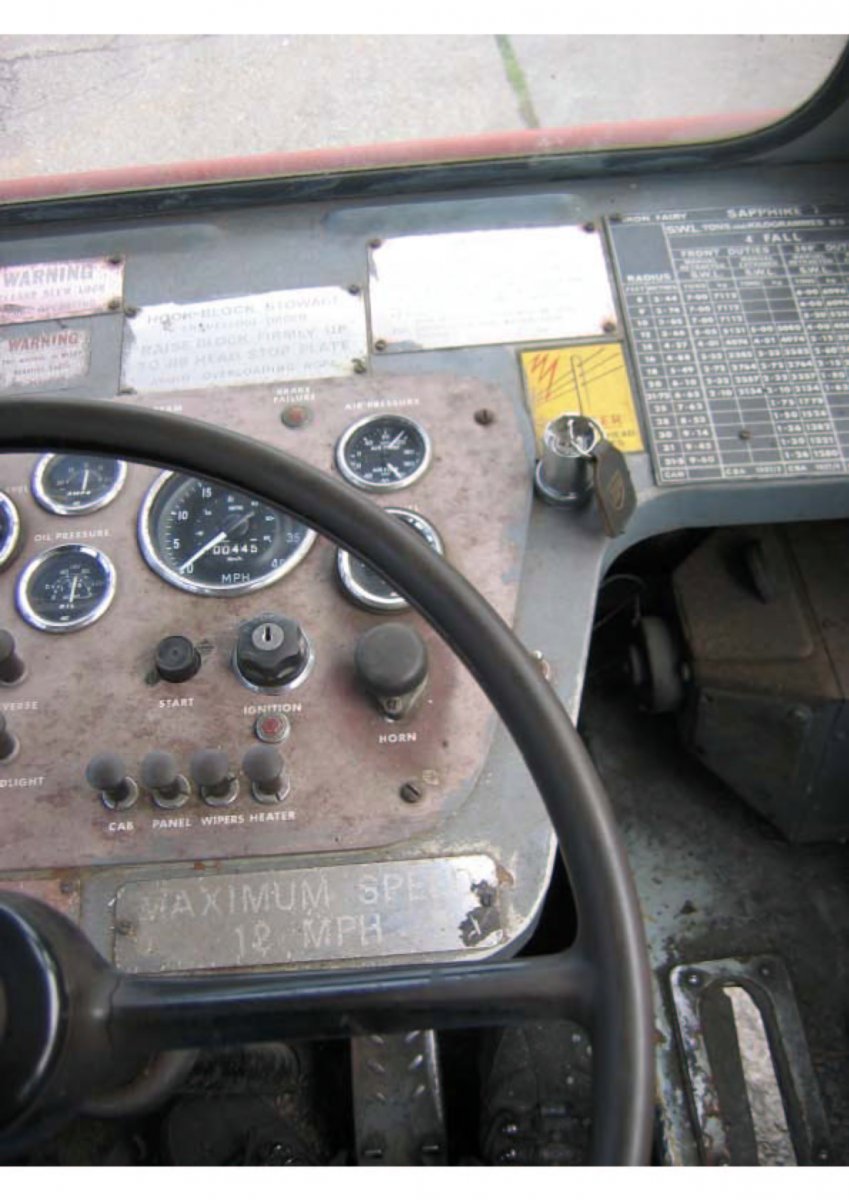

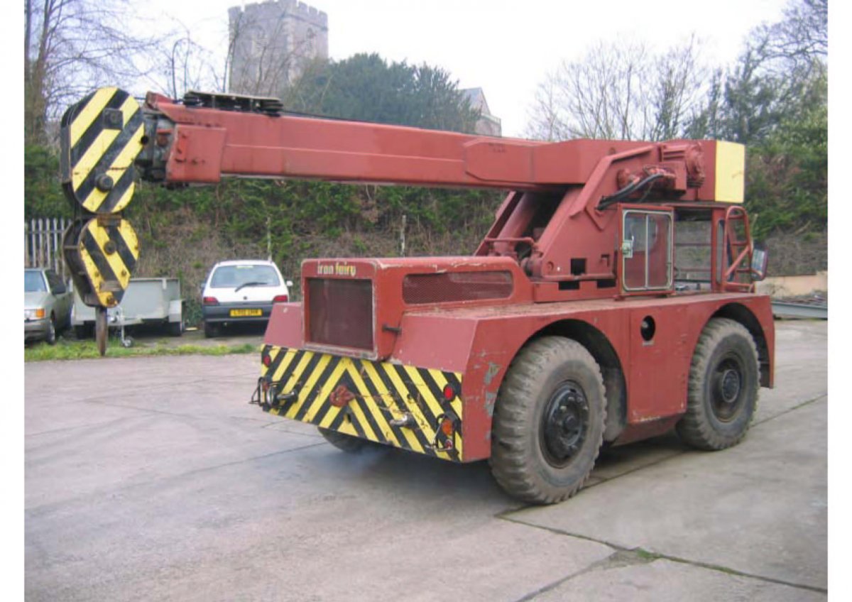

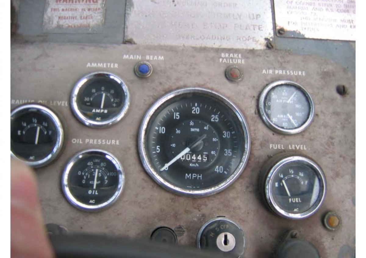

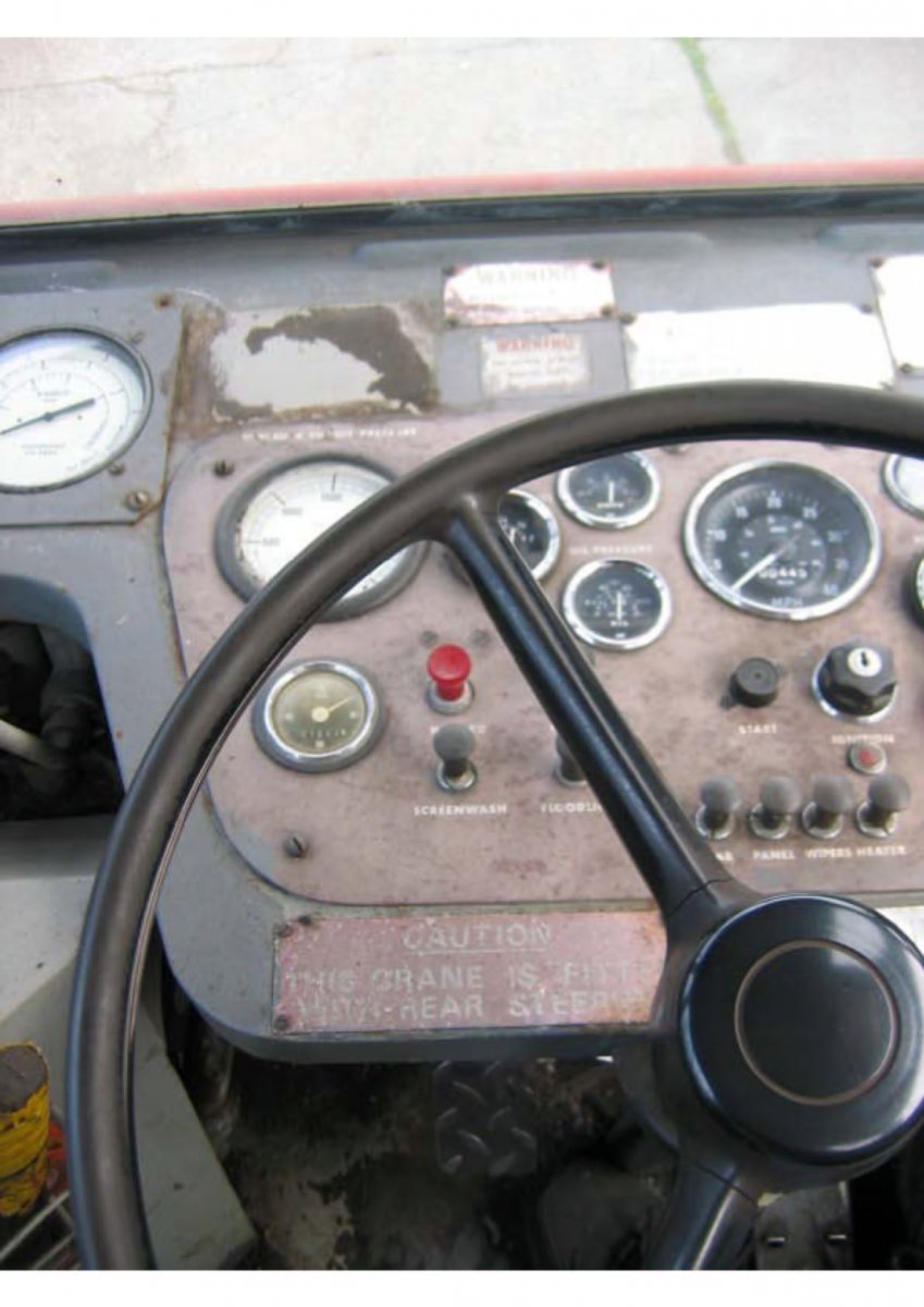

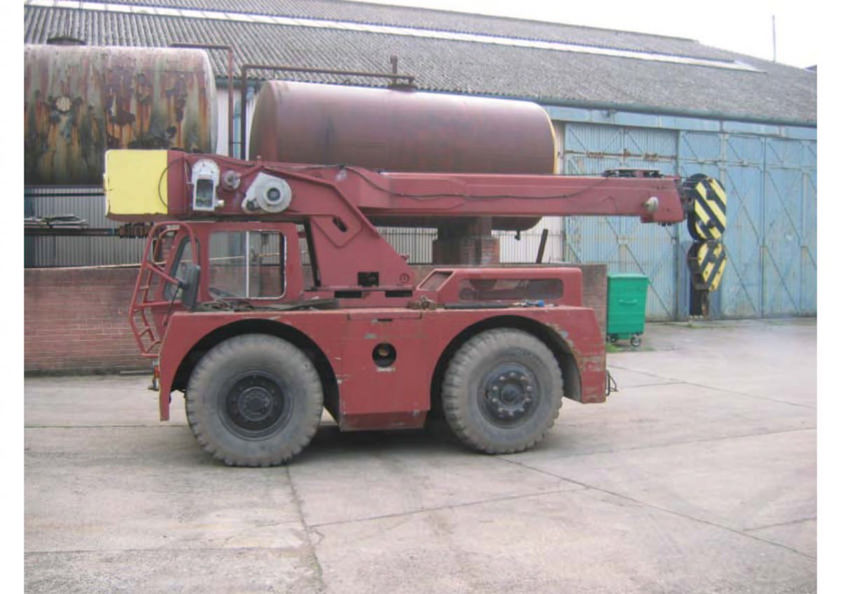

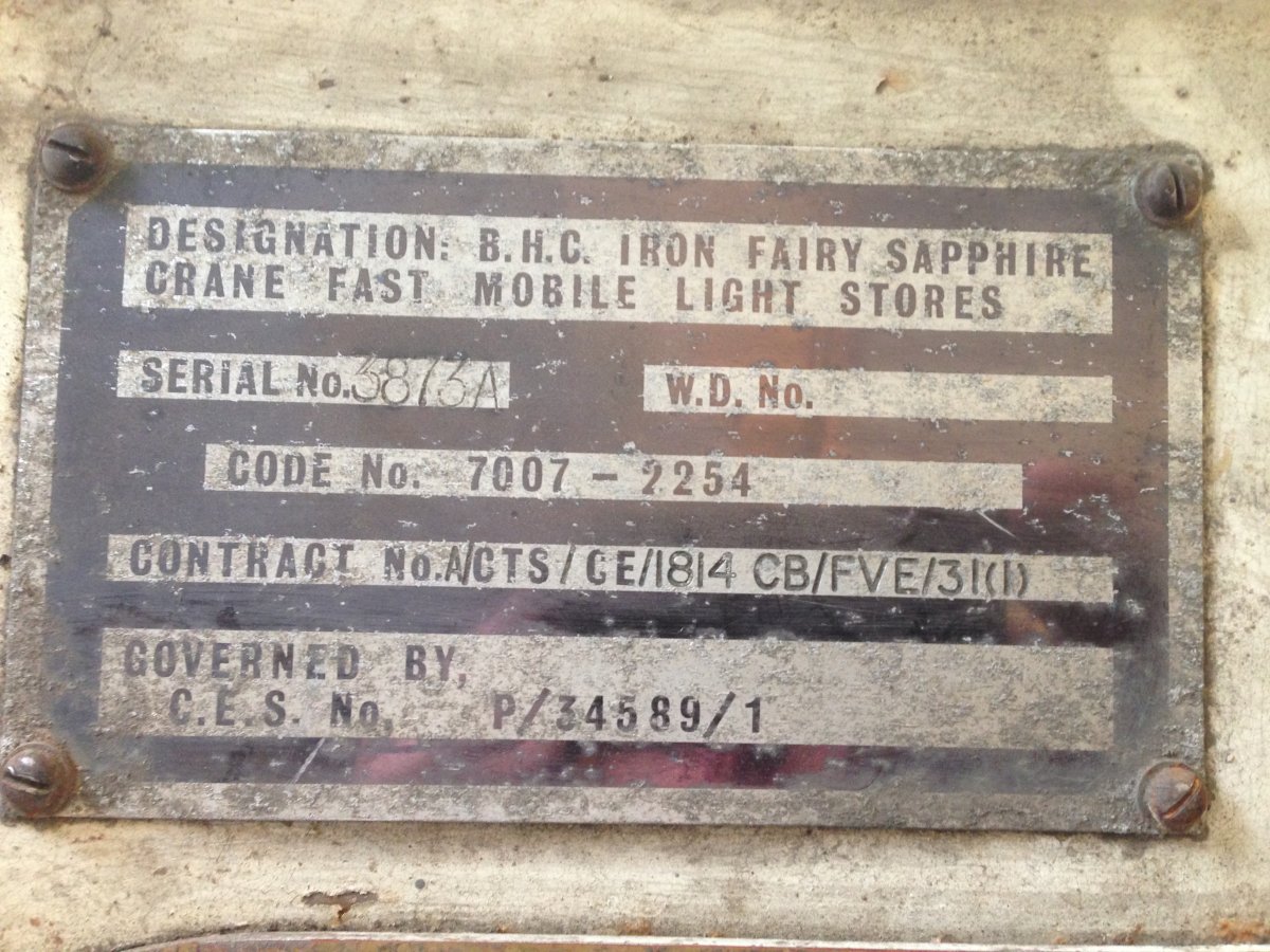

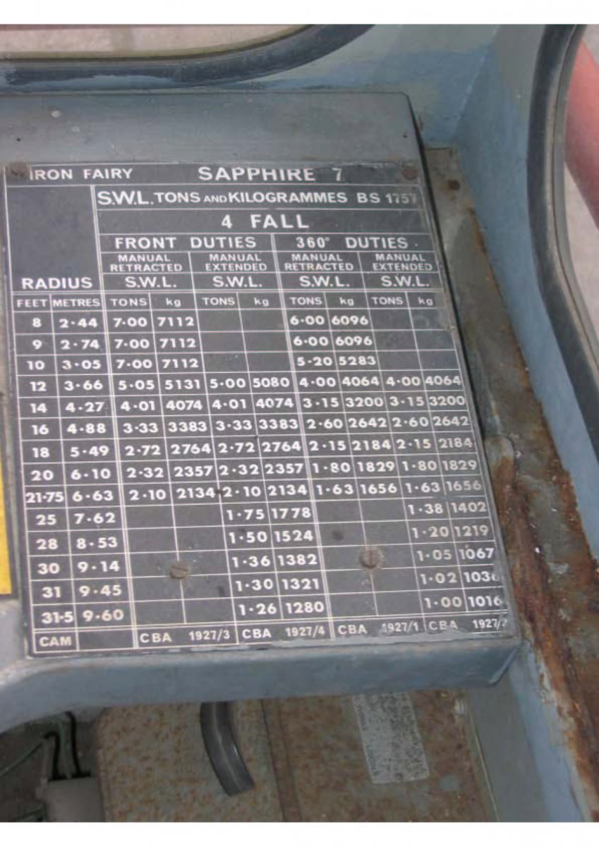

a lot of compressors these days seem to have the pressure cut out switch set around the 100-120 psi :unsure: ..... new one I bought a while back was:confused: ... so ... cover off the pressure switch and adjusted suitably, cured the problem (y) .... the tank was tested for 150psi SWP, so no issues. :cool:

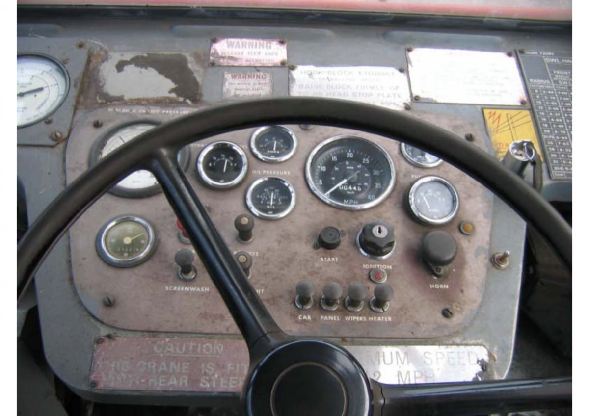

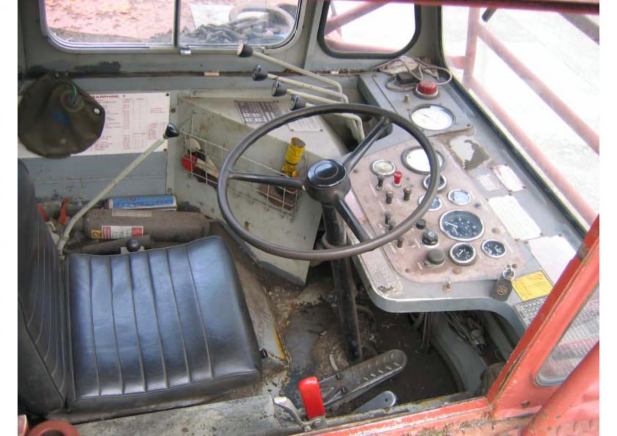

my Sapphire 7 Charlie .......:giggle:

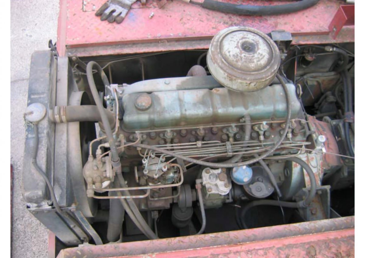

Perky 6354, 5 sp box (rare as!!), :whistle:
1200 hrs and about 400 kilks .... ex ministry then bought by a big pharmaceutical co. locally and never left their site ... 'til I bought it .... did one lift a month, had never been road registered and 'garaged' its entire life --- was a peach ;)(y)
only came out when I needed to use it, or it was in the way :rolleyes:

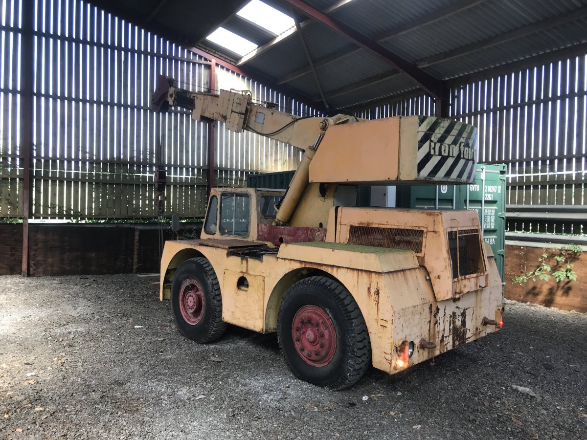

Awesome @V8Druid , looks in better nick than mine at the moment. Clutch went on it's last job but managed to roll it down the slope on the yard into a shed and thats where it has stood for a year, so thats the first job. Believe mine was Ex military and then to BAE. Will get some pics of it when I have a chance but did find the MOD Plate. Does yours have a WYLIE?
Hmm ... that looks an old girl @Charlie - steel bonnet isn't it? .... could be an 8 tonner? - it has the wing top weights on it! :unsure:
what does your load chart say about capacities:confused:
what you have on there, Wylie-wise, is a horrible contraption .... presume you have a safe load and an overload light with little else ?? no load indicator as such, to tell you what is on the hook? .... same as my Rapier had ..... :rolleyes:
OK once you know your way around them, but a pig to keep in calibration and working smoothly .... everything has to work/move perfectly in 'em and has some very fragile components in it .... it does however work very well with a searcher hook, if it has luffing cylinder load sensing, which is how those usually work

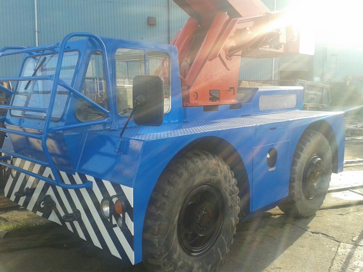

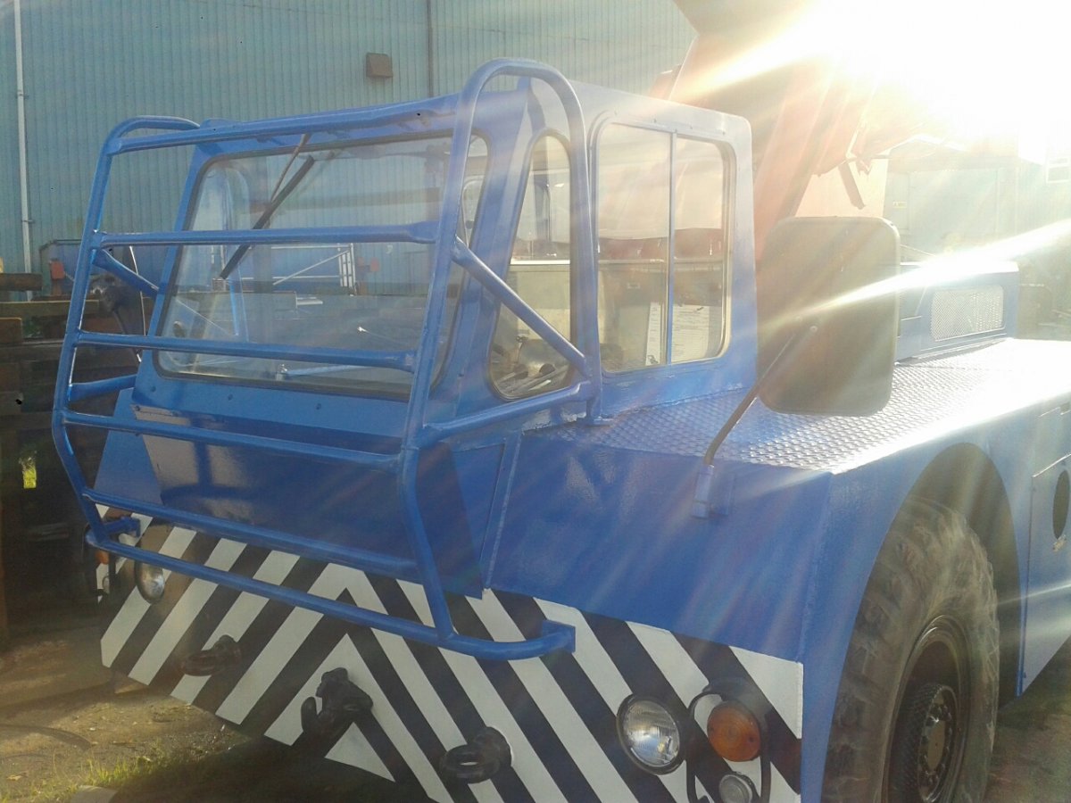

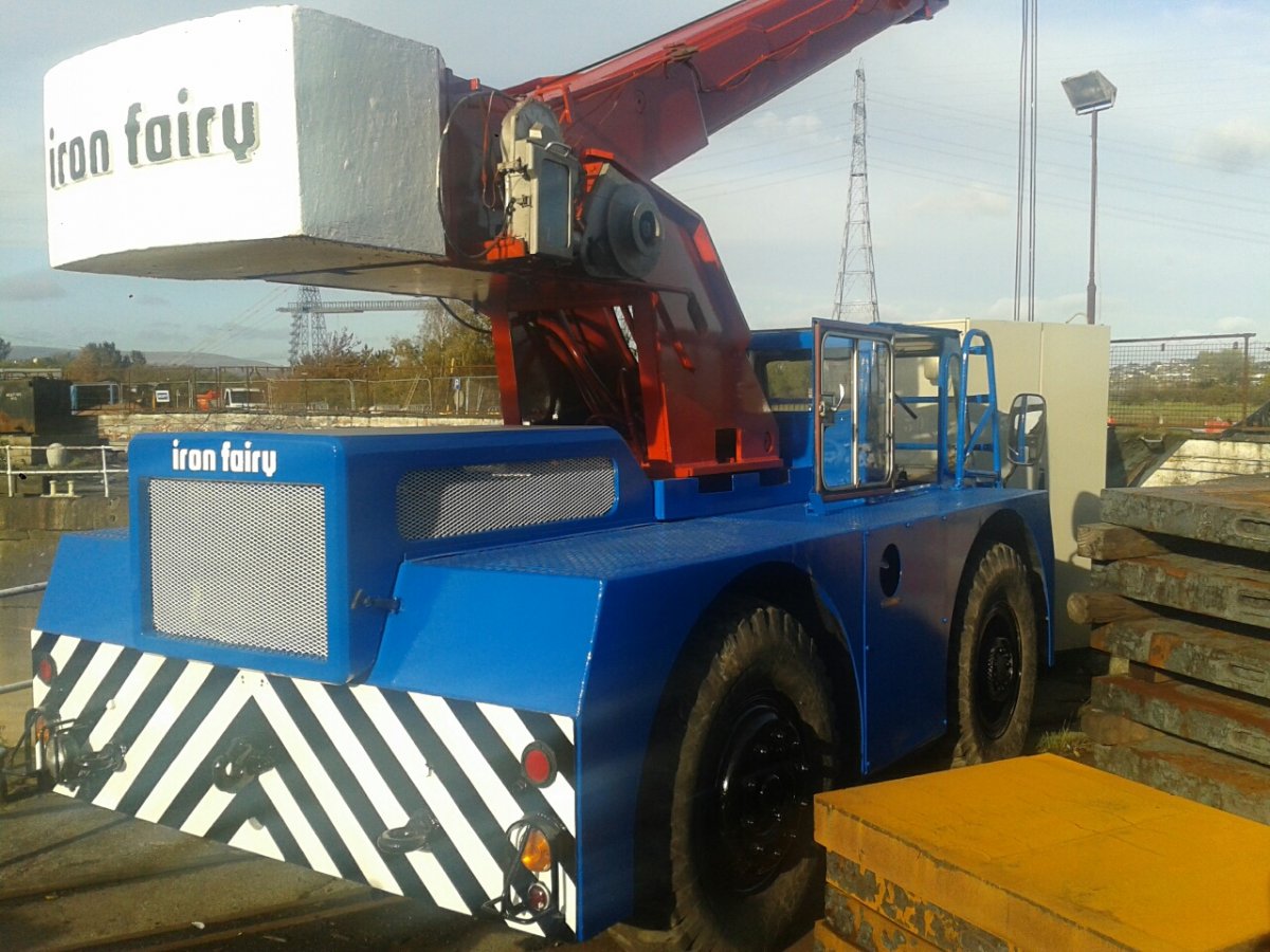

found some pix earlier that the guy I sold it to sent me after he'd had it 'titivated' with some shiny tish ...... can't say i'm fussed on the colour scheme though
red oxide always looks like red oxide :rolleyes: looks a lot tidier though .... could never find the time to do it myself ... and I've painted a few cranes in me time :giggle:

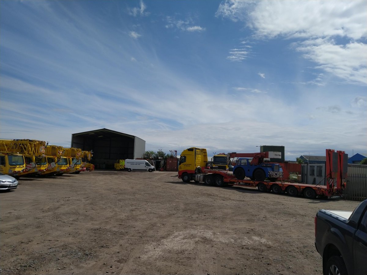

Hi there, I think we just bought you're old Sapphire 7 from Barry Dock - see attached, is this yours?
Do you have any manuals etc?? Works like a dream!

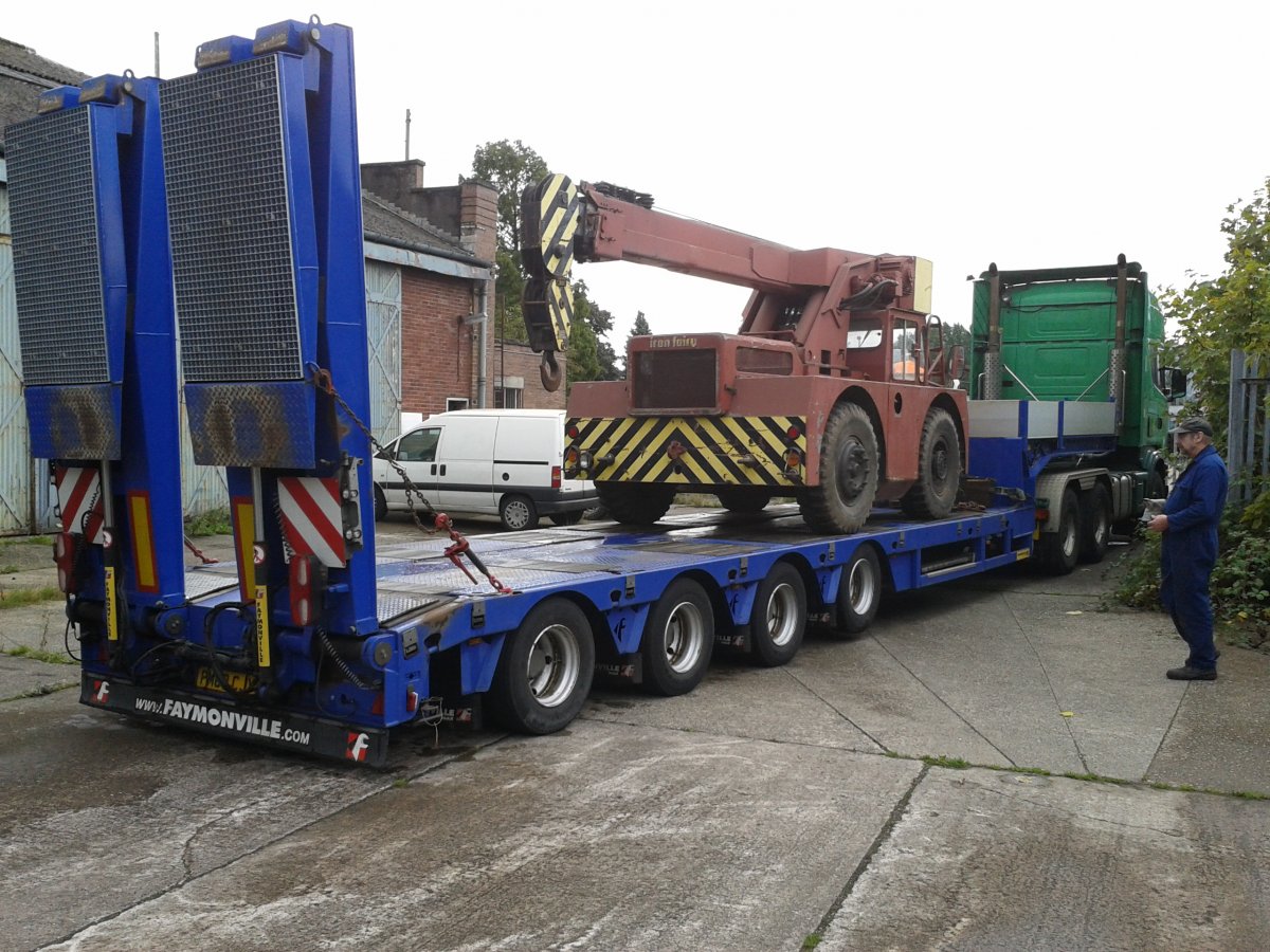

leaving my yard on Jeff Laidlaw's truck for Zooport Oct. '13 .....
