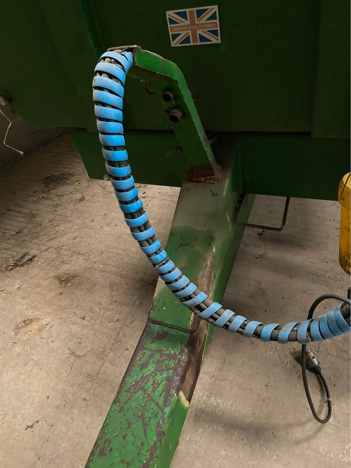

" Heavy duty pipe wrap
£3 · In stock Listed in Leominster, England
Condition New
Keep your pipes out of harms way with heavy duty pipe wrap made out of water pipe. Only comes in blue £3 a meter + postage "

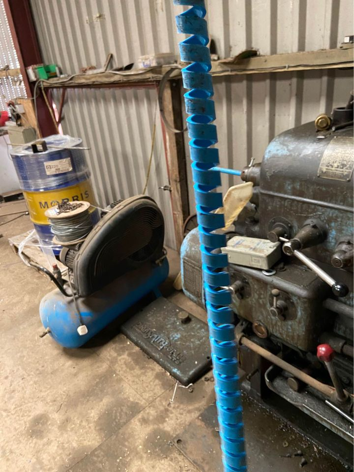

enterprising use of an old D,S&G
wonder HTF he keeps it straight and grips it tight enough to slit it ... collet chuck 'praps ???
Doing it in a lathe seems slow

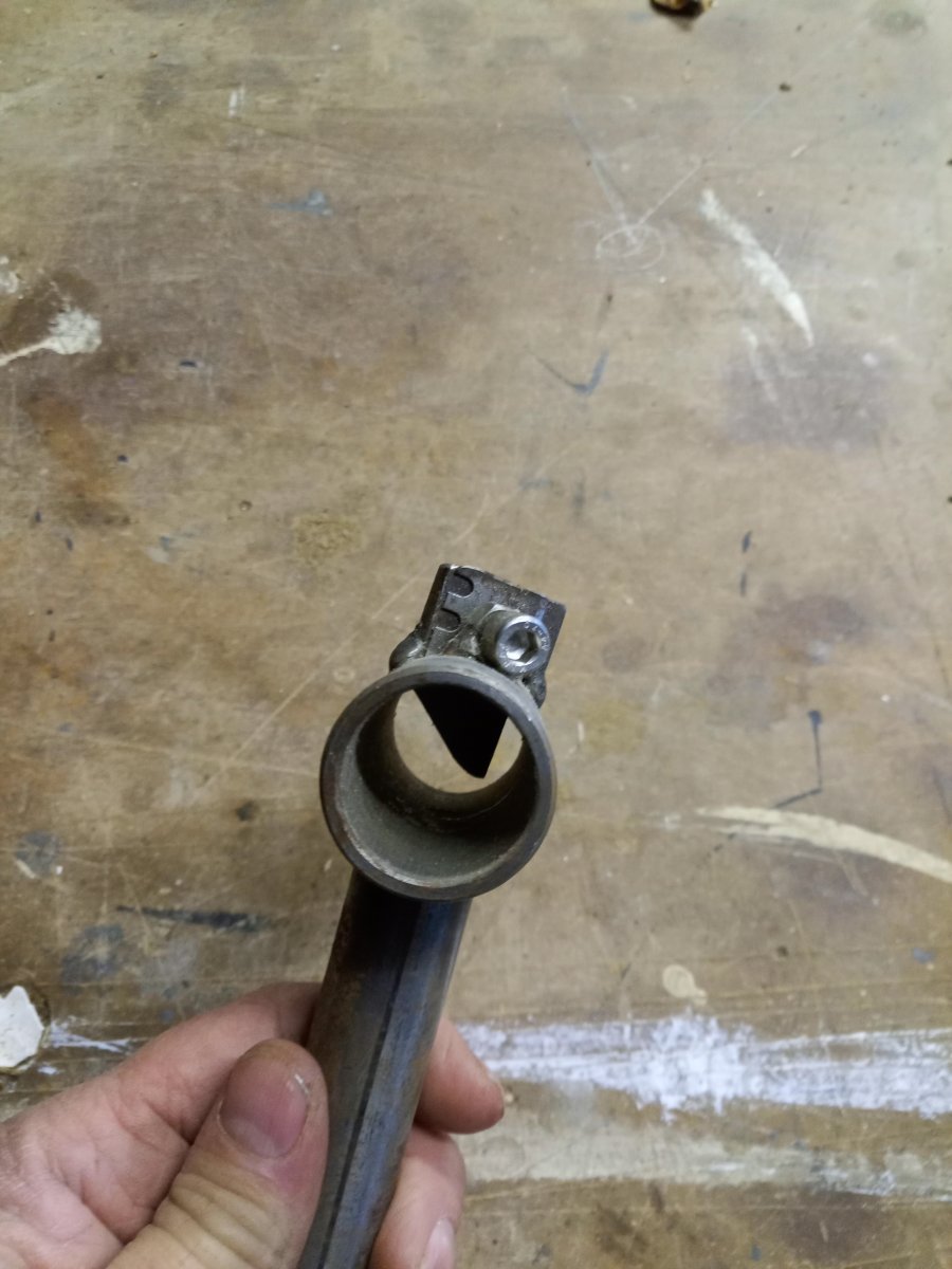

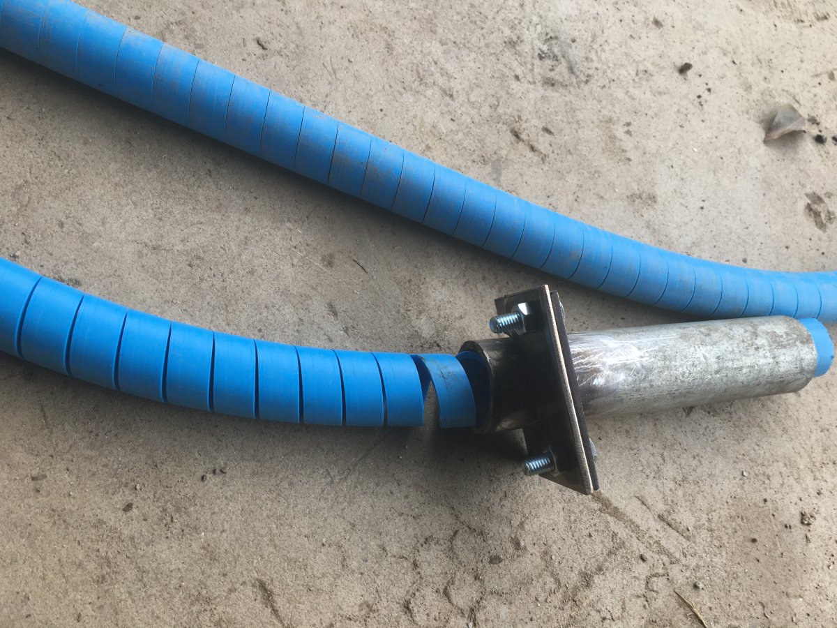

If the tool is in the chuck, then he’s only got to hold it to stop it rotating. The right angle on the tool and it would feed itself.
Steve
I did this a while back, I wouldn‘t need enough to want to bother with power feed.
