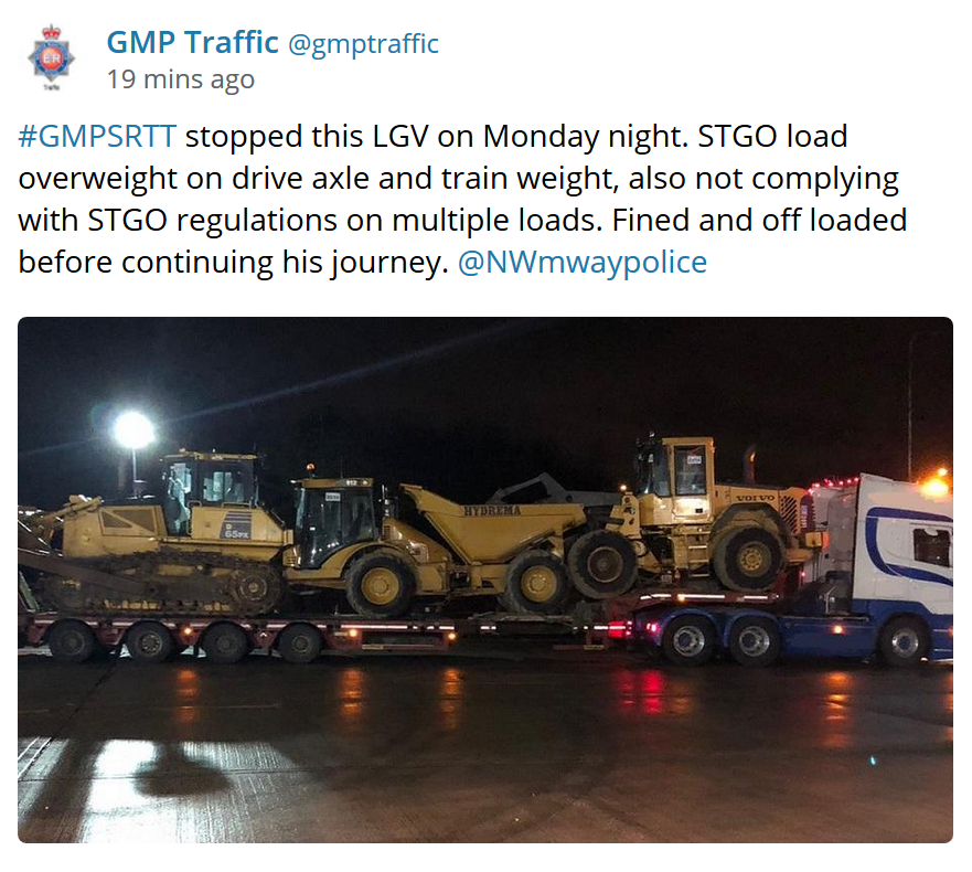

Wonder how much overweight he was...? I guess if it wasn’t for the dumper in the middle he’d be fine? 🤷‍♂️
Feral as Fk
Load woudl stll be divisable though? If he was trying to run STGO
He could probably get away with the Dumper arse on the neck and Loader over the trailer axles. His big issue is trying to be clever. Euro Auctions Load.
You can have a second item so long as they begin and finish journey at the same place and the second item doesn't take you into the next category of stgo
I can't remember exactly but I think extending the trailer isn't allowed either

Should've got the front wheels of the loader in the skip of the dumper and he could've closed the trailer 😲😲😉
