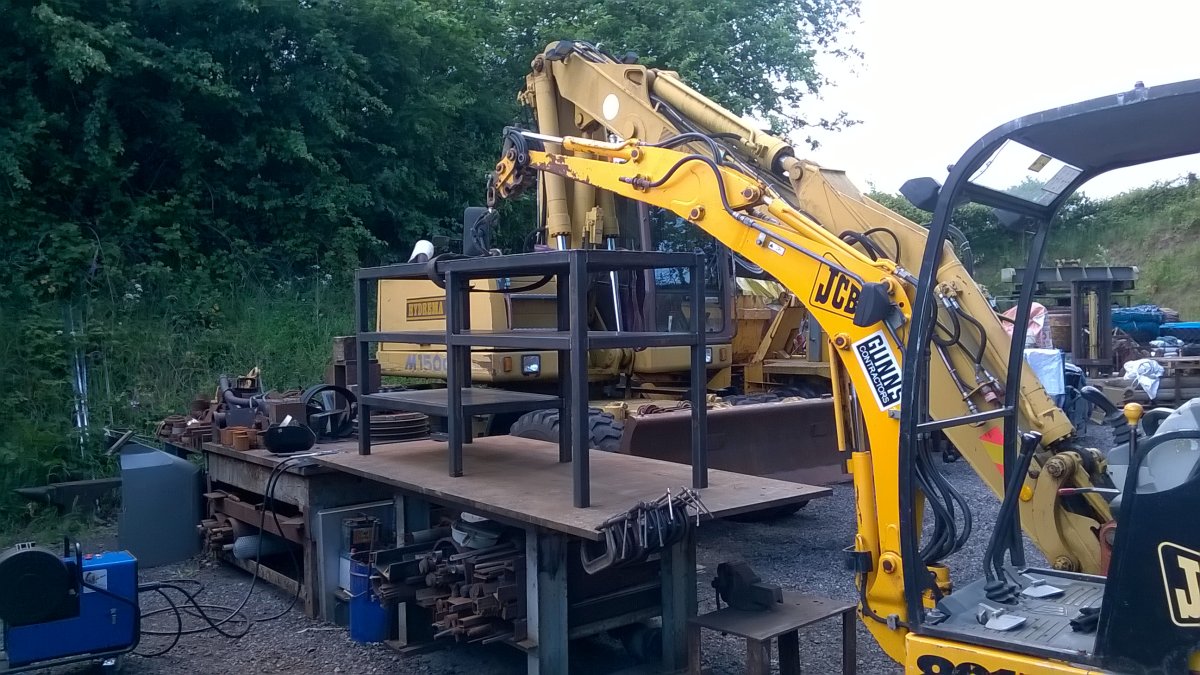

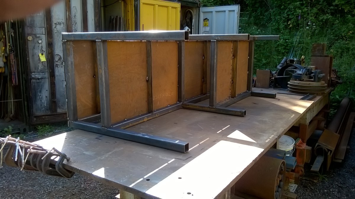

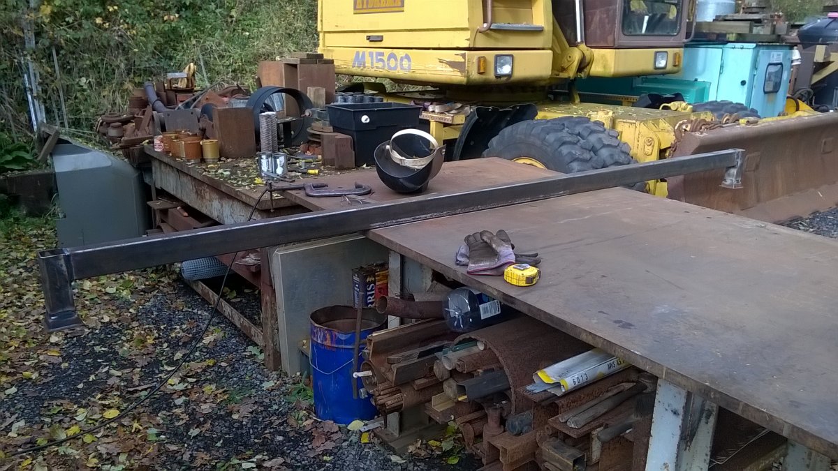

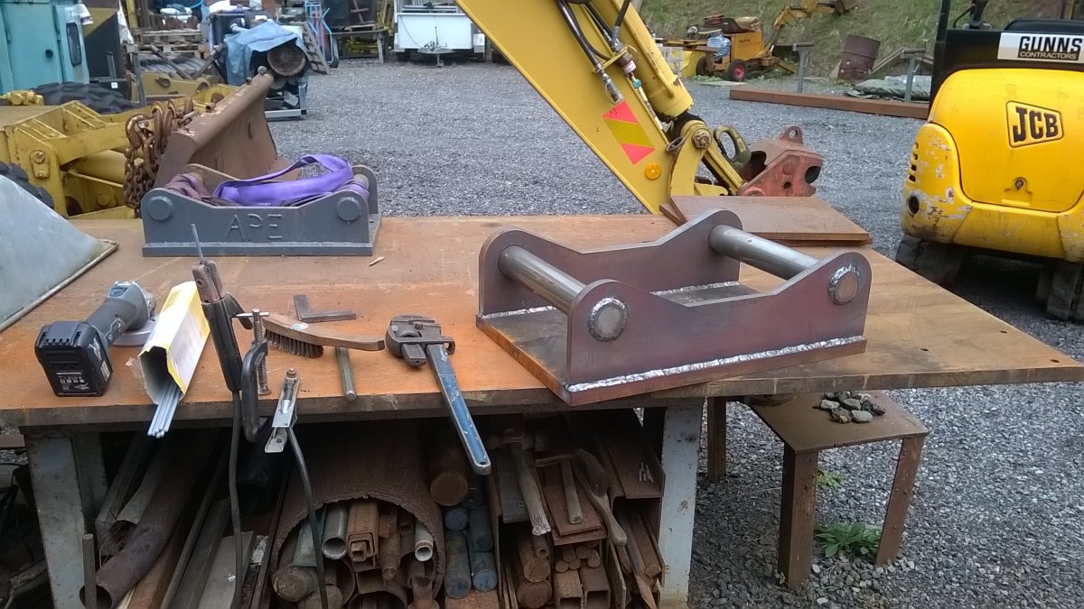

please send us a photo, if you have set up a workstation with a welding bench, kindly attach a photo in the shed, we would like to create a maintenance laboratory such as a blacksmith's shop for our creations and repairs, thanks
buddy, you're a versatile, ingenious man, good, mechanical welder and blacksmith like Archimede
your beautiful structure is equipped for every eventuality, like Michelangelo Buonarroti, well done, if I can I will take into account your solutions and your ingenious suggestions, versatile and do-it-all. you have a solution to everything well done

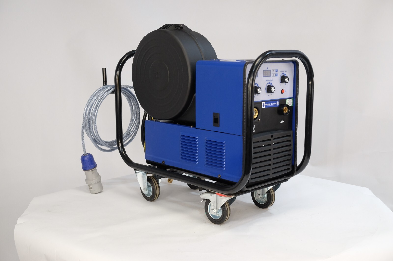

What brand and model would this welding machine be? Sorry if I take advantage of your patience and kindness. You are very reliable and helpful. Thank you. In Calabria we are behind the times and cavemen from the Stone Age still have to bring us fire, greetings.

it's a Warrior 250A MIG welder - 240v ........ and flattery gets you everywhere ;):ROFLMAO::ROFLMAO:
