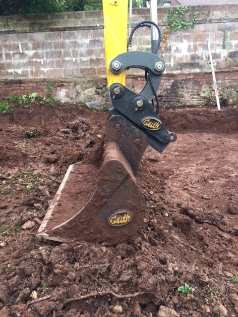

Anyone fitted a hydraulic hitch on a 1.8t machine ?
does anyone make one that small ?? .. 's one tiny hitch to build it all into -- would take some doing to get enough stroke in a ram to open and close tight :unsure::unsure: ....... and hold :rolleyes:

have had to extend the body substantially beyond the bucket back to get there though :unsure::( ...
bet it will not be a cheap QH :rolleyes:
