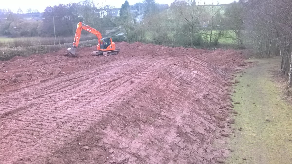

If it can be bunded anywhere adjoining the strip then a dozer might be worth considering, but not if it also needs loading and carting elsewhere.
2 weeks with a 13 tonner and dumper should be easy peasy, that’s only 1/4 acre a day.

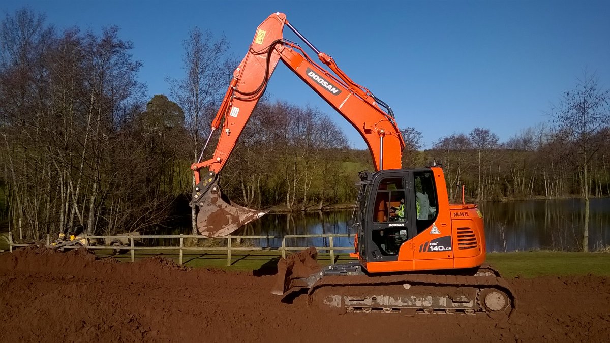

13 tonner with a blade :giggle: to boss it about , then pick it into dumper
