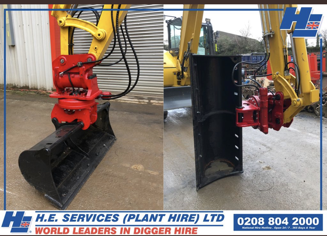

Anyone got a link to those cheap worm drive rotators? Considering welding one underneath my PowerTilt to test the water. @V8Druid
Grahams
Grahams
I think it is a good plan, but I have no time for anything from Masterhitch. They are a complete nightmare in my opinion. I cannot believe they sell any to the general public, only to HE.

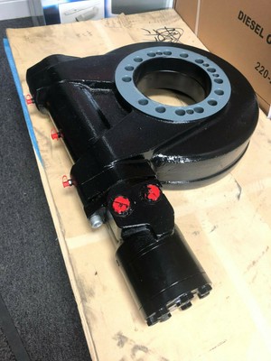

sorry Ruben, this one went right by me .... those cheap rotators were on Norway's Finn site ... Chinese sure enough though ... I did see some recently for a couple of hundred quid but can't recall where ?? :unsure: ...'Praps Frank @Bucket on wheels could turn them up on Finn .. searching that site with zero Norwegian is not easy ....... IIRC Wee were advertising them Frank
wd7 or wd9 worm drive on Alibaba or this guy lists one he used in his video. Another one built for a U10
another guy was quoting Alibaba as a source, but failed to find the units he was quoting on there ... they're getting huge use in solar array positioning so their prices are reducing from what they were as demand increases
couple of leads here ..... and not dear ..
just watch there's no free Covid with 'em
.... 3t fixed rotators for just over 600 quid .....
and that's under 500 quid if you have a VAT no. ........ 25% VAT over there and not payable if you're importing with a reg. no. :giggle::giggle:
