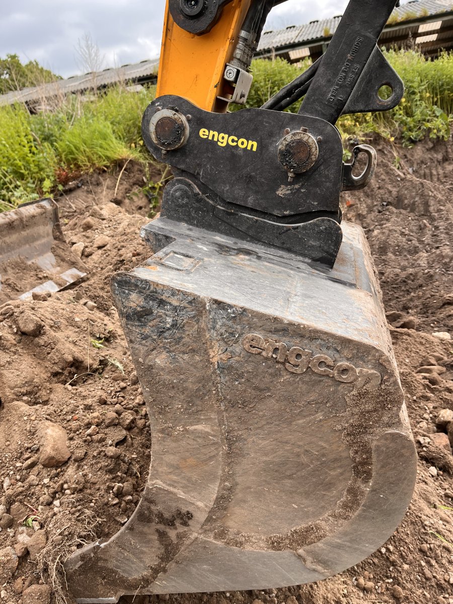

This is the height of Engcon S40 top hitch… which is probably the highest of them all, I’d get a steelwrist one next time & just sell this hitch with the machine.
This is the height of Engcon S40 top hitch… which is probably the highest of them all, I’d get a steelwrist one next time & just sell this hitch with the machine.View attachment 60409
same sort of scale as my Miller PUP .. the gain there is on the bucket cheek's low profile
