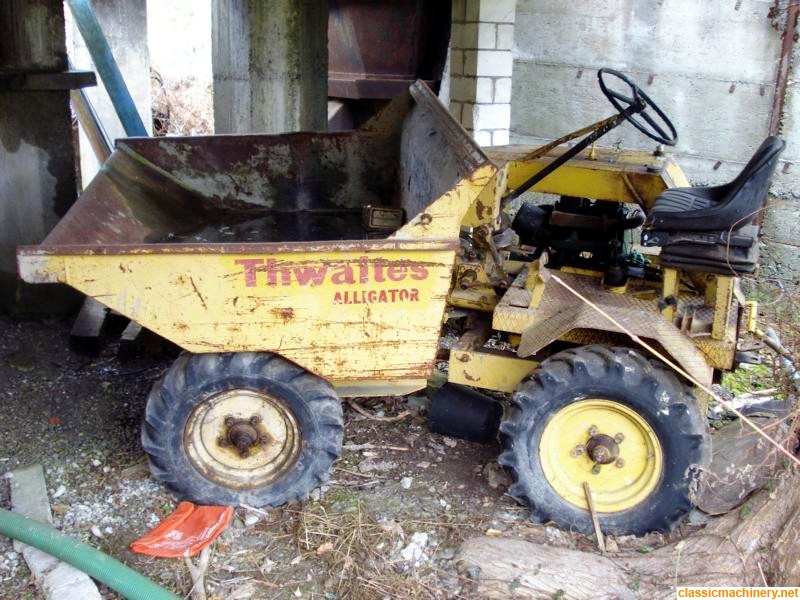

not mine ... but an Alligator ... they're thin on the ground

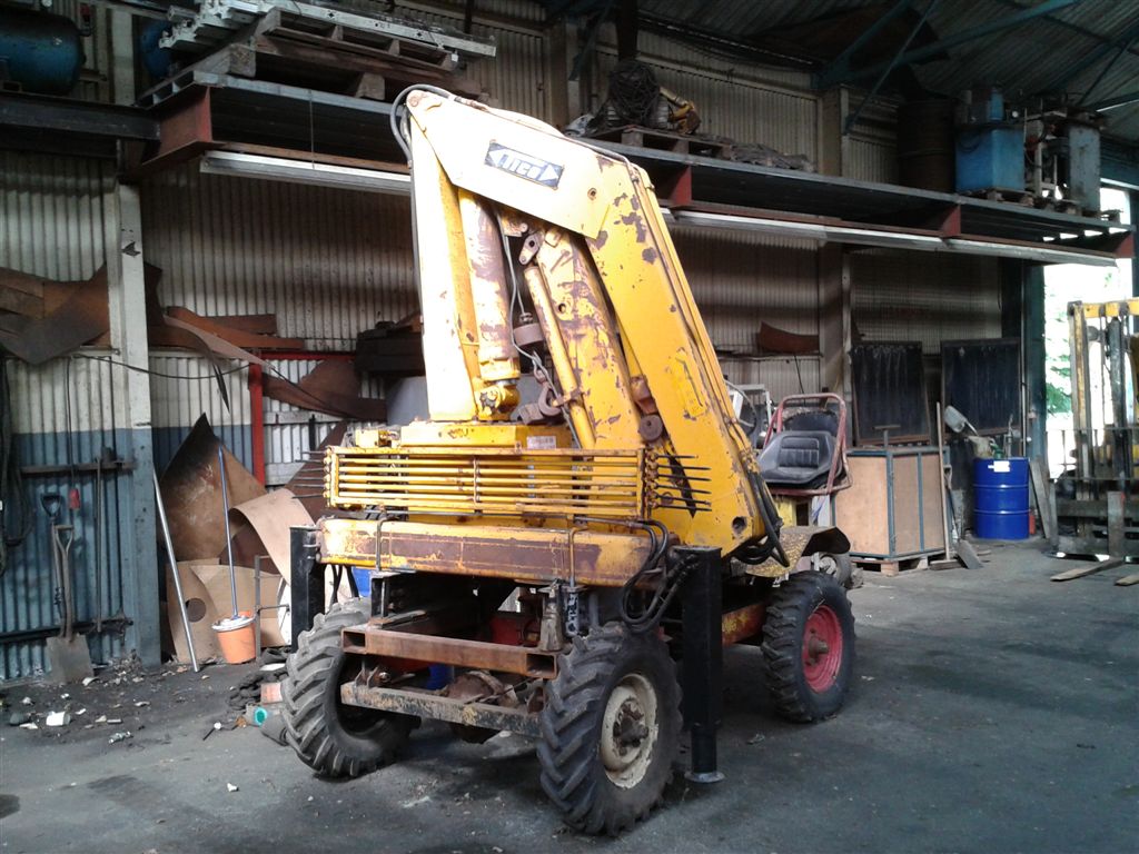

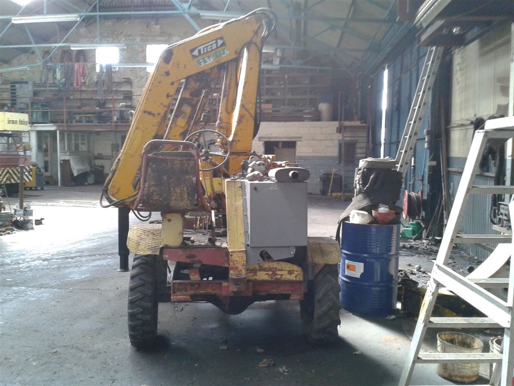

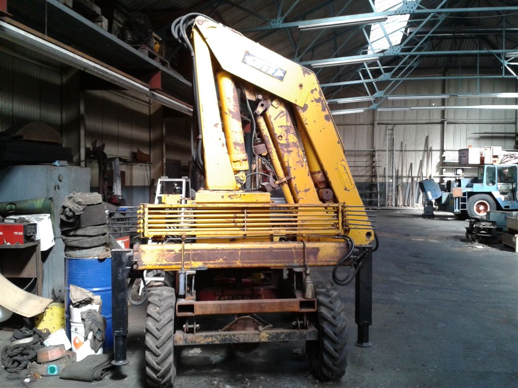

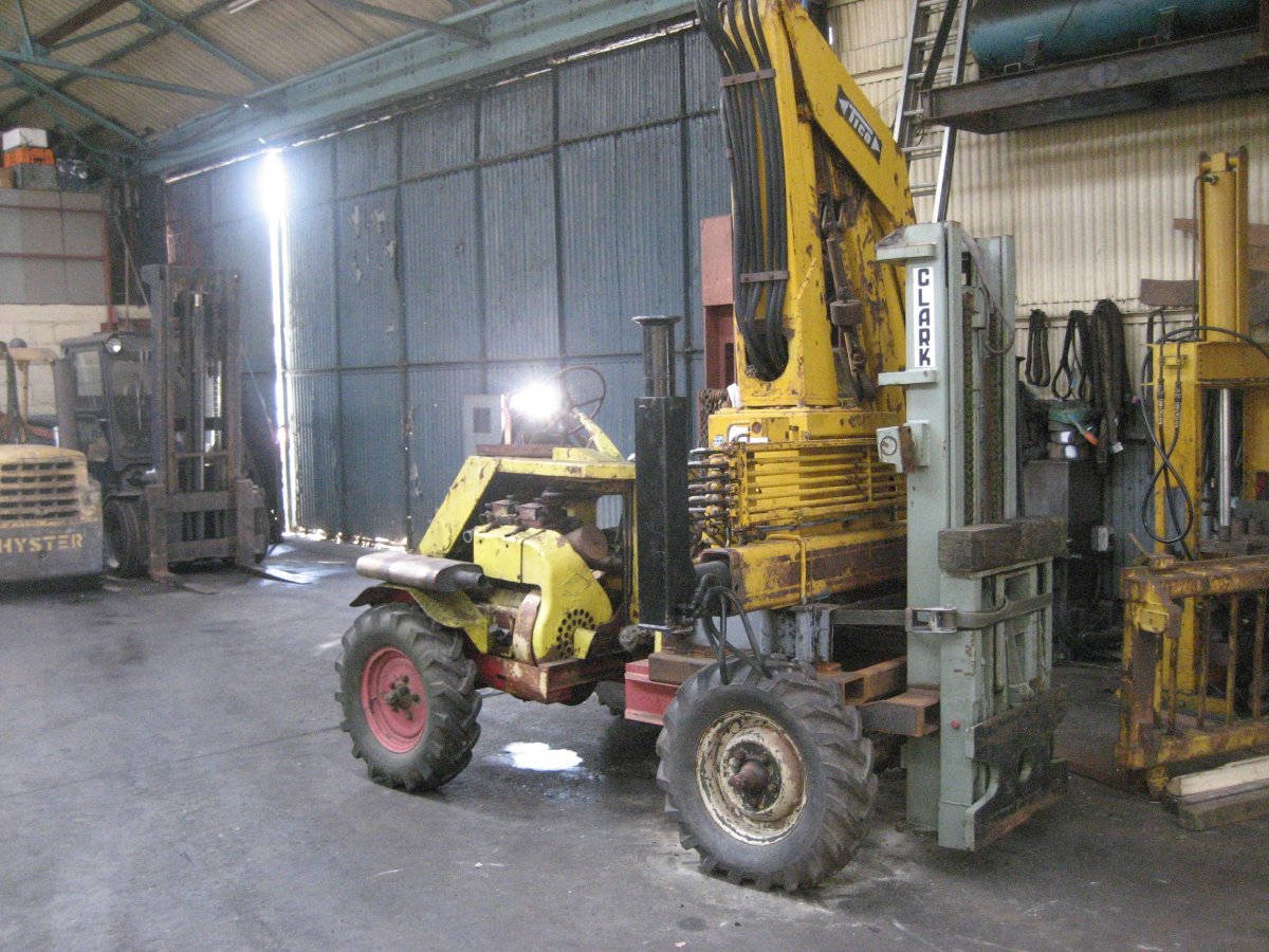

made it a bigger oil tank to cope with the fork mast
the mast and crane on, just for shifting it about :rolleyes:
.. too much with both on and the crane's in the way of the tilt ram (skip tip ram) for the mast.
need to sort the plumbing on it, to finish it off ...

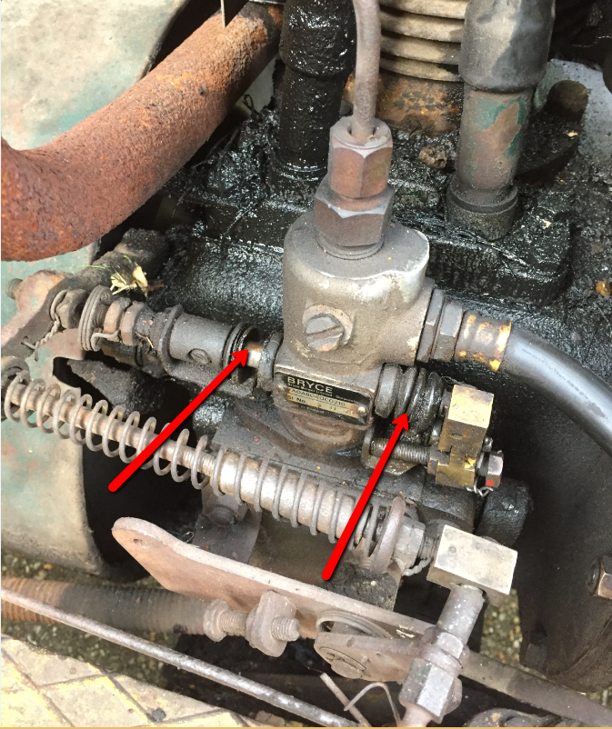

has an over-fuel setting on the rack for cold starting.....slide the rack beyond flat out by swinging the stop block aside from the stop.
best image I can find on't 'net
swing the brass bit with the bolt stop in it aside to allow it to open fully for cold starting
