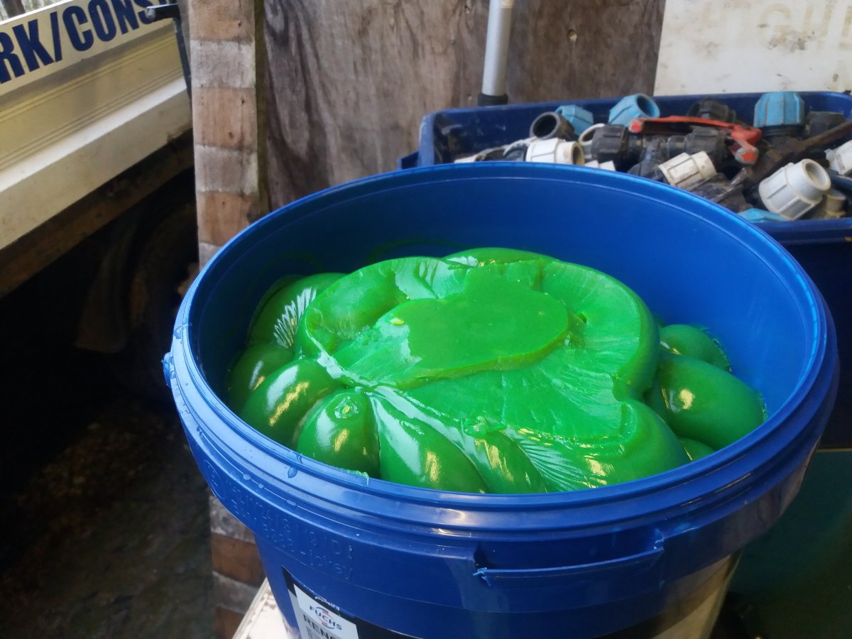

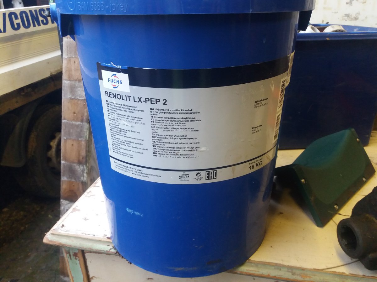

Thanks .is it special or something. I got given two cases for doing someone a favour.
Likes
153
#4
Would be a better qualty than the standard EP2 grease, mainly high temperatures etc. good for pin a bushes as it sticks to the pin better etc

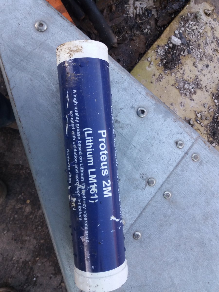

" Proteus Lithium EP Grades 000EP, 00EP, 0EP, 1EP, 2, 2EP, 2M, 3 Operating temperatures vary by type from -30c to + 130c The grades indicated with EP signifies the inclusion of specifically selected extreme pressure additives, and in the case of Proteus 2M the addition of Micronised Molybdenum Disulphide enhances its operational characteristics "
http://nhfsupplies.co.uk/pdf/batoylefreedomlubricants.pdf

What about Castrol spheerol epl2?
Was the only grease in stock at the time.
Don't really get all the grease grades anyone got a dummies guide or just a plain use this, on this 🤓
