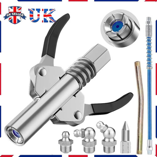

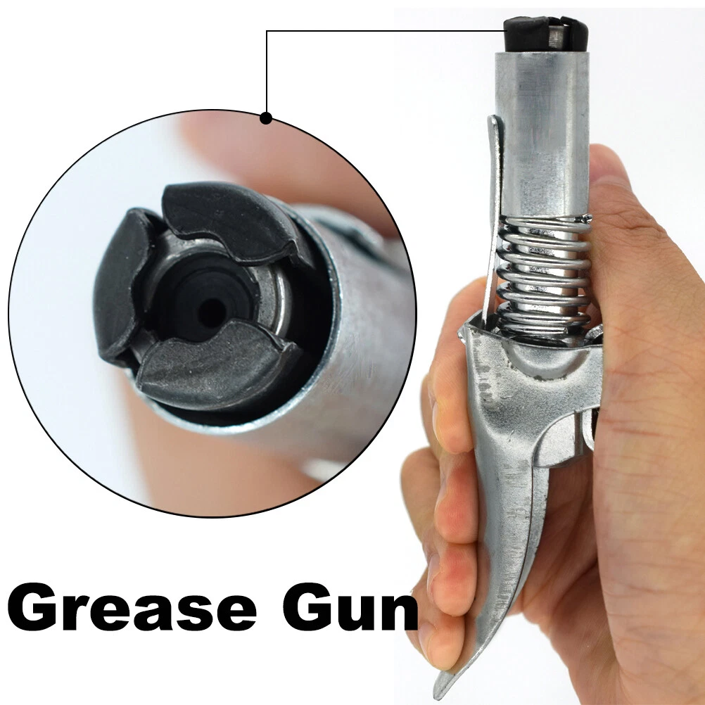

bought one of these a while back ... 6 gripper jaws .. clings like a limpet and a real narrow nose - POP to get on/off and no leaks
also have one of these three jaw jobs (similar to the Saker ones) which seem to grip better than the original 4 jaw genuine G-couplers (which I also have and leak the most/given the most trouble) :(
Saker version

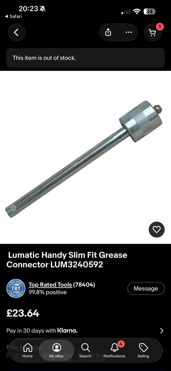

Must admit now I’ve gone cordless grease gun I don’t use the g -coupler as you have a spare hand anyway.. biggest problem is getting the connector off when it’s under pressure!
Had my grease gun stolen out back of truck as it’s a dewalt one in box guess they thought it was a drill not a grease gun covered in grease
Had g coupler on it and had a long thin adapter for Takeuchi boom pins was a good find but can’t find it again. Must have been about 8mm thick and normal threaded connector on end and 120mm long didn’t clip over nipple but could press and hold it on can’t find it now to replace it
Ok found it

So you grab that with the g-coupler? Looks ideal!

I bought a G cpl 2 years ago but had that same problem. Can you send a link?

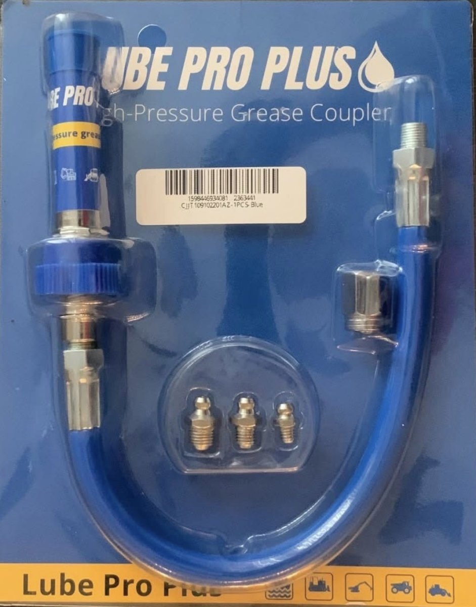

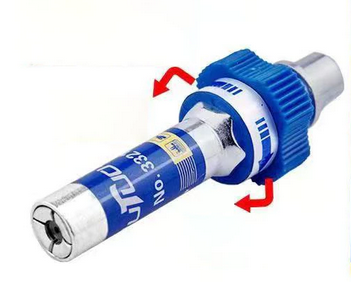

Anyone try’d these?
I've got one, but yet to fit it.
I need to swap a few nipples to allow access for the longer chucks.
I assumed the collar was spring-loaded and only needed a fraction of a turn to open/release, but it's a fairly normal thread and may take two hands to nip it up.
I suspect it'll be easier to use on a rigid rather than a flexible tube.

What’s the point of them ? If you need to turn the end to lock them on and you need to change some nipples what is the advantage over other grease gun heads ?

Changing the nipples isn't a big issue, I like having straight-on access as it gives the best chance of a seal regardless of chuck style.
As for the chuck it's self, I'm failing to get excited.
Maybe, once on, it'll lock solidly, maybe it'll give a superior seal.
Maybe not.
