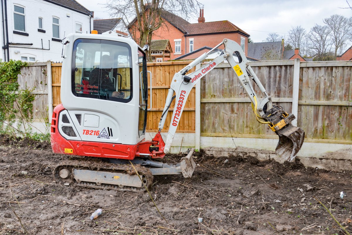

Smallest one we've done so far is 1t, Doob, although if you want to know about the Yanmar, talk to Chris Meek - the owner. He'll be bringing his digger to Yeovil.
John Clarke (based up in the Wirral) has a twin hitch setup where he shares the EC02 between his TB210 and TB216, Here's one of the 216:

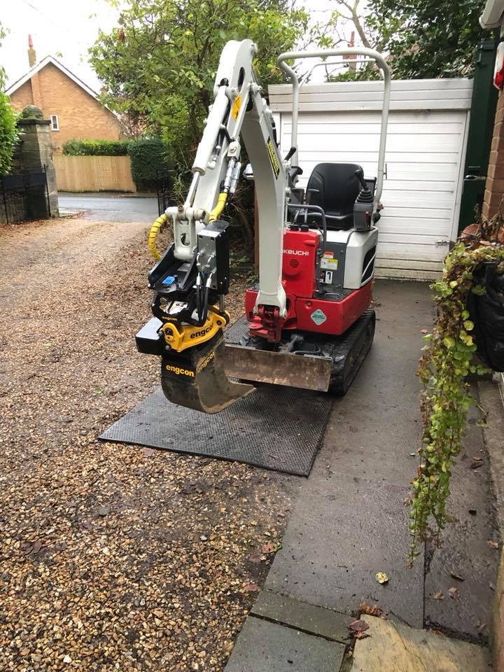

and the 210:
Probably 80% of our installations are twin hitch. The issue about sideways force is that it's generally the tilt ram that's doing the digging, not the slew ring.

Is the 210 direct mount or hitch?
Not to piss on his chips but that looks more hassle than it's worth. He's hardly got the bucket a foot off the ground yet already at full boom height. You can barely load a track barrow with a normal quick hitch on a micro, so to load it with that he'd have to twist and tilt. Guessing it'll be a button divertor and aux on a foot pedal (?) so thats a lot of contortion, physical effort and concentration just to tip the bucket into the dumper. Then the same again to return to dig. Couple that with the much reduced breakout and I think I'd sooner get off and shovel.
Not used my Powertilt in anger on my Bobcat micro yet, so could be wrong!
Twin hitch, Doob. He swaps it between the two diggers.
TBF it spends most of the it's time on the TB216. I believe he put the S30 hitch on the 210 to standardise his attachments more than to run the tilty, although he does use it when he can't get the bigger one in to the site.
The control system is (from memory) SS15 which is buttons on each joystick to operate tilt and rotate with the flow controlled by the pedal (a little bit like Druid's)
