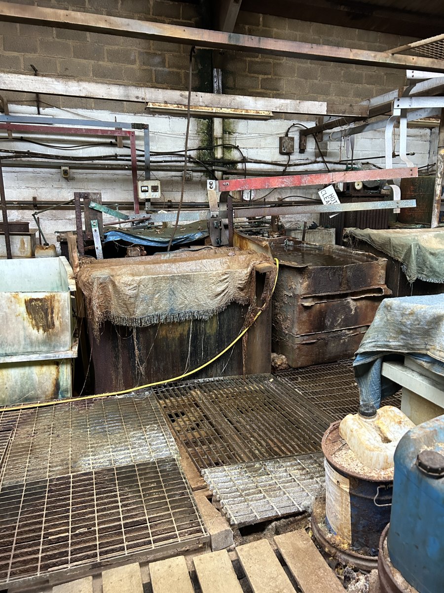

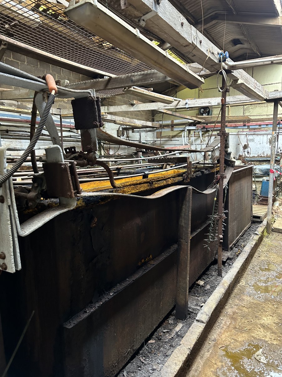

Managed to get to see the inside yesterday.
It has been used by an electro plating company for decades. I had hoped for overhead gantry cranes etc. Instead it was all small stuff, so nothing of value, just cost to dispose of. It looks like they have gone bust and just walked away. The unit is mostly filled with tanks of acid which are the buyers responsibility.
Their appears to have been no maintenance done ever. The roof (which is asbestos) is falling in places and rain is pouring in. The concrete floor is broken up and has large liquid filled pits in places. The structure is concrete framed and the damp has got into the beams bursting off the concrete round the rebar in places, so guessing the whole thing will need replacement, which given it is part of a run of units could be interesting.
The camera lightened everyting. In reality it was dark in there.IMG_2721.jpegIMG_2722.jpegIMG_2724.jpeg
The camera lightened everyting. In reality it was dark in there.View attachment 54208View attachment 54210View attachment 54214

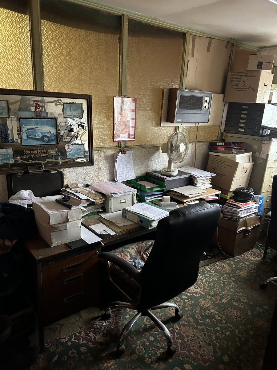

That office 😄😄 did they just shut the door in the 70s?

a wise decision I think .... there will be all sorts of 'nasties' to deal with in there aside from historic ground contamination .... put yer seven league boots on and flee
...... large liquid filled pits ......the damp has got into the beams bursting off the concrete round the rebar in places, so guessing the whole thing will need replacement, which given it is part of a run of units could be interesting.

Would imagine getting rid of the acid could be expensive
You could get some contamination testing done on the surrounding ground but would say due to the lack of maintenance there is a good chance of positive results
Asbestos roof is 10's of thousands to remove and replace although there is over boarding systems like the filon but no idea on costs
