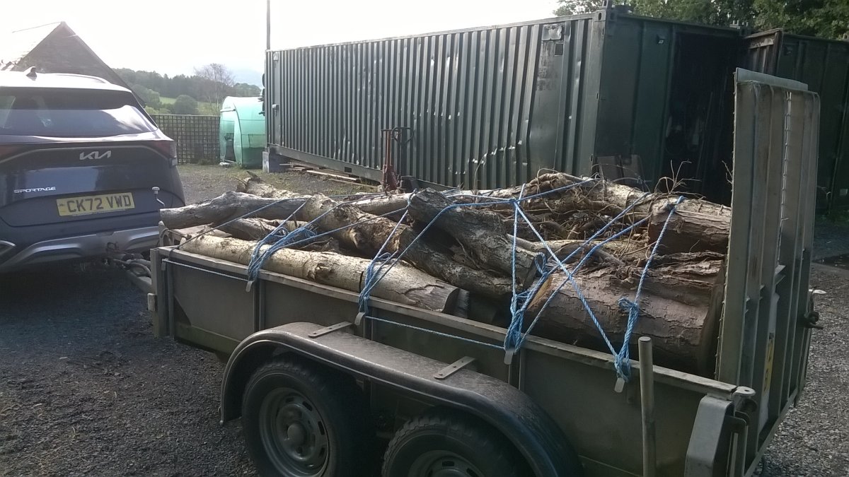

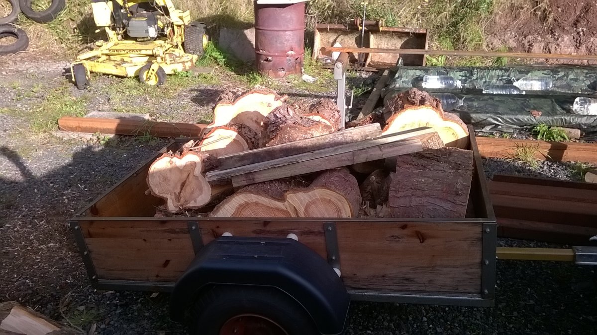

spent the afternoon dealing with this lot
View attachment 64958 View attachment 64959

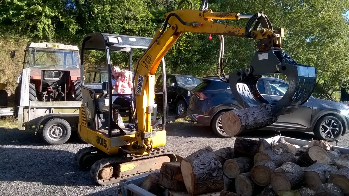

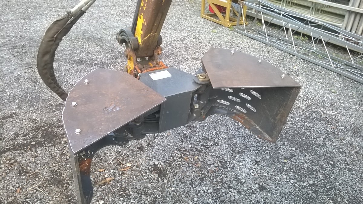

sod wrestling these .. Lil' Jake time - with the Haner for grip and my trusty leccy mak -- on/off/on - simples - ripped through it all - including a few big lumps
this pair arrived 'bout half three and slowed progress a tad ...
View attachment 64966 View attachment 64965
and Clara inevitably wanted a go .. in fairness she wasn't too bad ... give her an hour or two in the middle of a clear patch (with nothing to hit/avoid) and a few bits / targets to practice on and she'd be quite handy with it - picked it up real quick (as they do :rolleyes: )
Mummy rescued me after half an hour and got on with the job

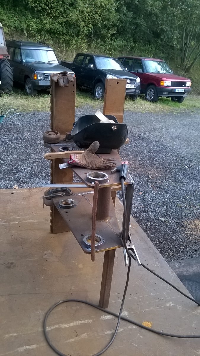

you can see what I meant about the weather not being kind to that piece of 8mm plate, pitting it in places
all four are the same shape so should fit fine t'other side too .... finish cleaning them up a bit more - coat of tish and they'll be just the job

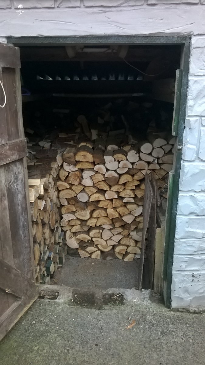

got it all in the wood shed though ...

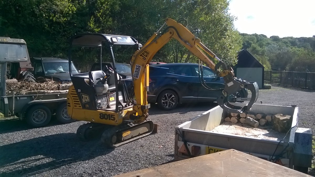

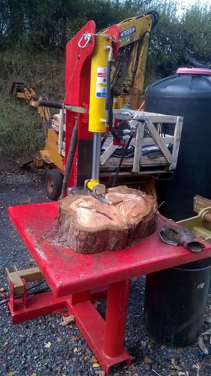

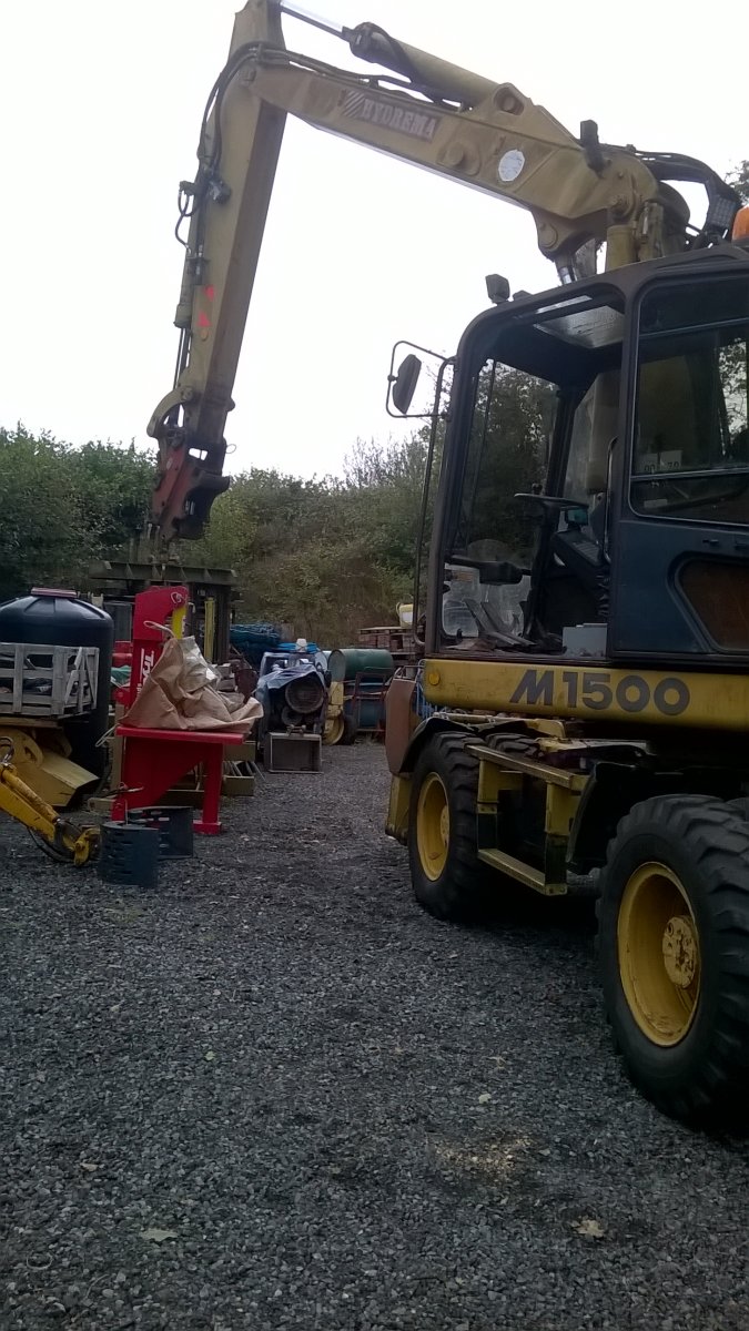

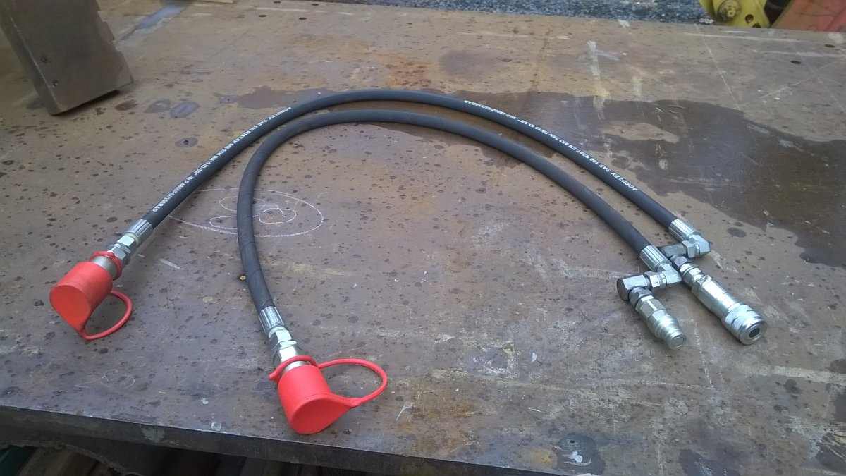

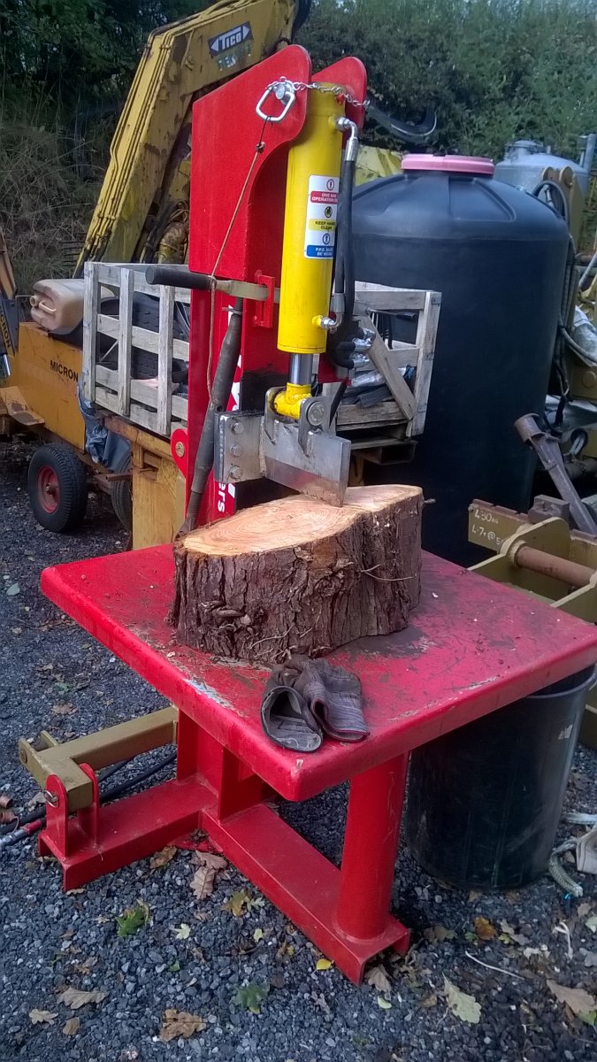

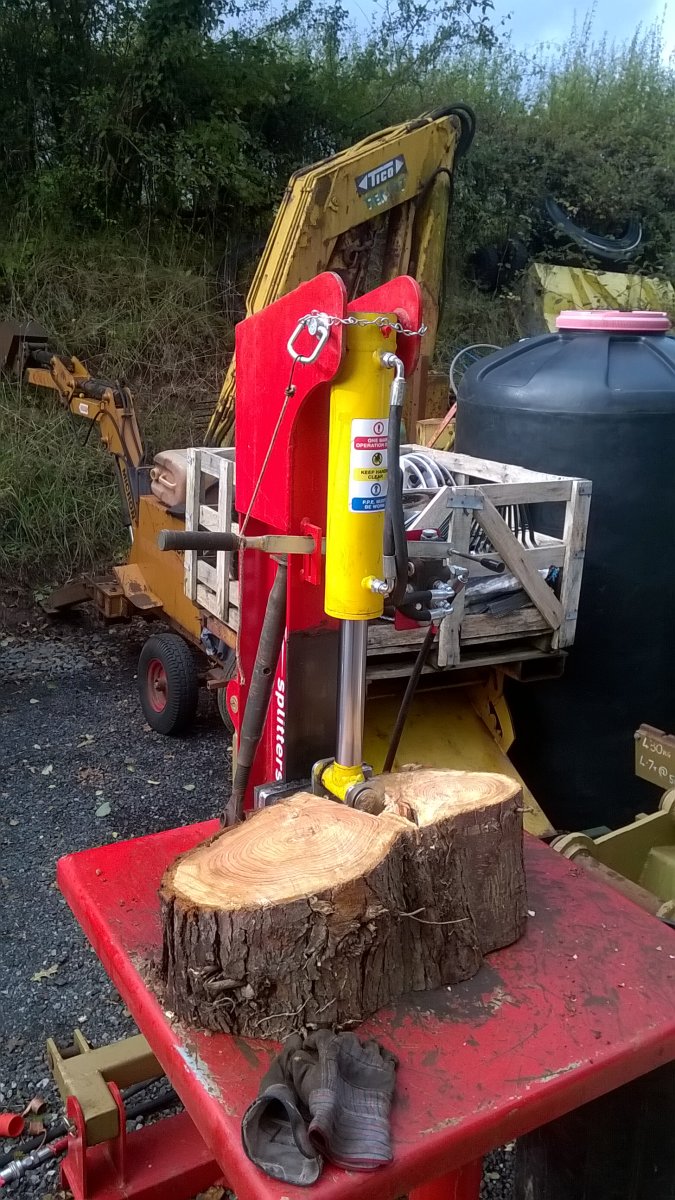

then pulled the 'Drema round to where I could reach the splitter ....
and put it down by Lil' Jake ..... at which point is started to drizzle :cry:
got the new lines coupled up, wound up Jake and pressed the breaker pedal gently with my hand and stalled him ???? :unsure:
odd - should've been a continuous free flow, through the splitter's spool valve and back to tank ... gave him some more rev.s and he continued to run but obviously loaded ?? :unsure::unsure:
checked all me plumbing -- yep - right - P to IN on the spool and OUT to tank return on Jake ...
sod all happening at the spool - slitter ram not moving .....
not what I was expecting .. thought about it for a while - what was I missing???
So rang the guru :) - Mr Mog - two heads're better than one - equally mystified - his best suggestion was the possibility of a faulty QC, which although they're all new, I had to agree with him - does happen - FFs are Holmbury, ISO-As are Flowfit ????:unsure:
AND then it absolutely lashed it down and I took shelter in a box, :cry: after, pulling the hoses from Jake, covering up the splitter and calling it a day ...:mad:
it has pi*s*d it down ever since :mad: and is 'sposed to quit about 5 a.m. tomorrow, :whistle: so hopefully, I'll get to try the guru's suggestions tomorrow and whip the ISO-As out of the lines and straight connect 'em with some adaptors to the extension lines with just the Holmbury FFs to couple to Jake
If anyone else has any ideas .. please share :rolleyes:
first thing I'm gonna try tomorrow is couple the P & T lines together on Jake, direct, to confirm free flow, 'fore pulling everything else to bits, in case it's a faulty QC on the dipper .........
but I did try each one with an open QC fitting, earlier today, without Jake running and got oil out of both open fittings ?????? :unsure: ...
had me flummoxed this afters :mad: ... hence the call to the guru :rolleyes::giggle:
anyway .. we'll see tomorrow :rolleyes::cautious:
You’ve definitely got flow and return the right way around on the digger?
large line should be return ... smaller line should be flow Dan
Isn't tractor axel oil different to digger hydraulic oil need to flush the ram out or you might get issues
I had considered that Stu - EP80/90 in the Zetor ... will pressure the return side of the ram out tomorrow with some air to the closed end of the piston/ram, but TBH I really can't see half a litre of EP creating much issue/ not mixing .. but'll do it all the same .. have had plenty of practice at purging for adding att.s to the 'Drema on bio, not wanting to get mineral into it's system
not many pix of the first half of the day ... too covered in oil to go getting the phone out me pocket :rolleyes::oops: --stripped the splitter of anything that contained EP and blew it all out -- hence being covered in oil -- even after a shower I still smell like a bad day in a transmission re-builders -- accumulated just short of two litres of EP so well worth the effort :rolleyes:(y)
then tried linking P and T on Lil' Jake - still loading -- QCs off and linked with adaptors - same ....
now very frustrated and scratching head .....
Pam arrived with a coffee and a 'can you just', slightly amused to see me 'at a loss' as to WTF is going on/I'm missing ...
Explained the 'nuances' and she said " well come and do what I want and then come back to it " - very helpful :ROFLMAO:
came indoors after and consulted 'the book of words' that @Richard Hunton very kindly sent me some time ago - op. manual, which bar one nugget was pretty unhelpful ... scant info. on the breaker circuit and the fact that it could be had with either a one way or two way service -- I established a long time ago this is only single acting, with the floor up sussing it.
anyway and this should be in the 'dropped a bollock' thread I'm reading the one snippet of info regarding adjusting the breaker pedal's cable set up and how it is centred, for the two way set up and it occurred to me that the pic looked the same for both single acting and double acting, plus with some plumbing fiddling the one way can become a two way (this was discussed a while back) .....
Therefore said pedal should be able to rock in both directions ...
mine was a POP the one way, (which I had assumed was 'the right way') - t'other way was seriously stiff and a very small amount of movement - it was however 'the right way' - it transpired ... :rolleyes::oops:o_Oo_O
so numpty here had been dead ending the bloody thing, pressing the pedal the wrong way and didn't even consider it'd rock t'other way - just didn't feel like it'd move that way -- so lots of lube and it's now a little more co-operative AND I had oil at the splitter :giggle::cool::cool:🙌
damn I've wasted some time on such a simple issue :mad:
live and learn :whistle::censored::(
so .....

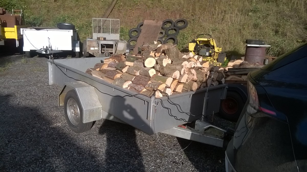

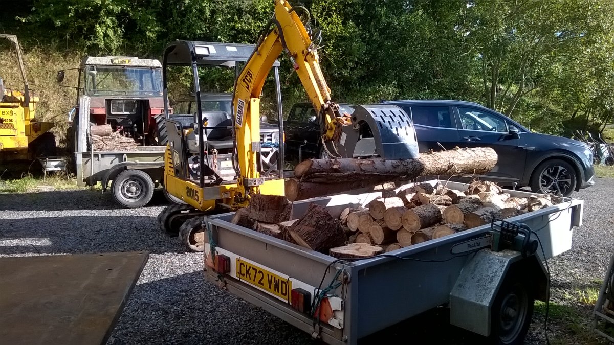

the gnarly sh1t turned into Morso fodder in double quick time after that ... and who needs a saw, for the bits of bench, when you've got a 15t splitter :giggle::giggle: .. cross grain - no problem - chop chop :)(y)

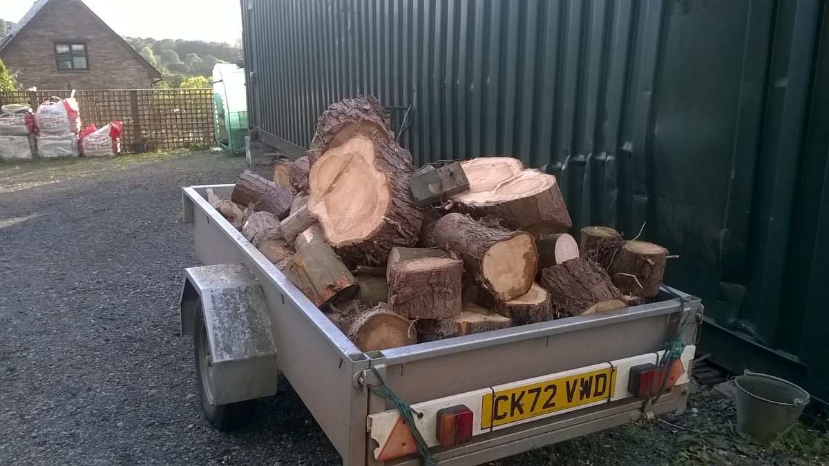

trailer refilled with bits, I trundled it down to the wood shed and stuffed it all in there
good load from not a of of bits :)

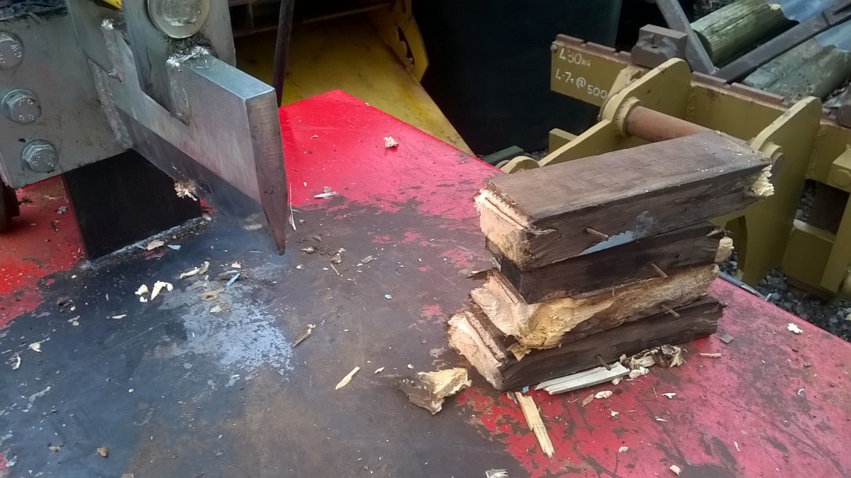

View attachment 65092 View attachment 65091 View attachment 65090

we all have done dumb stuff ,i thought the spliter would work backward if you pressed the pedal wrong way
that would've been an improvement on not working at all :ROFLMAO:
sadly my breaker is only single acting (but with the two way pedal) so was dead ending the bloody thing ... at some point I will convert it to double acting - the port is there in the valve block - capped off - @Rob65 gave me a heads up on how, but'll have to collect some bits together and either cut into a steel pipe or replace it with a couple of flexis and a 3x1 diverter IIRC :rolleyes:
So it does have 2 way hydraulics then (or at least the valve for it) or am I missing something?
it doesn't (but it could have) :rolleyes: originally supplied with one way - the valve block has the port for the two way/second service, but not the diverter circuitry to give you an open to tank line for a breaker ...AND a pedal that theoretically acts both ways (once sufficiently lubed)

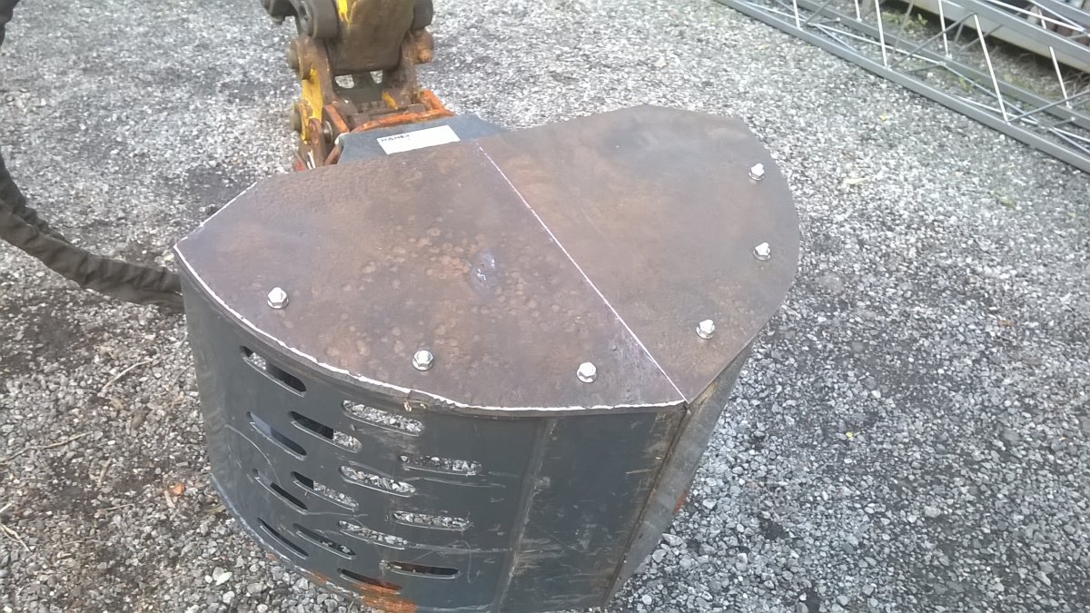

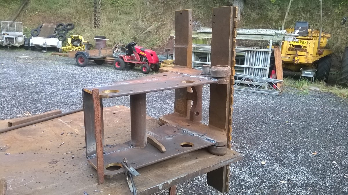

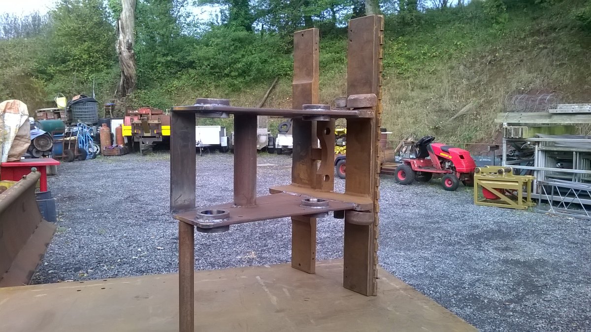

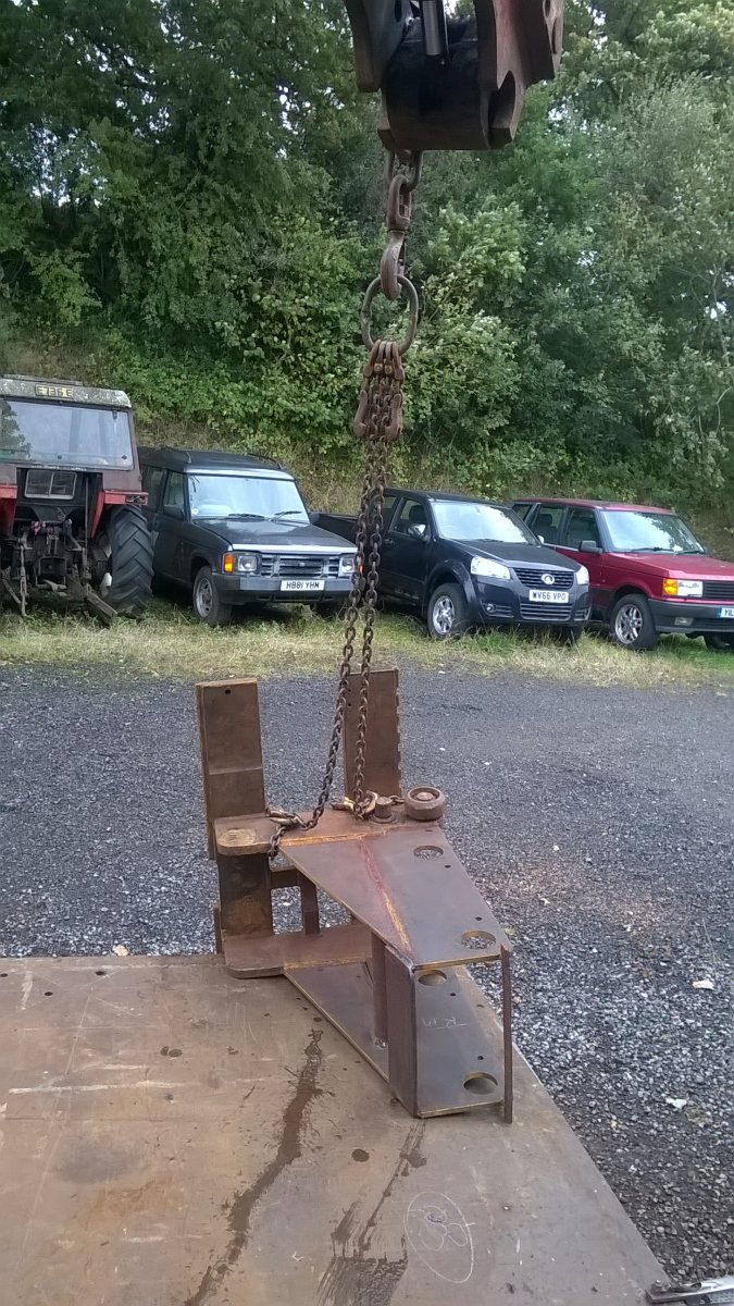

so -- bench time - Zetor starter can wait :rolleyes:

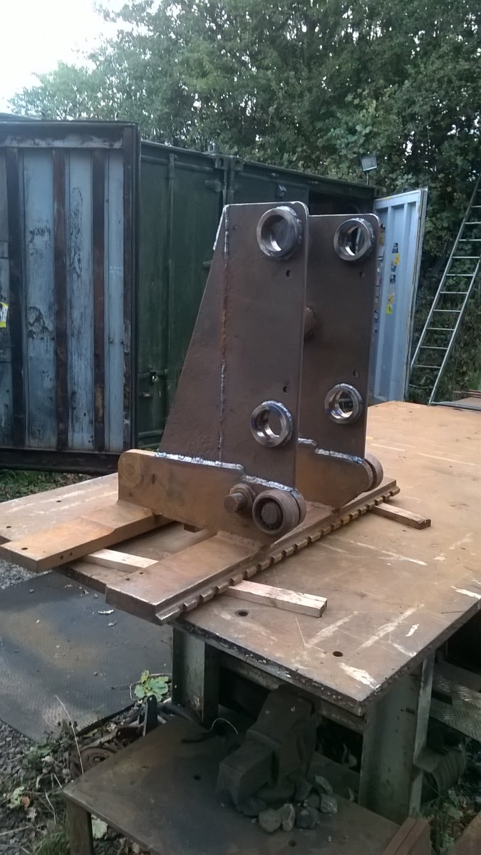

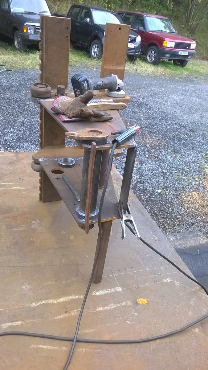

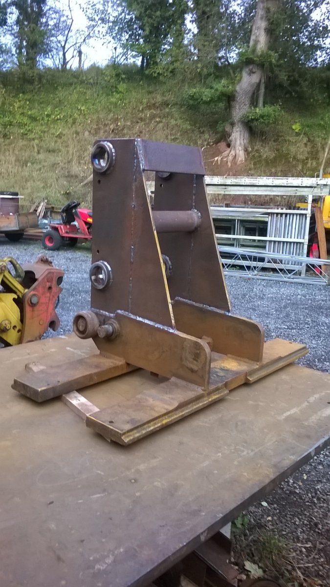

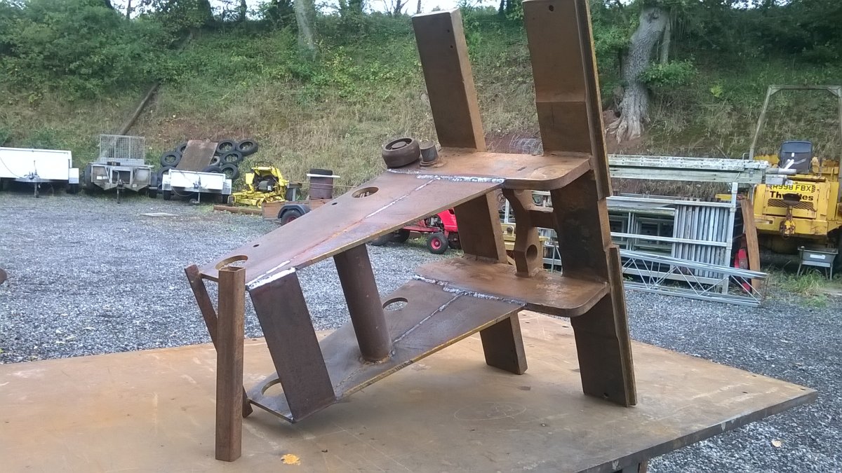

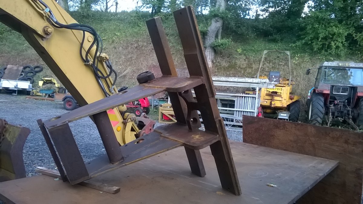

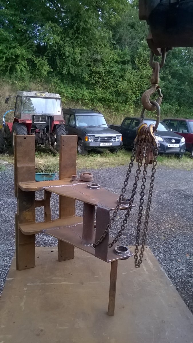

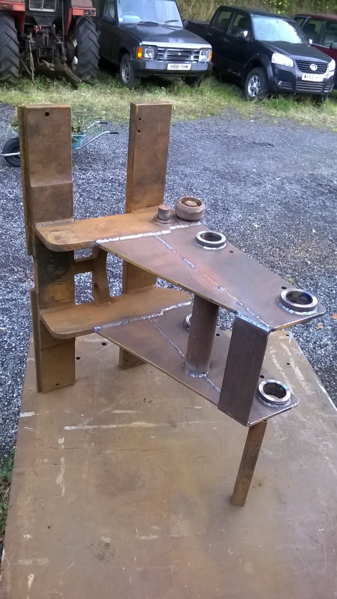

wanted to get on with this today

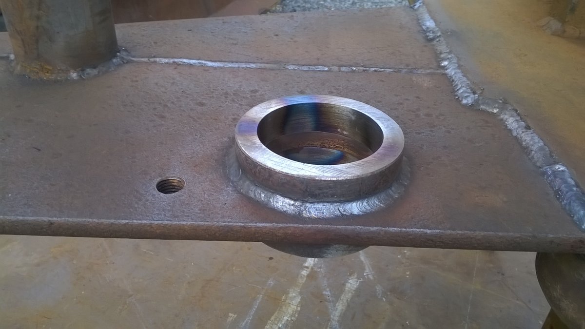

got some beefier welds on half of it
then wound up me 'lifting facilities' and flipped it on its other side ..
for some matching welds and flipped it back to do the other 50%
then back again for the final 'beef up' .... followed by some boss fitting
then flipped again for the other side after I'd consolidated the first set
lot of faffing, but had to be done systematically to keep it in shape
and hooked up again after a good clean up
ready for a coat of shiny tish weatherproofing .... :giggle:
got a bit on after tea, but beaten by the light - as usual - so finish it off in the a.m.
