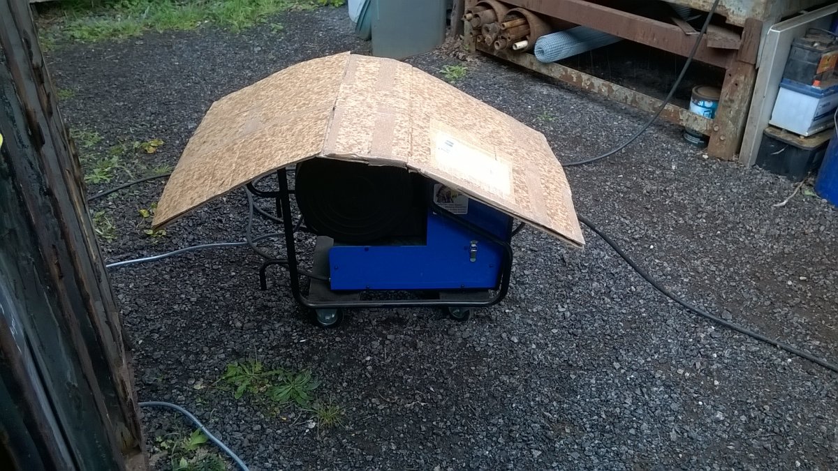

had barely had the gear out ten minutes and it rained ... sunny when I opened up :rolleyes: .... been like it on/off all day:cry:

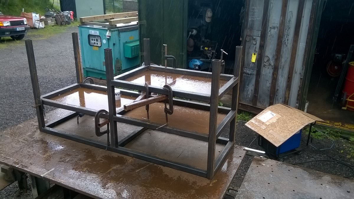

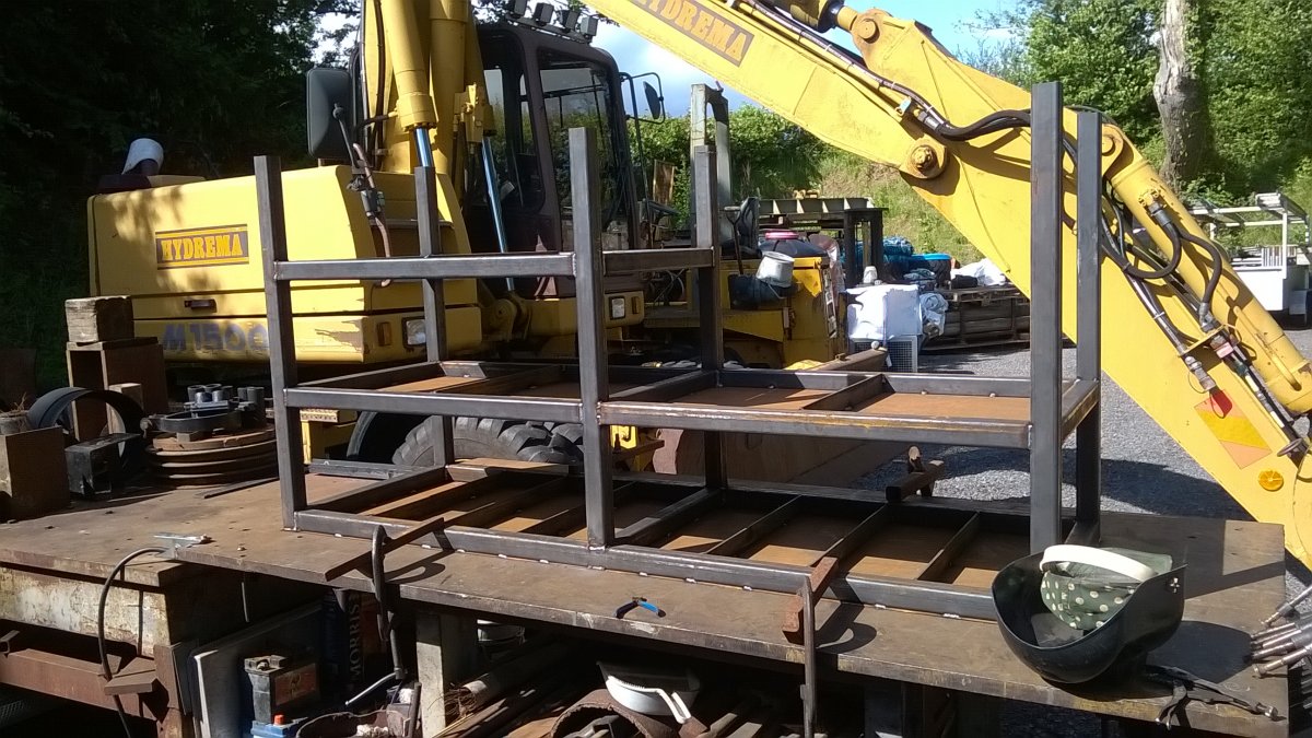

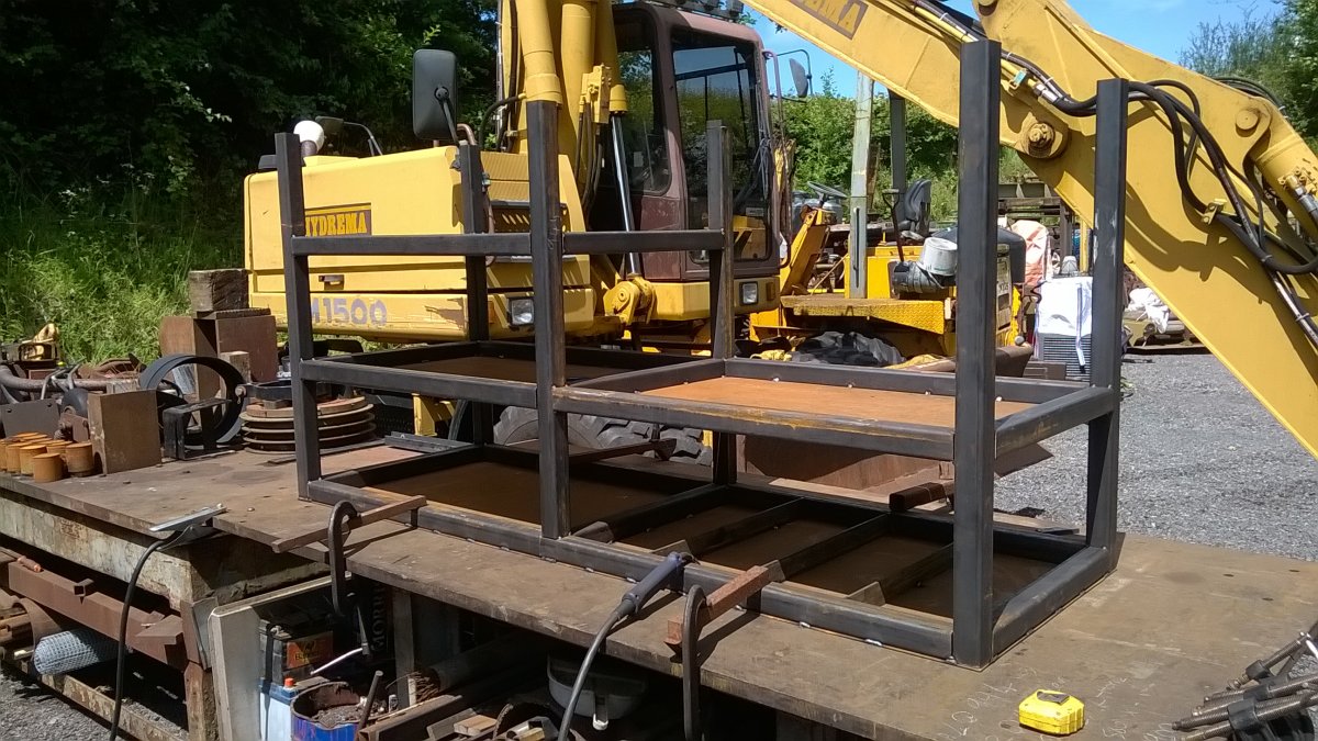

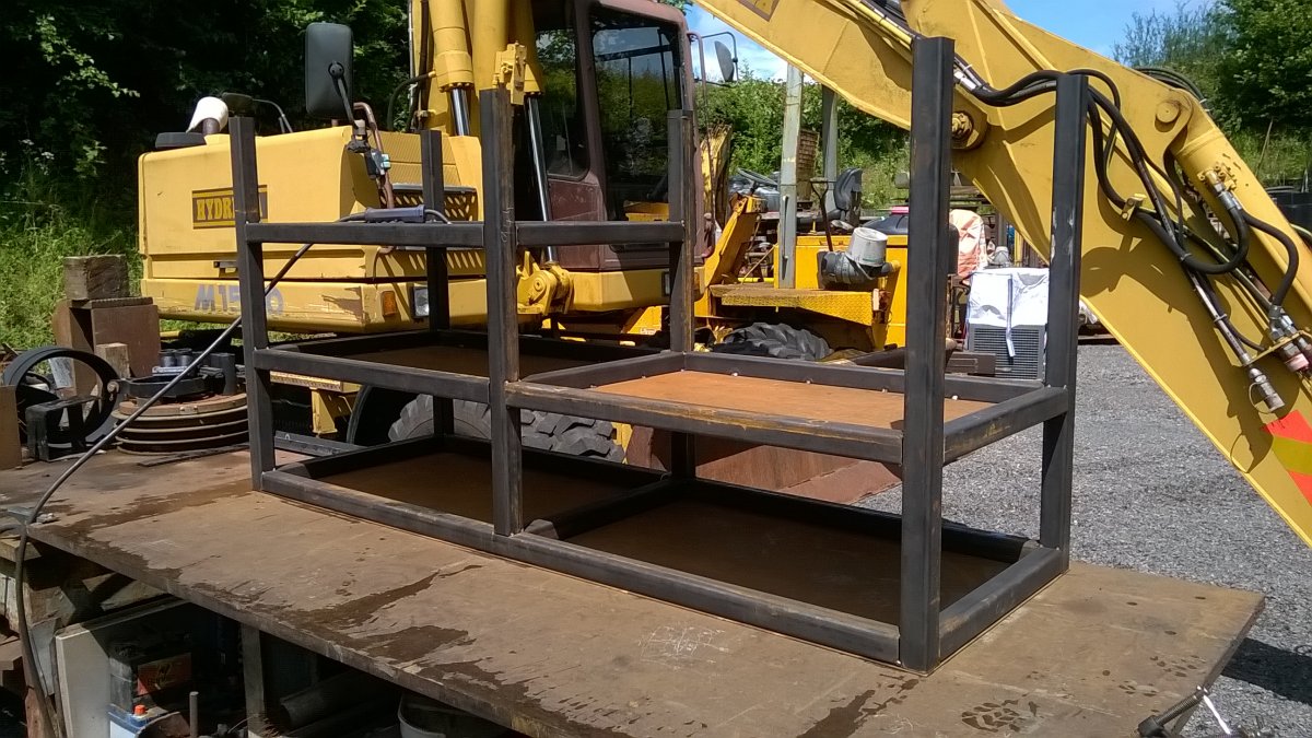

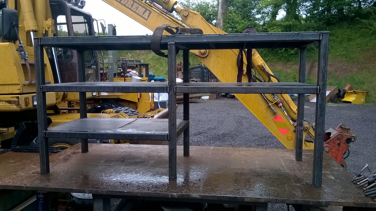

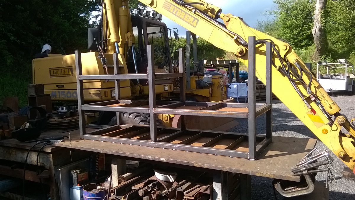

cleaned up the plates for the last shelf and got that in first off
and got pee-ed on ..... the the sun came out again and it dried pretty quick ... MIG does not like welding in watter ... :(

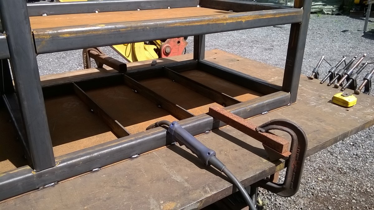

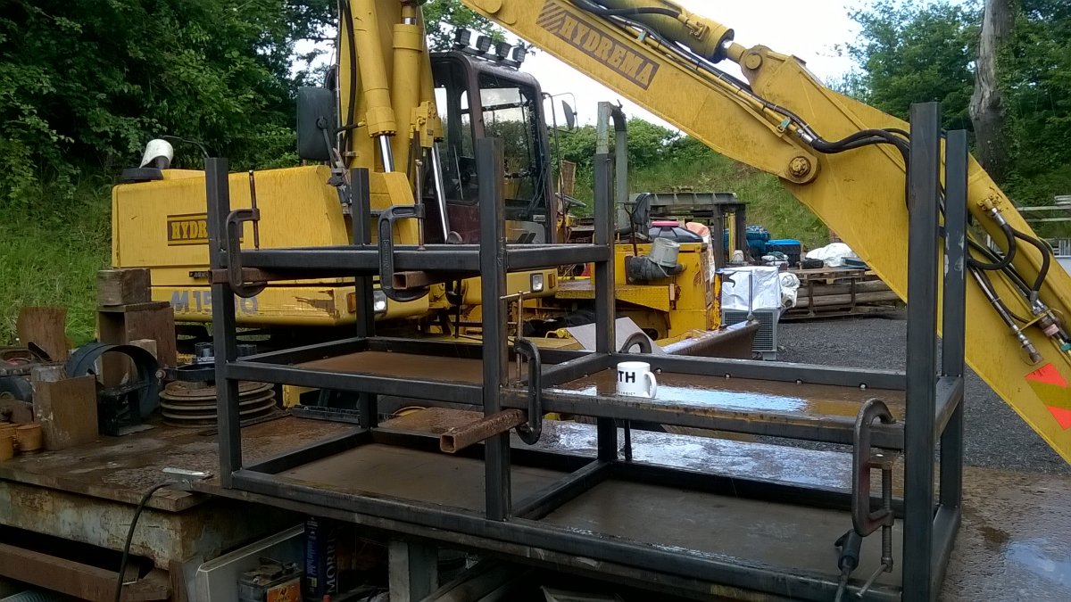

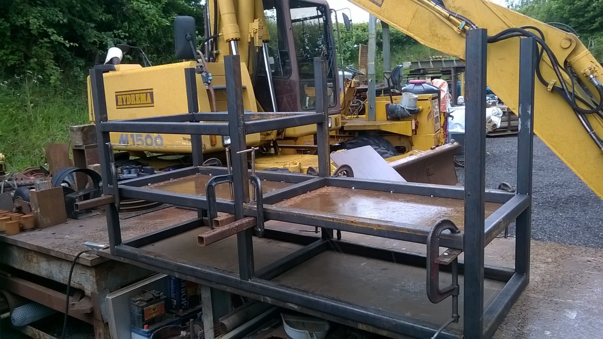

slid the top plate under the frame and tacked
the slid it into the middle of the bench (flattest spot) and clamped down for the installation of yet more bits ....
and secure the top ... got rained on some more, on/off most for the day ...
and having got it all assembled started to weld it up - carefully ... runs length-ways only on them legs ... cross welds'll bend the damned things ... and that'll really knacker a nice square frame ... much as I'd like to fully weld it ... have kept it spot on so far and there's plenty on there to keep it all together and rigid
all welded and clamps off .... zero movement :cool::love:

well all I can say is ****ing weather !! :mad:
View attachment 36393 View attachment 36394

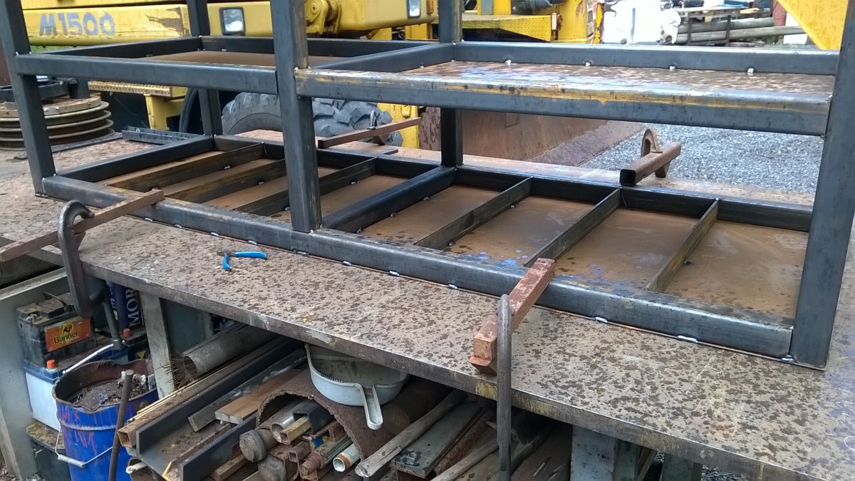

View attachment 36395 View attachment 36396

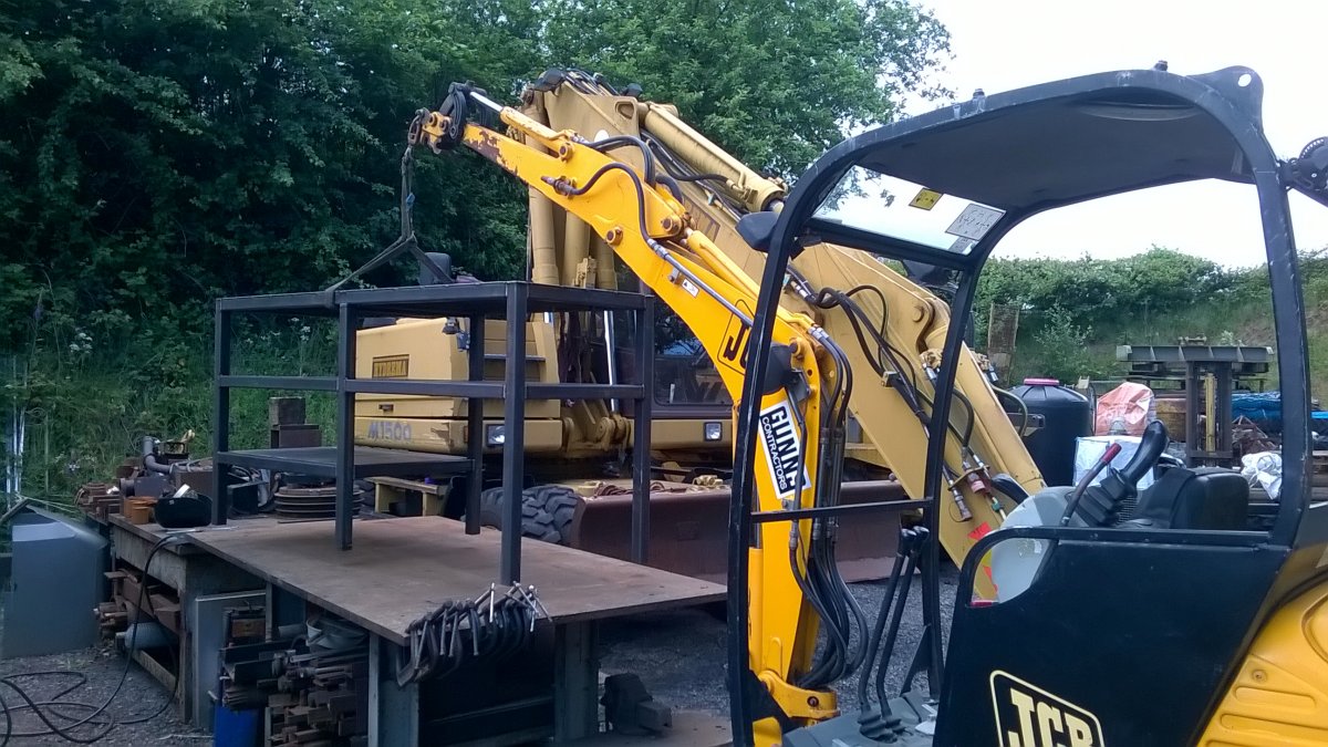

slid the top plate under the frame and tacked View attachment 36398

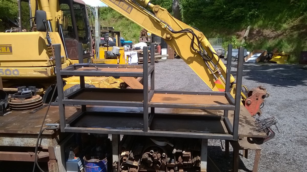

View attachment 36399 View attachment 36401

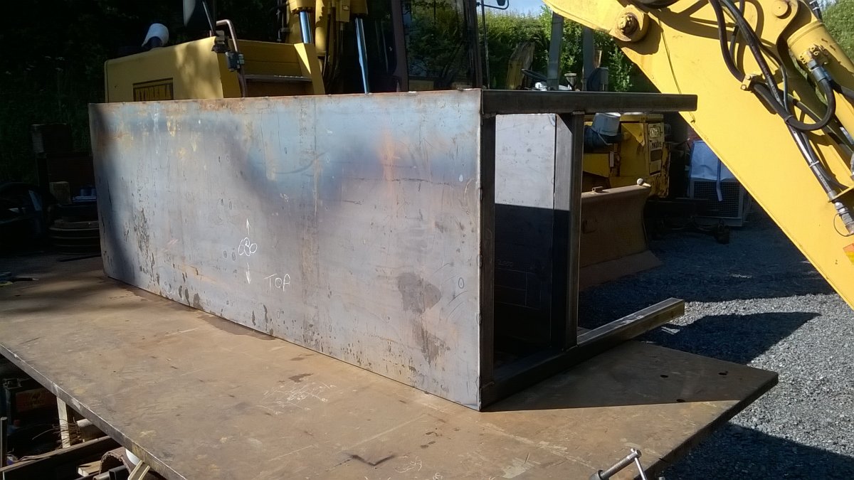

FFS get a shed frustrating though 互 been dry today but came down heavy last night .

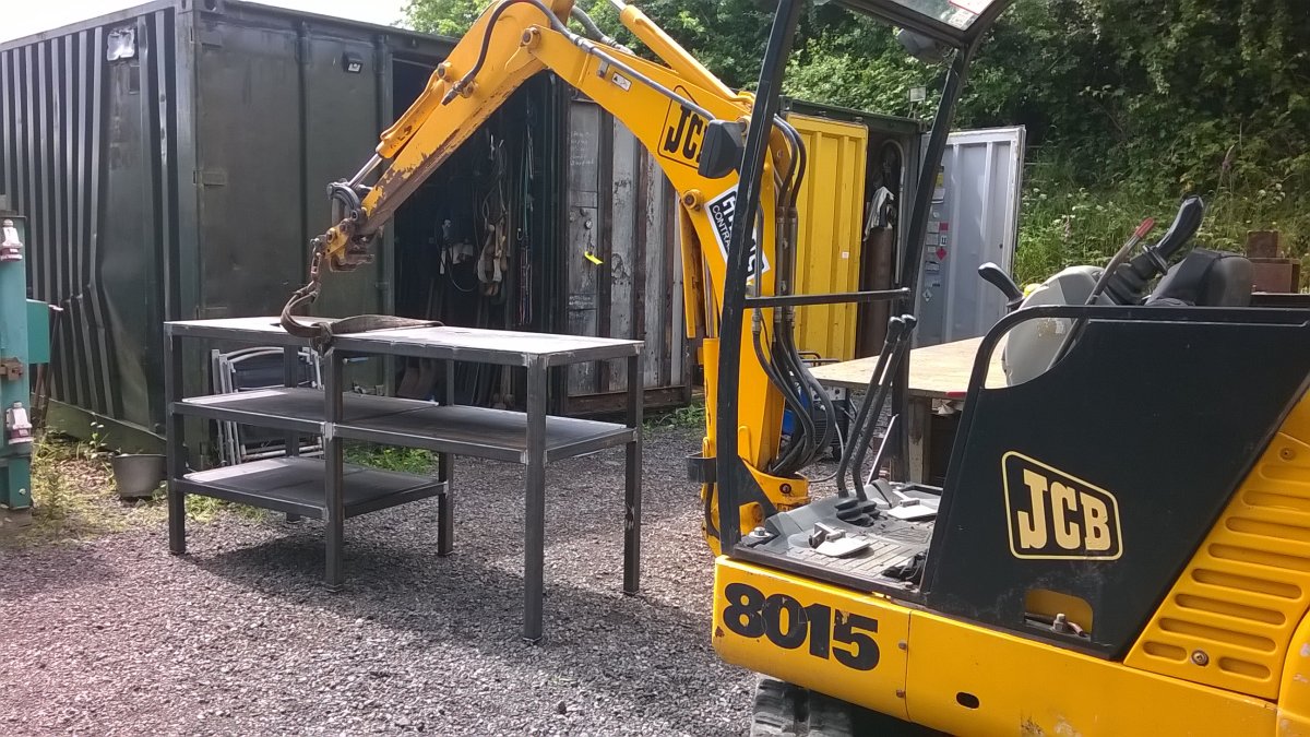

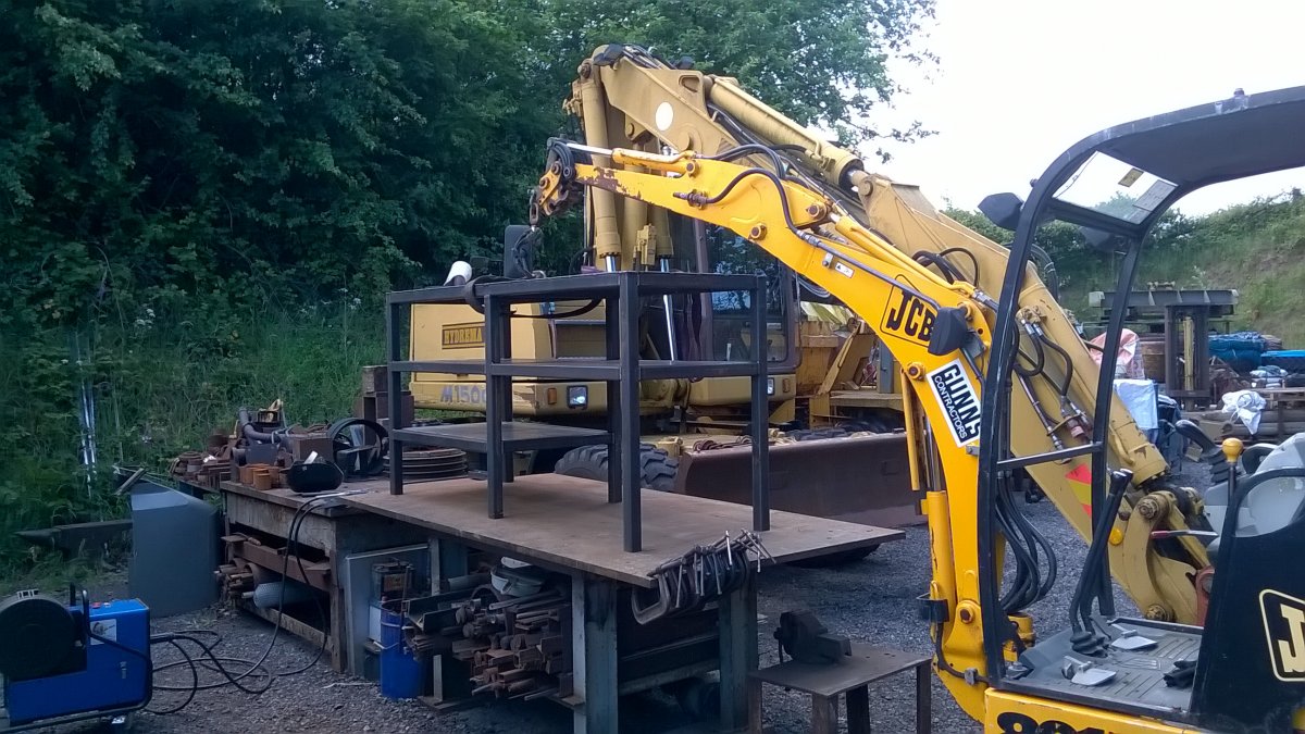

now to turn it ..... :oops:
flipped it on its side ...... just
but was damned if I could get it on its legs ...... so ...
couldn't quite get the height to swing it over so .... plan B centre lift
and sat it on its foot plates .... at which point it started to rain - again .....
..... was game over at 5.30 when the monsoon started .. I got it all away just in time ... and sat there in a box for half an hour waiting for it to ease off enough to lock up and leg it indoors :mad:

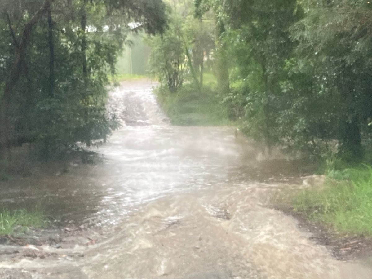

This is the entrance driveway to our property a couple of months ago when we had one of our many, (this year), showers. (About 50mm of rain in 15 minutes)
tha's a lorrarain in 15 minutes Dave :oops: ... I'd not have stayed very dry here yesterday between me bench and the back door .. easier to sit it out ...

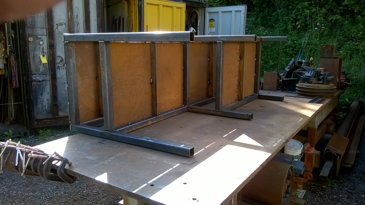

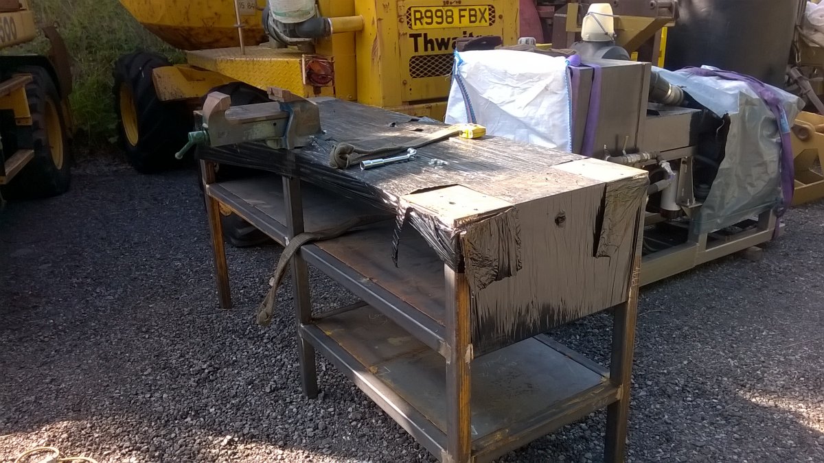

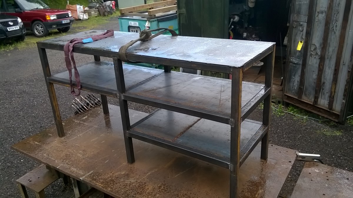

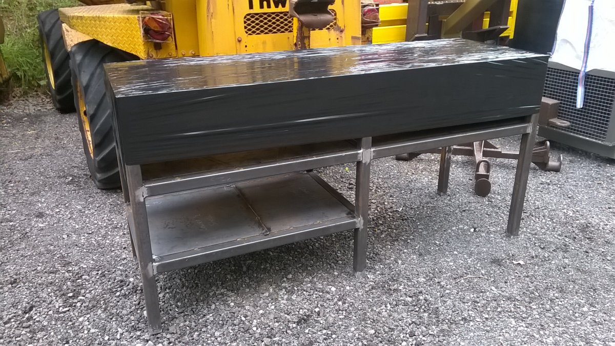

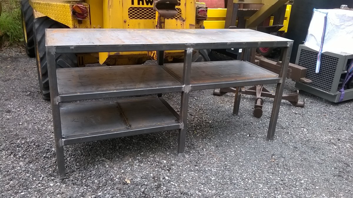

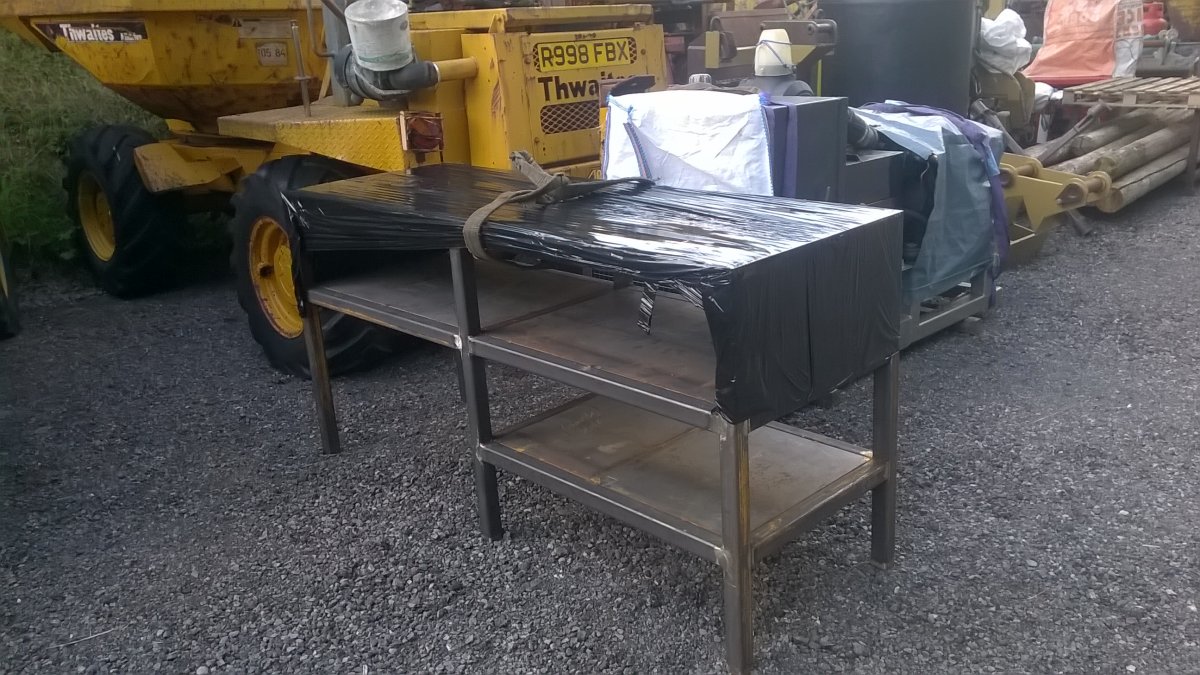

not a lot done today .. rained 'til half two ..... but did get the base feet attached and all fettled up ... with a little help .. again, :rolleyes: rolling it over for easy access with the grinder ..
then he carried it out the way, to await collection/painting
I've kept the one side of the plate clean for him, since it's been here, so in an effort to continue ......
it got wrapped .... could've done with a hand to get round the lower bit, but Pam was out with Clara and her mum at her swimming lesson/club, so'll have to wait 'til the morning.
job done ... BIL's over the moon to have it all completed .... but he's not started painting it all ...... yet

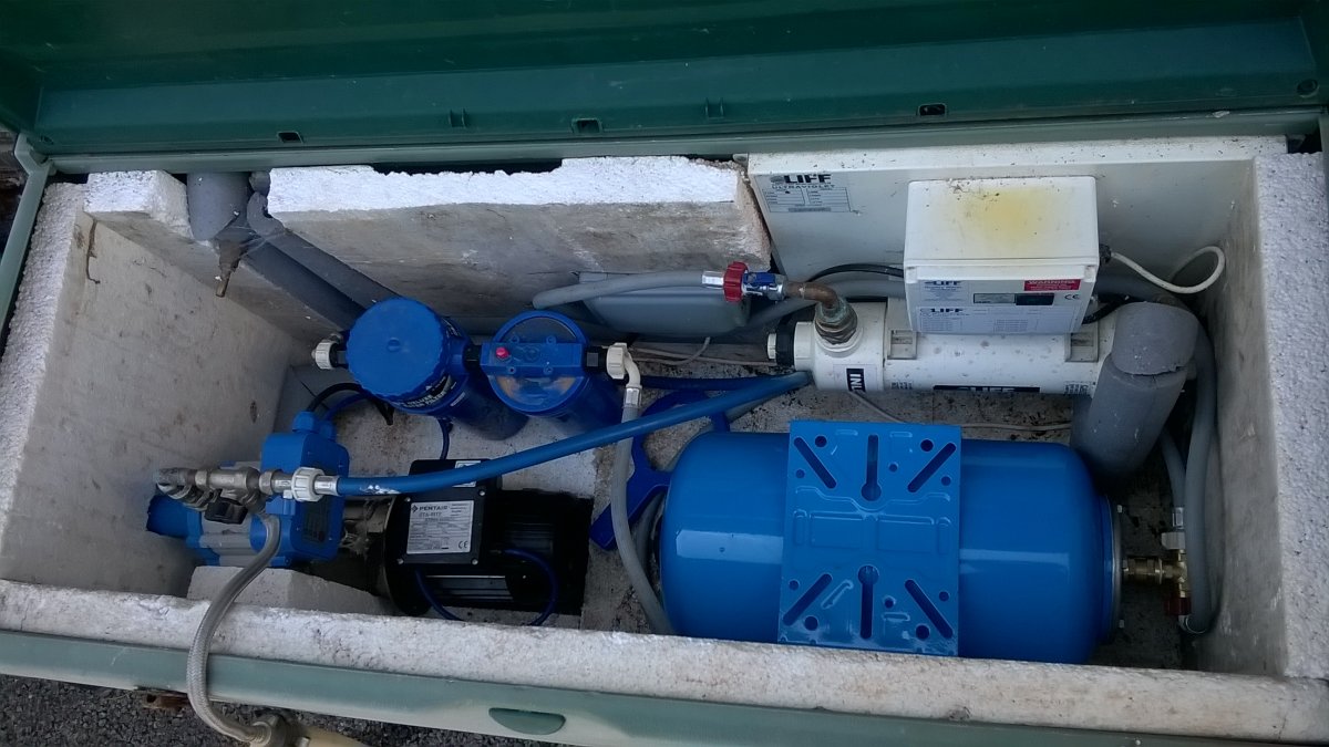

started the day off installing a new pressure vessel in our water pump box ... have had it a while, but have struggled to find some nice brass fittings ... found, ordered and arrived a couple of days ago, so chucked it in this morning ... should reduce the starting frequency of the pump, when Pam casually flicks the taps on/off/on/off/etc. :rolleyes::( ... working well so far (y):)

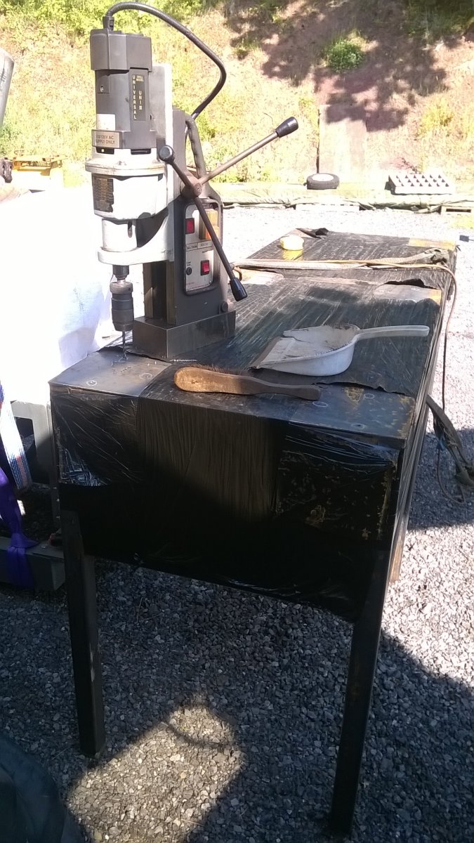

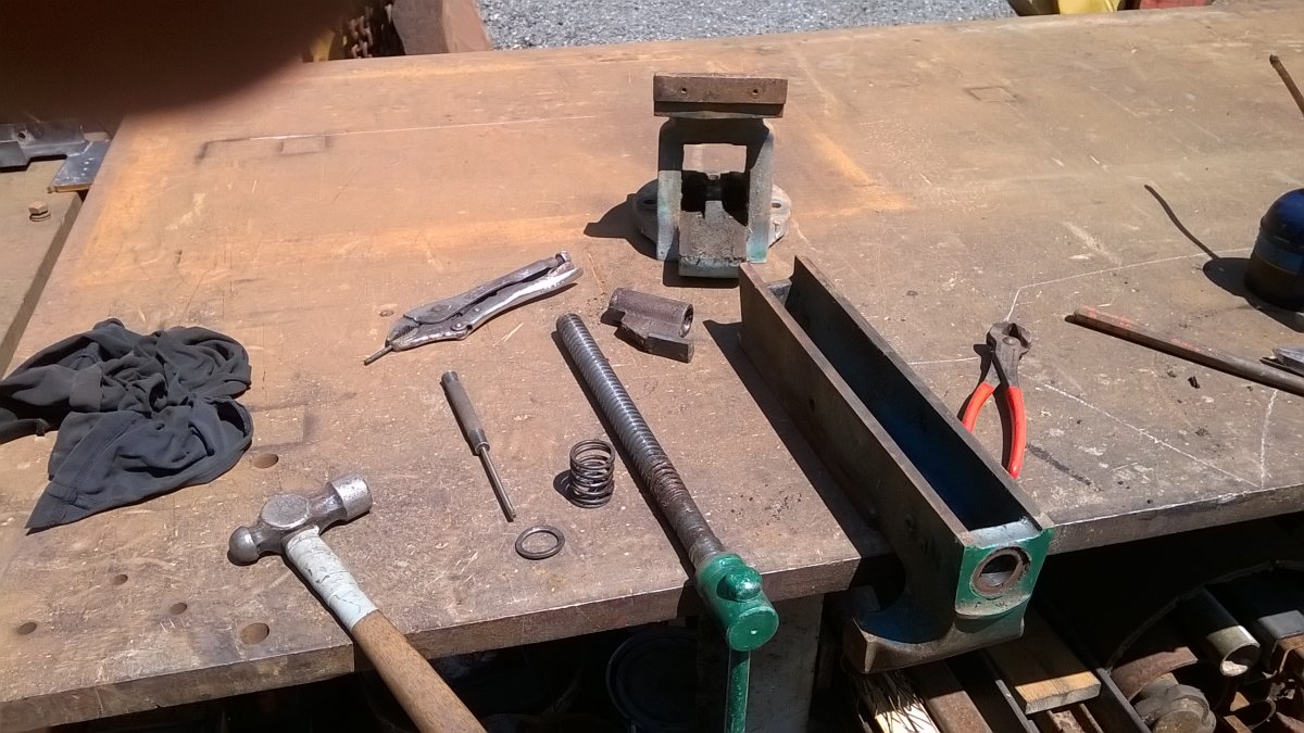

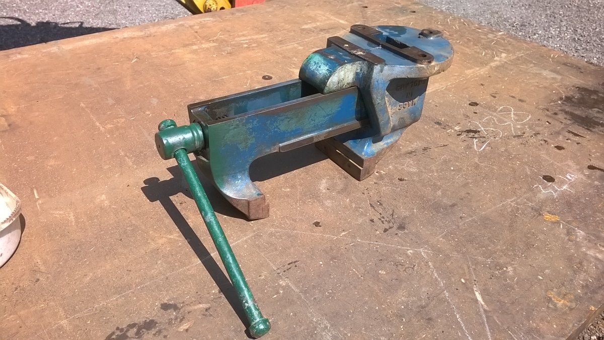

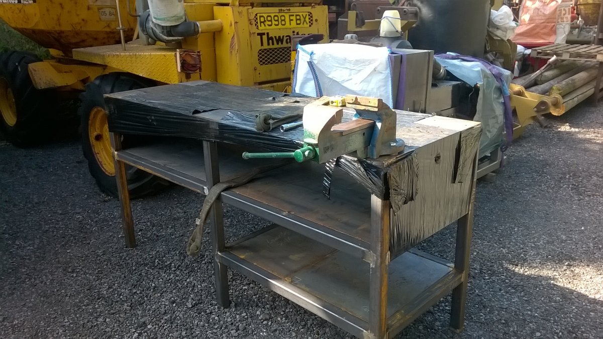

then moved on to drilling the BIL's new bench for his vice ..... couldn't make up his mind where he wanted it or which way round it's going to go, so gave him six options ..... three each side .... but first I reckoned his vice was long over due some TLC ...
so pulled it to bits, got all the crap out of it,
cleaned the ways, lubed and re-assembled it
good as new .......

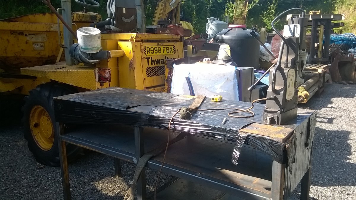

then out with the Mag drill
followed by a trial at each location
etc., etc. .....
all perfect fits .....
and re-wrapped the top as it appears to have stayed pretty dry - considering :rolleyes:

Did you tap the holes Druid? I've been making plates for all my stuff so they bolt through the bench with thumb screws into the plates. Means you can pop the vice or bench grinder or fretsaw wherever you want and secure in place.
only 4mm Alex so not really thick enough .. be fine in 10mm though .... have picked up on the box frame where I can too
Cyberprog
Cyberprog
Put 10mm under the drill (bolt it to a plate) then bolt through the 4mm into the 10mm.
there's now't going on it that's gonna get moved about much .. doubt the vice'll get moved very often TBH, but gave him all the options whilst it's here and holing is easy(er) .... 's only a 'general' bench :rolleyes:;)
