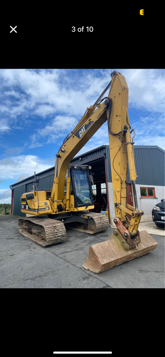

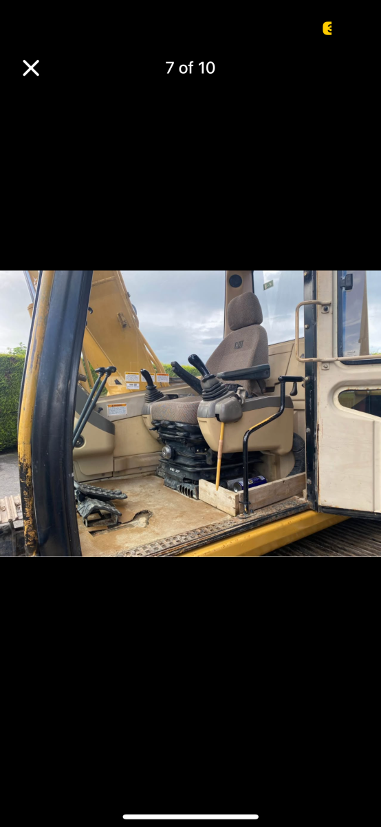

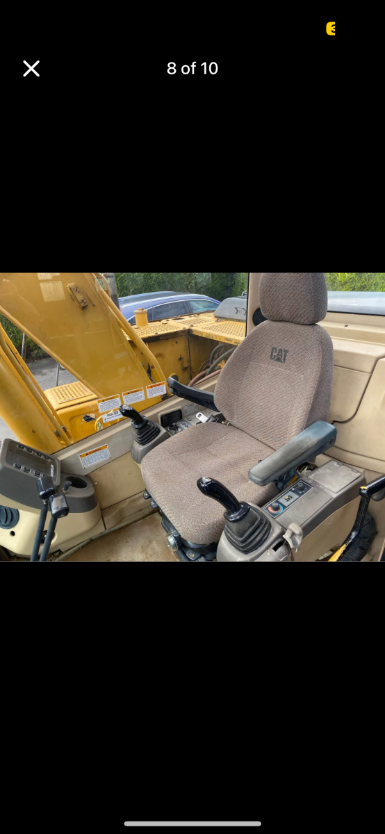

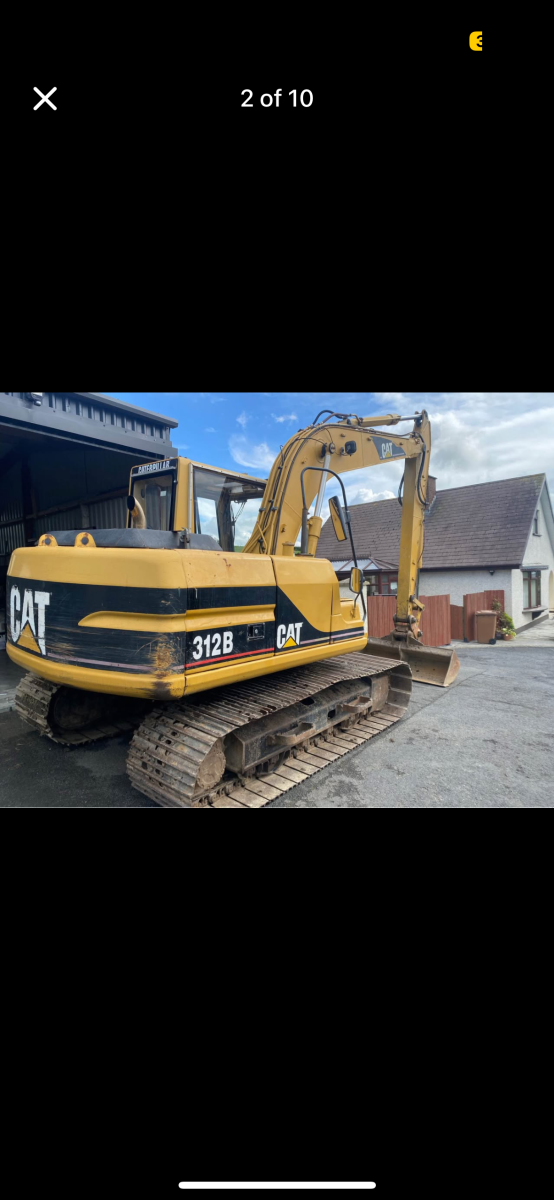

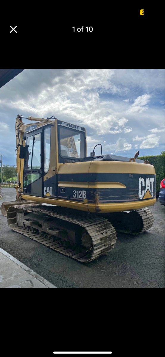

Looking to add a second 13t machine to the fleet, won’t be a full on front line machine, maybe do 2-500 hours a year, had set myself a budget of no more than £25k, maybe £30k at a push. That seemed to be getting a machine around 10-15 years old with anywhere from 8000 hours to 14000 hours.
Then I came across this, a Cat 312B with 6920 hours. Seems to be a very original genuine machine. Question is, is it too old for a contractor and more suited to a farmer/self build or does it still have a place as a simple, back up machine?

View attachment 75108View attachment 75109View attachment 75110View attachment 75111View attachment 75112
These were a good machine. Operated a few. You can get anything for them and the parts aren’t out of the way expensive. Main thing for me, run it, preferably dig with it, check for leaks from the engine, pump, valve block etc. re hoses, the ones round the boom foot and the boom/stick pivot are the ones most likely to go, but check everything for cracks down to the reinforcement. Also check the slew ring.
If that machine went for export it would run another 20 years.
The reality is, hoses can be replaced.... Seals don't tend to go wrong if the machine isn't abused and hasn't just been parked forever.
Best advice is buy it, replace all the hoses that are out in the sun, and the Undercarriage hoses that will be a pita on site. Let's face it hoses are a lot cheaper than electrics and it would appear even a new machine can have the reliability of a 17 year old media student.
