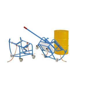

If you don't like pumping out of barrel firm I use to work for had drum stands with taps on he built a shed on side of workshop with all oils and big tank for waste oilView attachment 51723
got a few much simpler ones ... easy way to handle drums and dispense from them ... also bought this from round the corner from @bobthebuilder (didn't know at the time) .. great way of putting 'em where you want them
