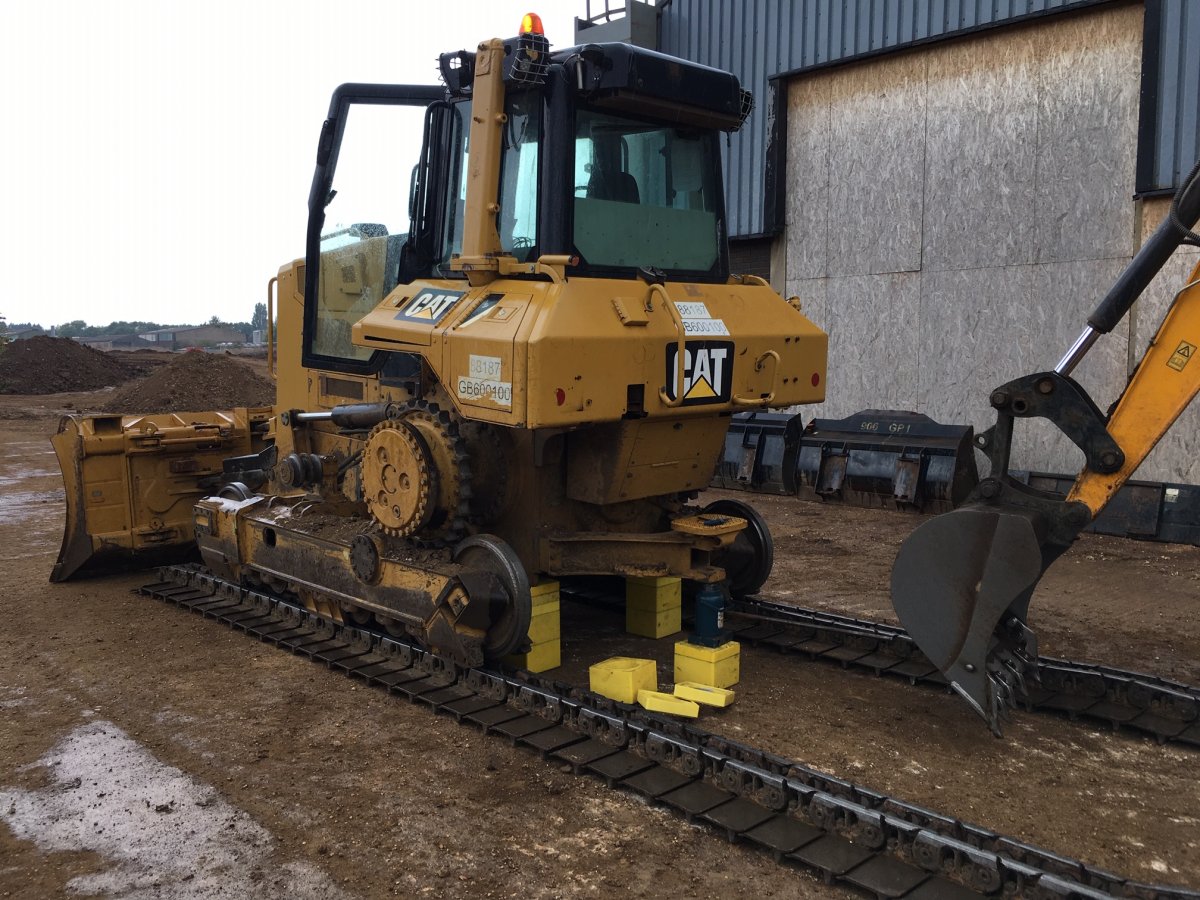

Less happy times. Had 3 box links inserted as the originals had failed. Anyone who’s had anything to do with Cat S1 will understand the pain.View attachment 11157
People get it a bad name, I’ve just retracked two of our d6n’s that we’ve had since new 13,000 hours and 12,500 hours and both had original idlers, sprockets, bottoms rollers and pads. They both had a set of chains at 6500 and 7000 hours. For us it works great the conventional undercarriage would never last the same amount of hours.
How well you get on with S1 depends on the application, Mark. Are your machines mainly spreading or on landfill? Those are the applications where you get the best out of S1. On the N in the pictures the rest of the components were okay, apart from a bit of rounding on the rollers from doing a lot of battering.
We’ve also run two K’s which are about four tonnes lighter. One was on wide tracks and the Tracks were had it at under 4000 hrs, the other on narrow tracks and everything good at over 6000 hrs.

Our tractors are normally running through wet muck, occasionally on stone or rock but not very often. We had a D6k undercarriage lasted 3,500 hours only thing that was re useable was the idlers.
Was the K on S1? In my experience S1 doesn’t like sand, or wide shoes, wet mud hasn’t caused us any issues.

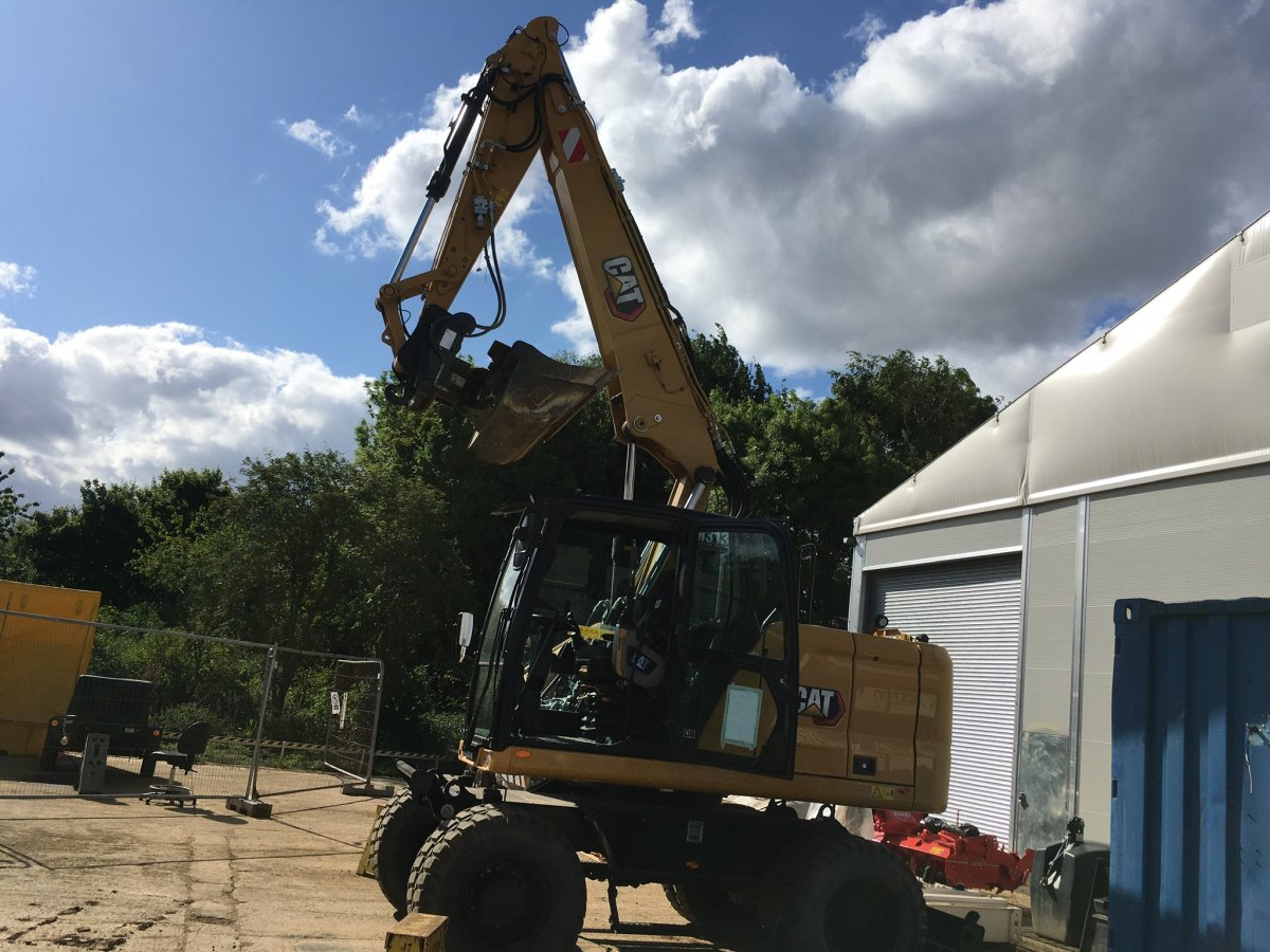

Doing some work on a M317 at the moment, well, in the New Year. As you said, Mark, very impressive, apart from the two monitor screens getting in your eyeline at times. Same footprint as the M313.
What is the second monitor for? Can’t remember seeing one on the machine I had a look around. We have two on the 323 but the second is for trimble earthworks.

Same. One for machine systems, one for Accugrade. Like an oversized iPad
