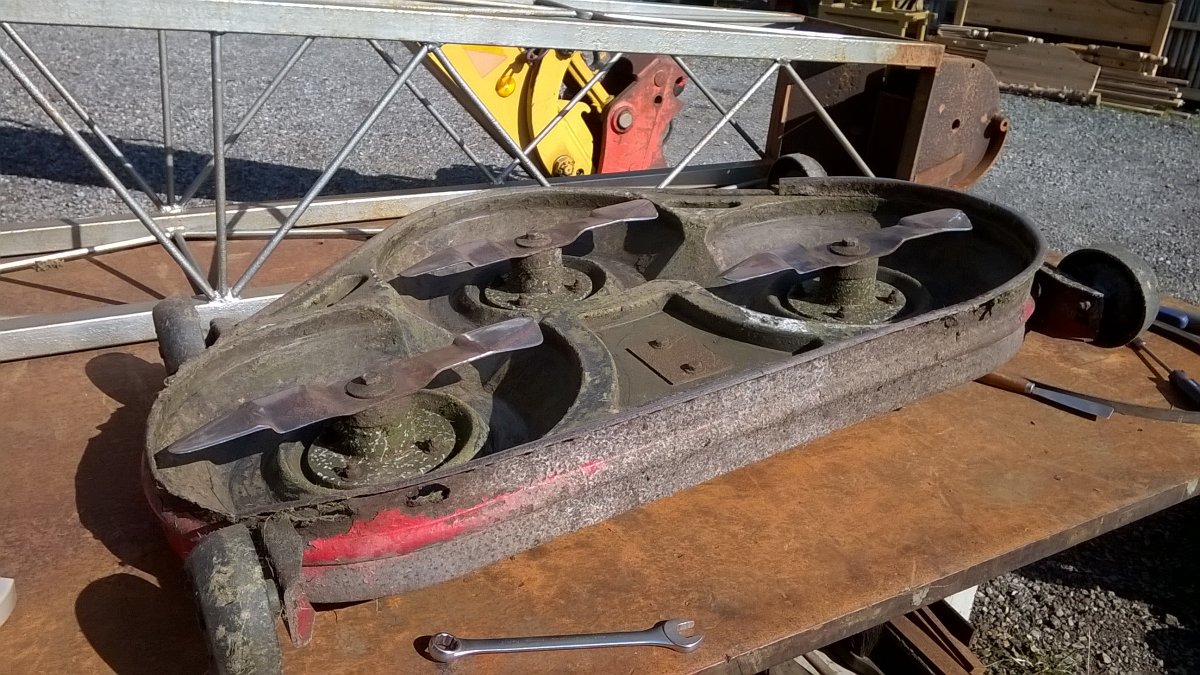

A further question regarding this mower, can you get a mulching attachment.
I would rather mulch the field instead of collecting the grass.
the mulching set up is a plastic insert in the deck which doesn't allow the grass to escape until totally massacred ... TBH not a lot of cop unless you cut it two or three times a week .. even weekly you still need a collector behind you picking it up
Yeah my sweeper is bolloxed and I blocked back up with a bit of ally and put mulching blades on, it's crap, going to get gardeners to do it rather than splash out another 5k on a mower !
