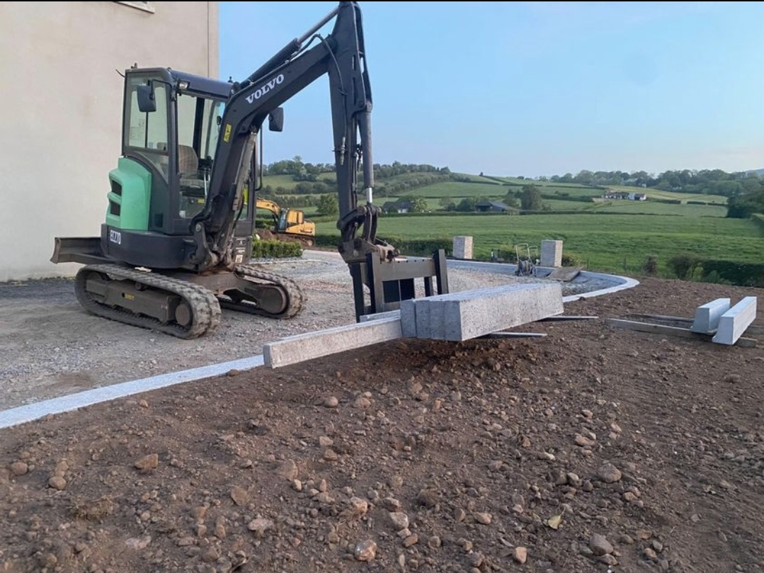

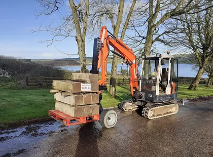

dare say it'd not be a difficult thing to fab up ... first step'd be finding some suitably light duty forks and work forward from there, but you're still not gonna get a great capacity with the blade - (a) it's the 'wrong' side of the piston and (b) 's gonna be mighty 'tippy'

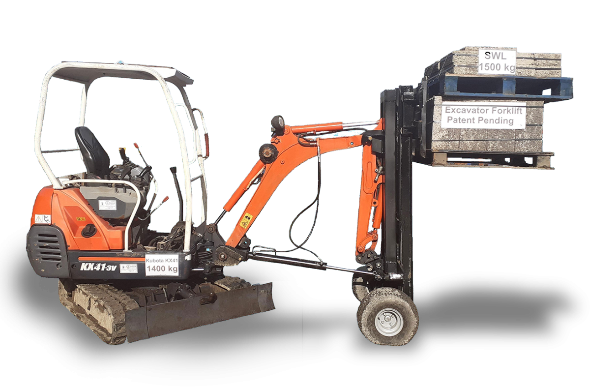

these were discussed on CEF and I think possibly on here ..... https://www.excavatorforklift.com/ .... https://www.excavatorforklift.com/excavator ... https://www.excavatorforklift.com/media
dare say something less grandiose could be created if you didn't want to be unloading trucks, but simply shifting pallets about at a much lower level :unsure:

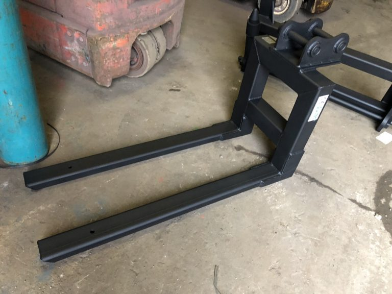

About £550 this side of the pond. Not alot on it though and without the weight of a tilty too. Potentially slightly more if turned around towards digger and resting on the blade.
