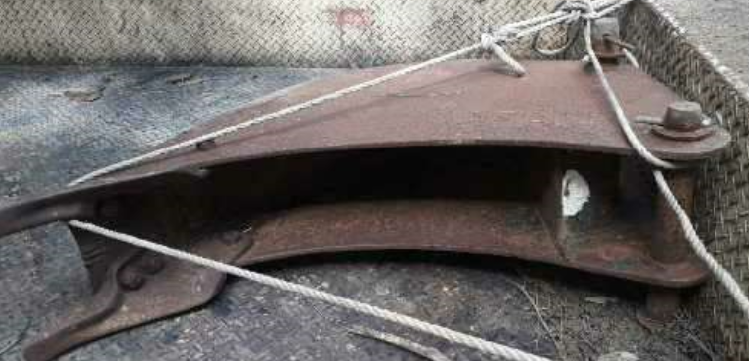

I think your supposed to weld it from the bottom of the bucket to the top of the bucket internally

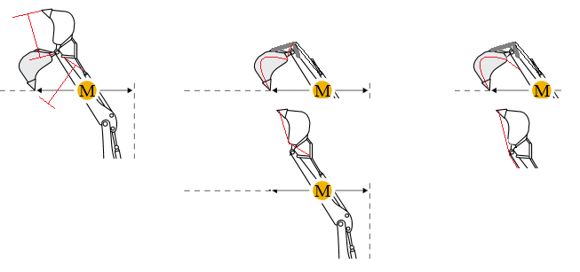

The distance from the top of the bucket to the tip will never change (regardless of bucket rotation),so you need to find a point where there is significant change of length.
The Patent drawing shows the chain going somewhere near the rod end. This'd probably work, but you'd need a guide to keep the chain from binding between the dipper and hitch / bucket..
My crappy drawing suggests there isn't a significant change of length going up the dipper

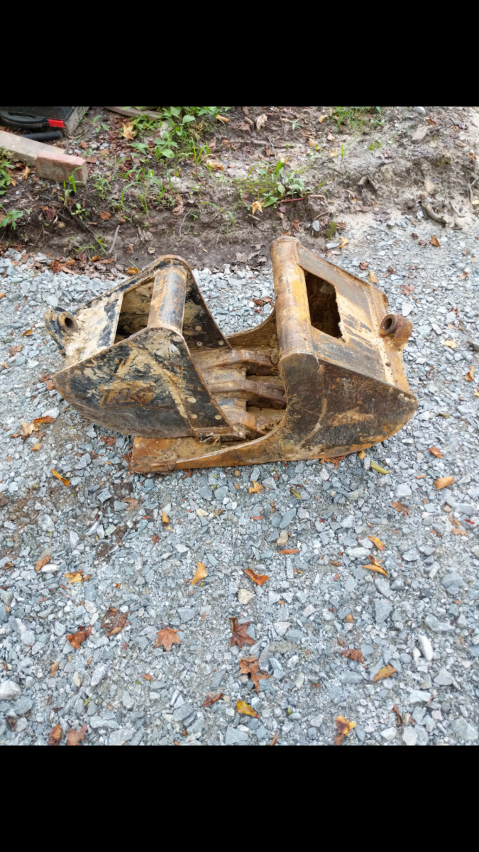

We have a few buckets that size and maybe smaller for a 3cx where the pins are wider than the bucket is yours the same ?

No A bit, mine is slab sided - at least it won't limit how deep I can go.

Had plenty of success doing it with chain weldeld just back from cutting edge and fix to dipper so chain is tight when bucket is fully open

Surely all of this would depend on the geometry of the bucket and quick hitch
The further the bucket extends infront of the the support pin the better this will work

pins and bosses are wider :unsure:
Ok, fair call. I was thinking of the whole mount being wider than the buckets cutting edges
Definitely. If you added an extension to a 'normal' bucket, it'd make a lot of difference.
