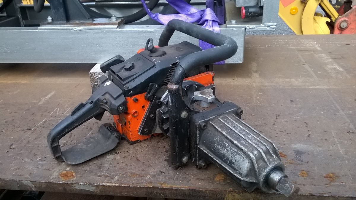

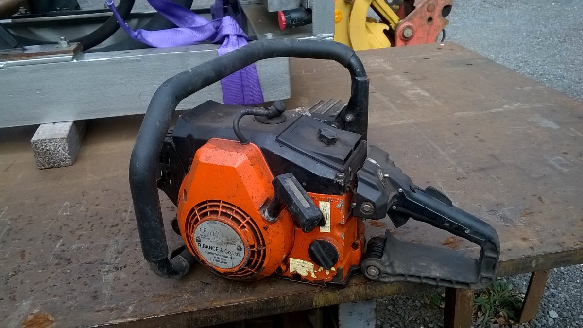

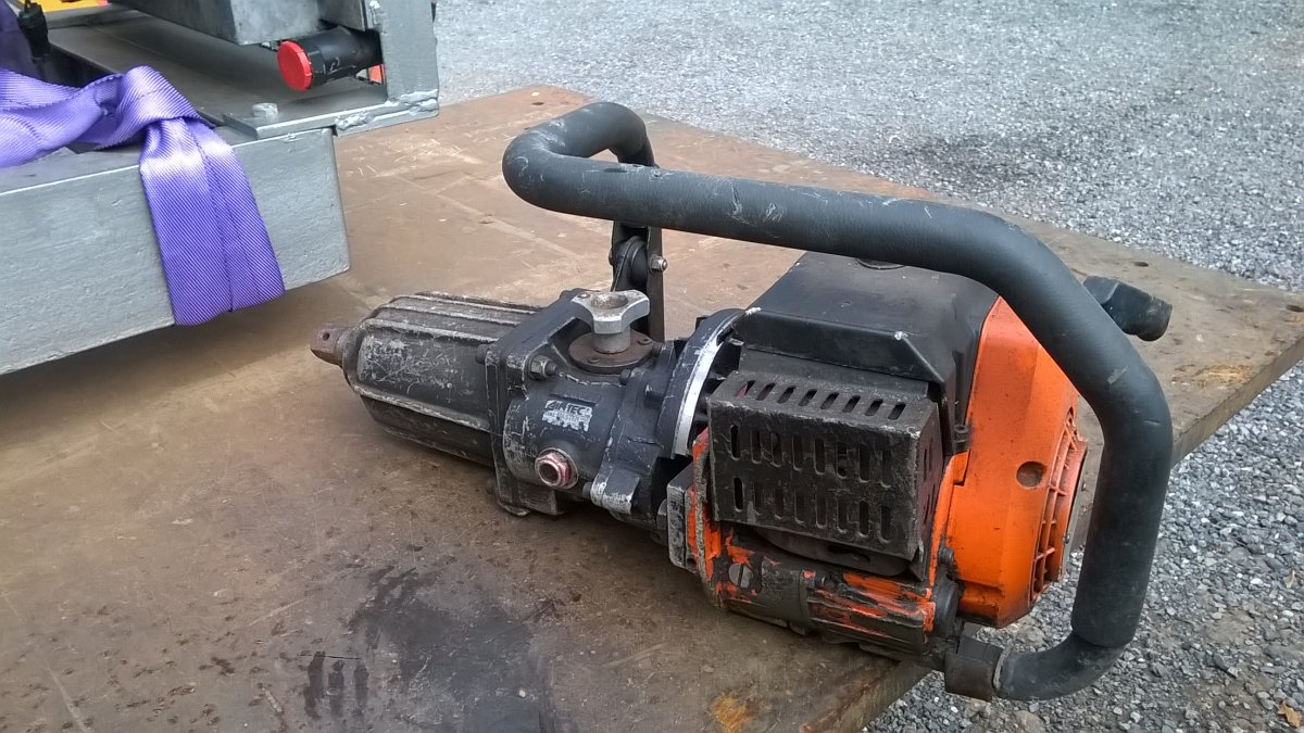

pic of the whole thing'd be useful
I swapped @Mogman mine for his winch -- hadn't run it in a long time, but had used it in the past .. dare say Mog'll have had it running by now
WP_20220918_16_48_00_Pro.jpg WP_20220918_16_48_12_Pro.jpg WP_20220918_16_47_54_Pro.jpg

View attachment 75000 View attachment 74999 View attachment 75001
Totally missed this request.
Hopefully this short video will show you.

sorry missed your request for a better pic, I’ve taken a walk around video for you 🙈😂
And trying to sort bits out for these is a bloody nightmare unless you’re a major company or you send it off for them to price the repairs for you.
Anyway hopefully the clip will load.
