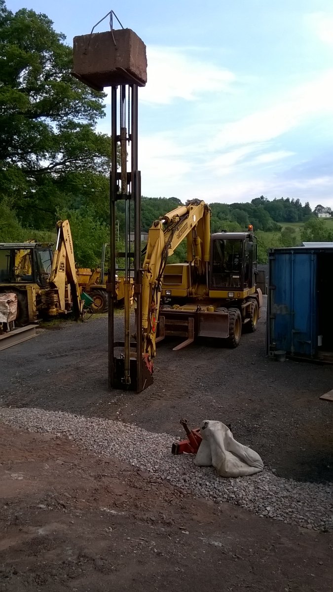

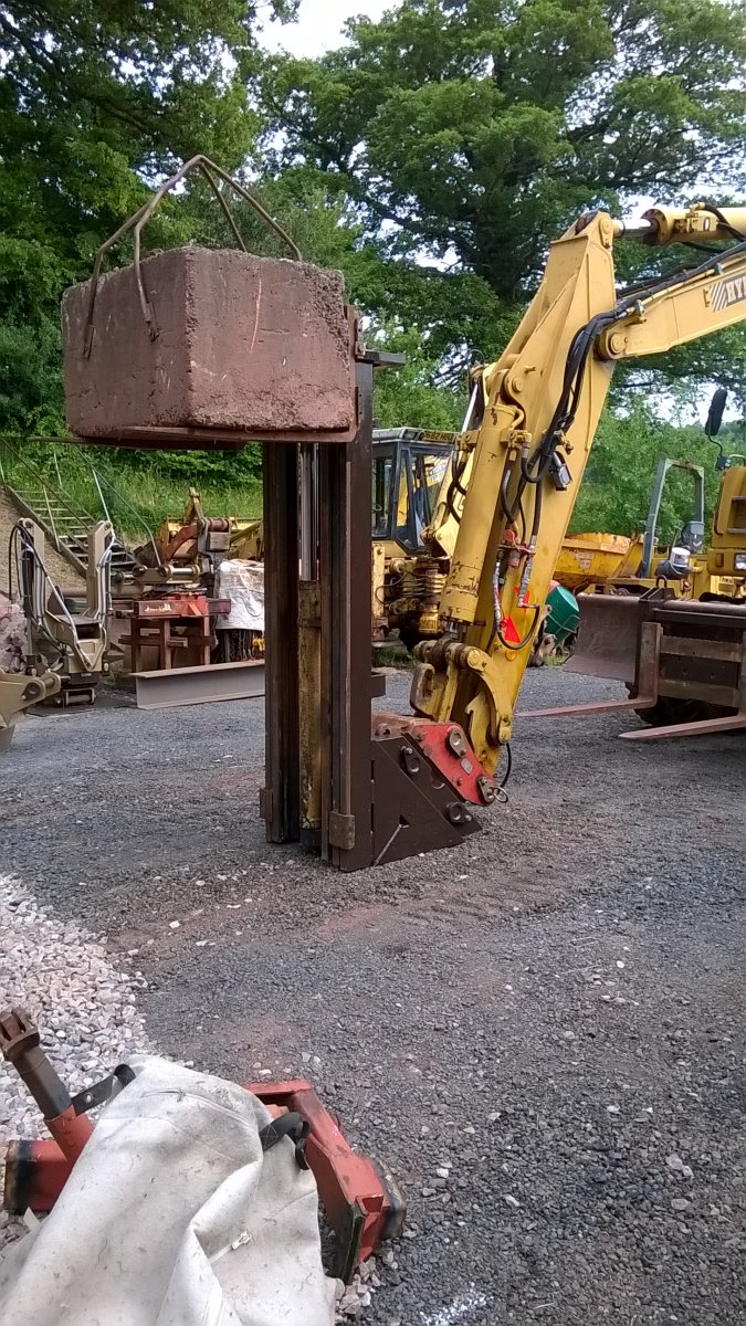

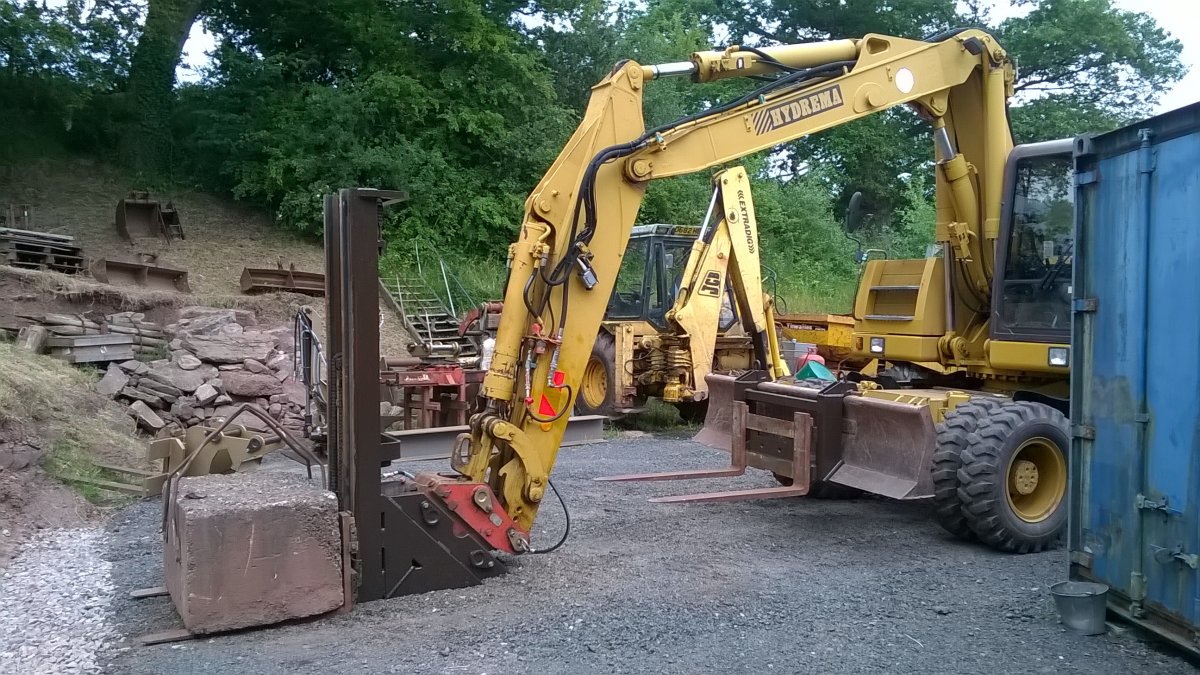

Had to do it with the mast I modded for me hitch .... hadn't been used in quite some time and was well tight

or a n other FLT or a telehandler and drop some on ....... I was expecting mine to be tight, so it got the treatment first ;) (y)
