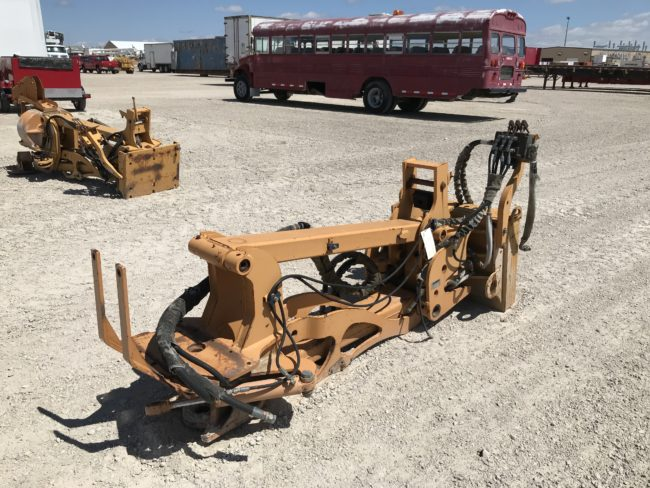

I've got a customer with a Case P95 vibratory plow that he bought from auction and now wants fitted to a grey market tracked vehicle ("It should just bolt on....").
Has anyone experience of these, specifically the hydraulic flow rates etc for the vibro set-up? Any advice much appreciated (still waiting for local Case dealer to return my call!).

Exactly! From the only info I've found online it runs a flow rate of 130 litres / min. , so think his machine will either track or vibrate, just not both at the same time.

as Aiden says .... I'd have thought it's going to need its very own pump, tank and cooler and a fair size at that .... My 'Drema flows 230l/m, flat out with a BIG VD pump :rolleyes::oops:
Surely it would depend on the base vehicle
As to whether it's hydro drive or dozer style with clutch packs.
And if it is hydro whether it runs seperat3 pumps for tracks and auxiliary.
Also whilst it's going to require a lot of flow I can't see it taking a huge amount of power to run the vibrator it's only a swinging weight it's not actually moving soil it'self it's only to reduce friction between soil particles.
But if it does need extra oil supply then there are plenty of pumps on the market that sit directly on the pto shaft with a chain to a link arm to stop them spinning

PTO direct into a suitable Hydraulic Pump, Direct into the Plough unit. Return via a Hydraulic cooler and a Decent sized tank. This will transmit near on full HP of the tractor if needed as the PTO's on the Grey Market Crawlers (Usually Mooroka derived) tends to be Direct shaft drive.
f****ng around with anything extra is a direct and unnecessary route to heartache.
