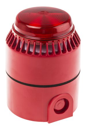

R S do most of what you would transformer all so beacons with klaxon as one unit i think this is ip66 so can be fitted on top of you enclosure all you need extra to that would be a simple roller ball float switch.

this is the type of thing i was thinking of
https://uk.rs-online.com/web/p/beacon-sounder-combinations/5294474/
That has potential - needs to be a stand alone setup power wise though, something similar that has a battery compartment that could be wired to a float switch.
