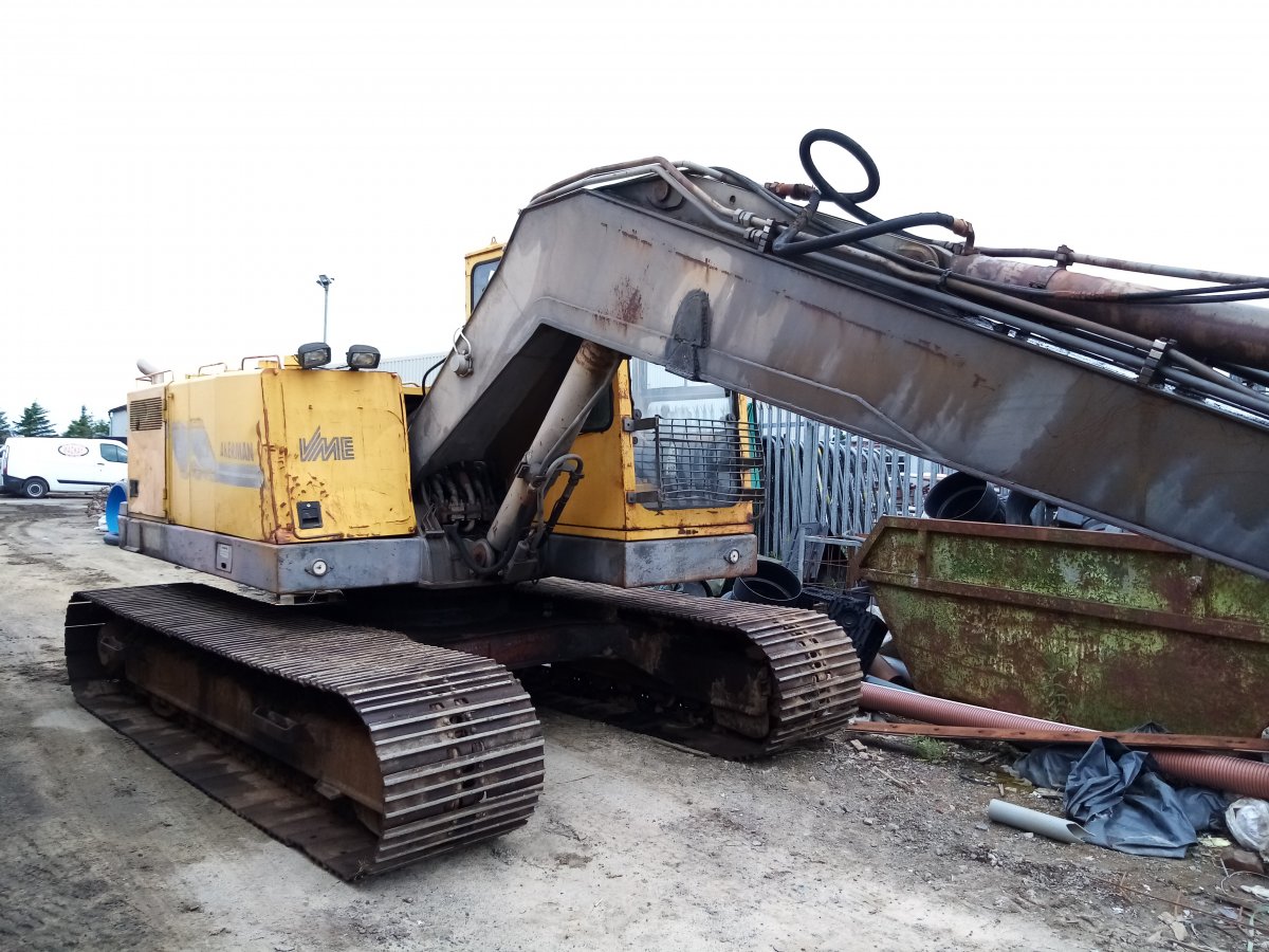

Anybody know of parts lying about for old akermann 20tonner,was bought to go on crusher bucket but main boom ram leaking badly, not worth repairing so looking for a decent second hand one. Thanks

aye Maskinisten's your best bet for info. on the Akermans ... they love 'em in Sweden

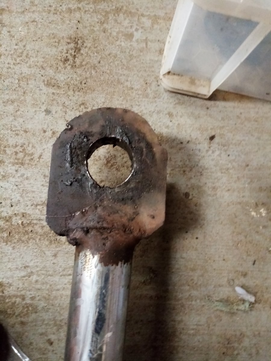

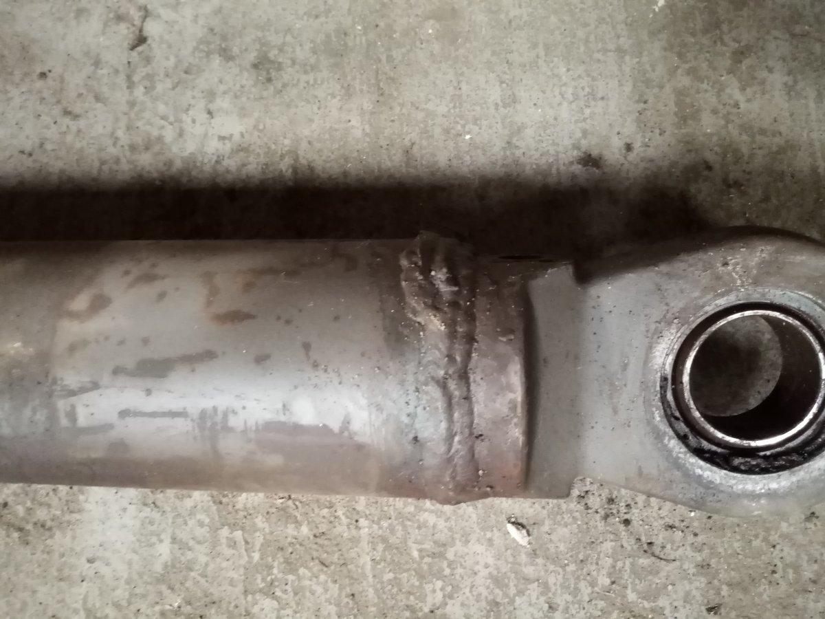

Rod is damaged, end on it is home made, bottom of ram had loads of welding done to it, not a healthy looking ram, you may know machine as came from the central belt somewhere was sold by a cameron Donald

not what you'd call a major job ..... :rolleyes: new rod end ...... grind out and reweld the cylinder .... seal set .... certainly not a right off cost

No hasn't found one yet, he has tried a few places but no luck, the rod is damaged as well as the end, bottom end is full of bad welds, also a crack where check valve flange is on ram,
